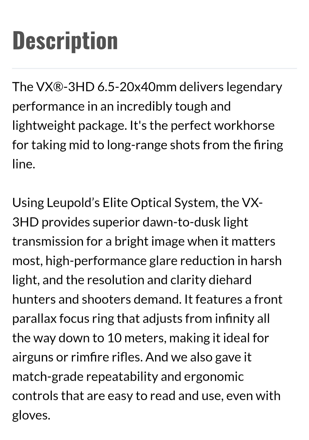

I can see where op could've been sold in the scope in the description where they directly mention airgun use. With that optic's msrp I might buy some eagle rings tonight, or search for potential install errors that could've lead to this.

They directly marketed towards airguns too unfortunately. I've had weaver mounting issues cause problems before where I overlooked an incomplete seating or locating block got caught up (3 rails look the same but aren't technically the same picatinny/weaver/nato).

I've been shooting since about the year 2k and this is the first time I've encountered this particular problem. You are mostly correct, I bought the scope because I wanted to be able to focus to 10yds, and I wanted Leupold glass. The reticle I actually wanted was the Boone and Crocket, but Leupold's with that reticle only have parallax correction down to 50yds. So I decided to give this model a try. I never saw this problem coming. BTW-the glass on this scope is far better than my Meopta Optika 5(I've never used any of the higher priced Meoptas so I still wonder if they use better glass on their higher end models), but the reticle on the Meopta is just right for my shooting needs.
