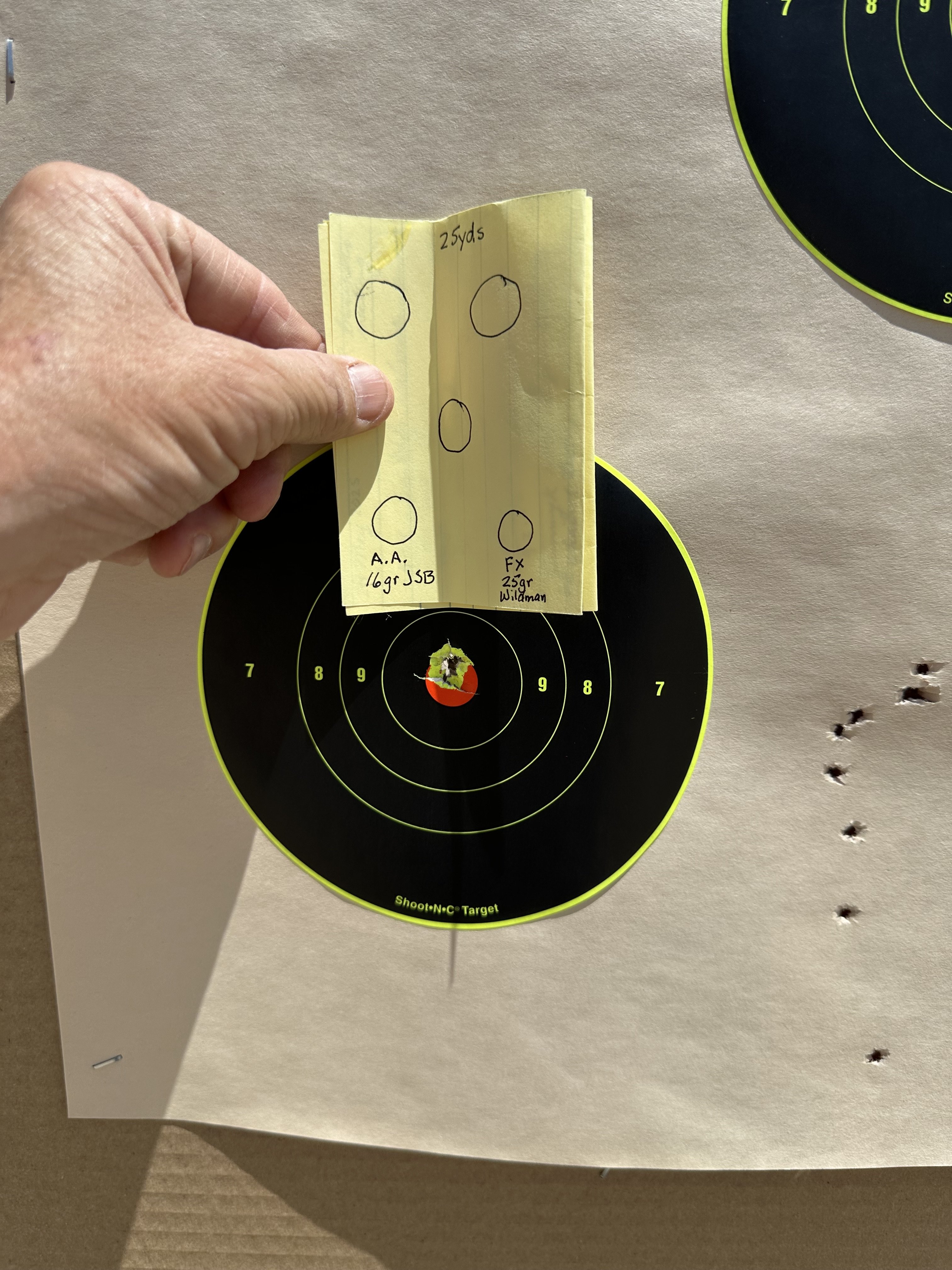

VX-3HD 6.5-20x40 on my new FX-King was a good 3” high even with the elevation adjustment down as far as it would go. So I switched it with the Meopta that was on my Air Arms S410. I took the AA to the range today to see if it too had the same problem using that Leupold scope. It worked just fine…I had to crank it back up to zero it at 25yds, and there was plenty of room both up and down after zeroing. The FX uses high rings on a picatinny, whereas the AA has medium high rings on an 11mm mount. Any ideas what’s going on here? All input is welcome. The attached pic is from the Air Arms/Leupold using 16gr JSB’s at 25yds.
Height over bore, plus the smaller range of elevation movement means you simply maxed out your scope? The Lupy only has about 45moa of total adjustment? where many modern scopes have double or triple that. The Lupy is a target scope not a tactical knob twister so you will have to set it up as close to mechanical errector center as possible. This means you will need a set of adjustable rings most likely, since you will not be able to fit a canted one piece mount on the King.

If I'm reading this correctly, for your testing, you switched to a different gun (AA) to test the new scope (Leupold), not a different scope (Meopta) on the same gun (FX). What you should have done was put the Meopta on the FX to see if the same zeroing issue exists. I believe the FX has built in MOA cant on the rail, thus reducing the amount of elevation you have for short distance. I believe that is your issue. My apologies if I'm wrong.

The King has 30moa built into the rail.
Ok this explains what I was missing in the equation. He has too much elevation built in the action to shoot "close" distances with a small elevation adjustable scope. Normally the issue is the opposite direction which was confusing my limited brain power. lol

Think of the pellet path as a rainbow and the scope looks thru a particular section of that arcing trajectory. You can change the incline of the scope to I intersect the parts of the arc that you find optimal.
I wouldn't get a mount, it's just going to jack it up higher. Adjustable rings would give him plenty of options and still be able to use the 30moa that's built in if needed.
