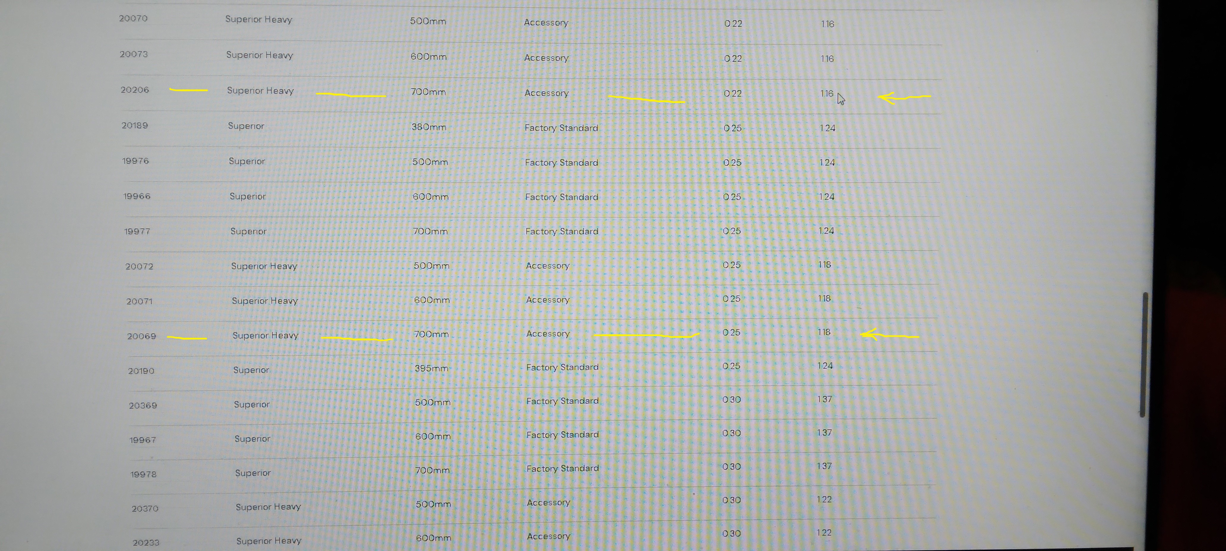

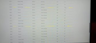

Have been looking at getting the STX heavy liner for use with heavier slugs 23 gr or greater and try to get back out to 100 yards again. I am set up and am shooting 22 caliber, and see that my search only finds the heavy liner in 20230825_140143 - Copy.jpg1:16 twist for 22 caliber. The 1:18 twist is in 25 caliber.
So my guess is the 1:16 is what I will be ordering.20230826_192237.jpgStanding 3 shot 50 yd JSB pellet 980 fps 140 bar picture.

Have been looking at getting the STX heavy liner for use with heavier slugs 23 gr or greater and try to get back out to 100 yards again. I am set up and am shooting 22 caliber, and see that my search only finds the heavy liner in View attachment 3841611:16 twist for 22 caliber. The 1:18 twist is in 25 caliber.
So my guess is the 1:16 is what I will be ordering.View attachment 384162Standing 3 shot 50 yd JSB pellet 980 fps 140 bar picture.
Hi, I sent a text to my friend who owns the 1:18 22cal liner. He purchased his at Utah Airguns, but it was included in a 700mm Impact, tension barrel system. I also emailed FX customer service about 1:18 22cal liner. I will let you know what FX customer service has to say.
Thank you for helping, much appreciated! R
Also found this interesting.https://www.airgunnation.com/threads/fx-super-superior-heavy-slug-liner.1272194/
Hi, FX replied you have to purchase liners from a dealer. My friend dies have a 1:16 liner, he hasn't had the time to test yet. I'll let you how it performs in his Impact.
