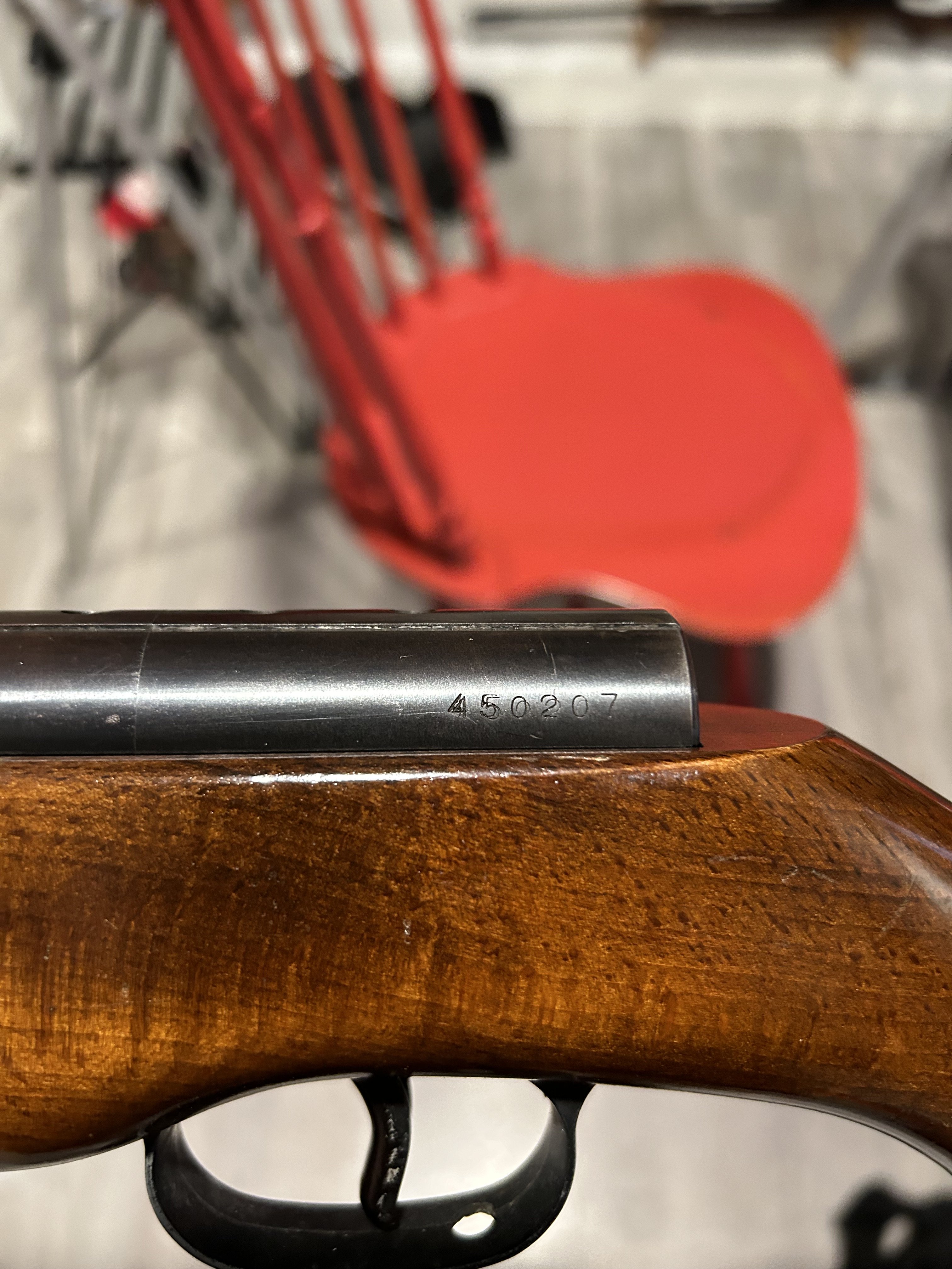

The HW 50's serial number dates from 1972 or '73. As C-i-O noted, the OEM piston seal was undoubtedly leather (the big HW 35 switched to synthetic piston seals around 1980, and the smaller models after that). The gun also probably has a 4mm transfer port, in recent years guns with plastic piston seals have gone to around 3mm.
The HW 50 was Weihrauch's first post-war airgun, made from around 1951 to almost 2000. It is unique in having the company's smaller receiver tube (30mm O.D., 25mm I.D.), with a threaded-on rear section, same as the big-tube HW 35, 77, 80, etc. It's a very fine intermediate-power rifle - think of if as what an HW 30 wants to be when it grows up, ha...

Thanks, you made my day. Here’s the serial no.View attachment 447013Where would I get a Ricord trigger assembly?
Would this have a leather piston seal?
Would Vortek have both seals or Chambers in UK? Crow

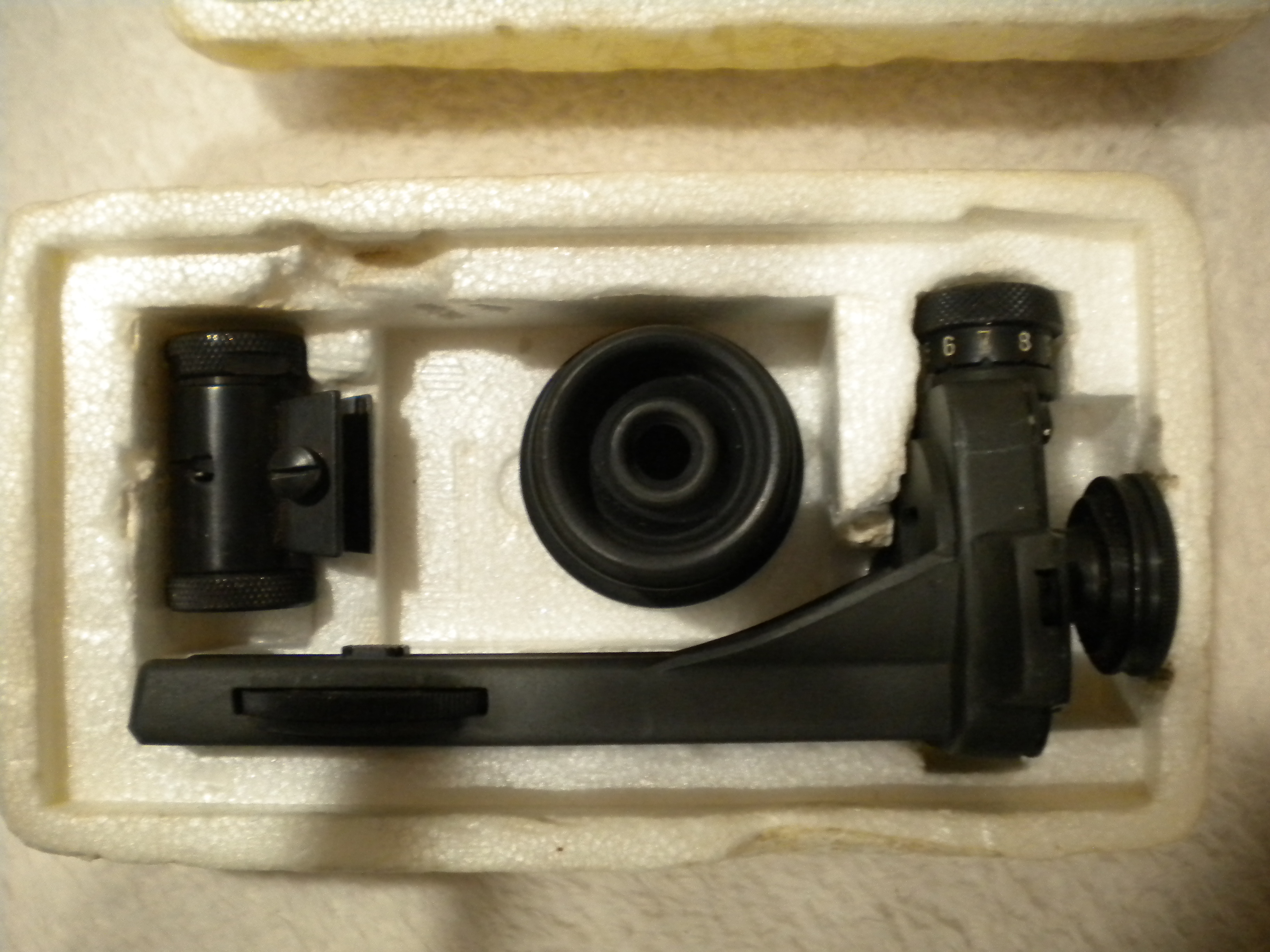

I have any old Diana NOS sights for sale. I'll probably list them on eBay.
Unfortunately that's just the standard sight, not the optional "82" like I'm looking for.out of curiosity though.....is that one stamped " T-01" on it?
I didn’t look at what stamps were on this sight; diopter sights were only installed on T01 and were never installed on a Diana crossbow trigger. Show me what your optional sight looks like and I’ll tell you if I have it. If this is what I'm thinking about, then yes, one of my Haenel rifles has an optional micrometric sight, which is impossible to find. And yes, it works better than the diopter one.
Unless it has been fiddled with previously, your HW50 should most definitely be leather sealed @crowski.
I have used the Chambers leather seals, and can recommend them with the caveat that they will have to be sized on their O.D. to fit the compression tube I.D.

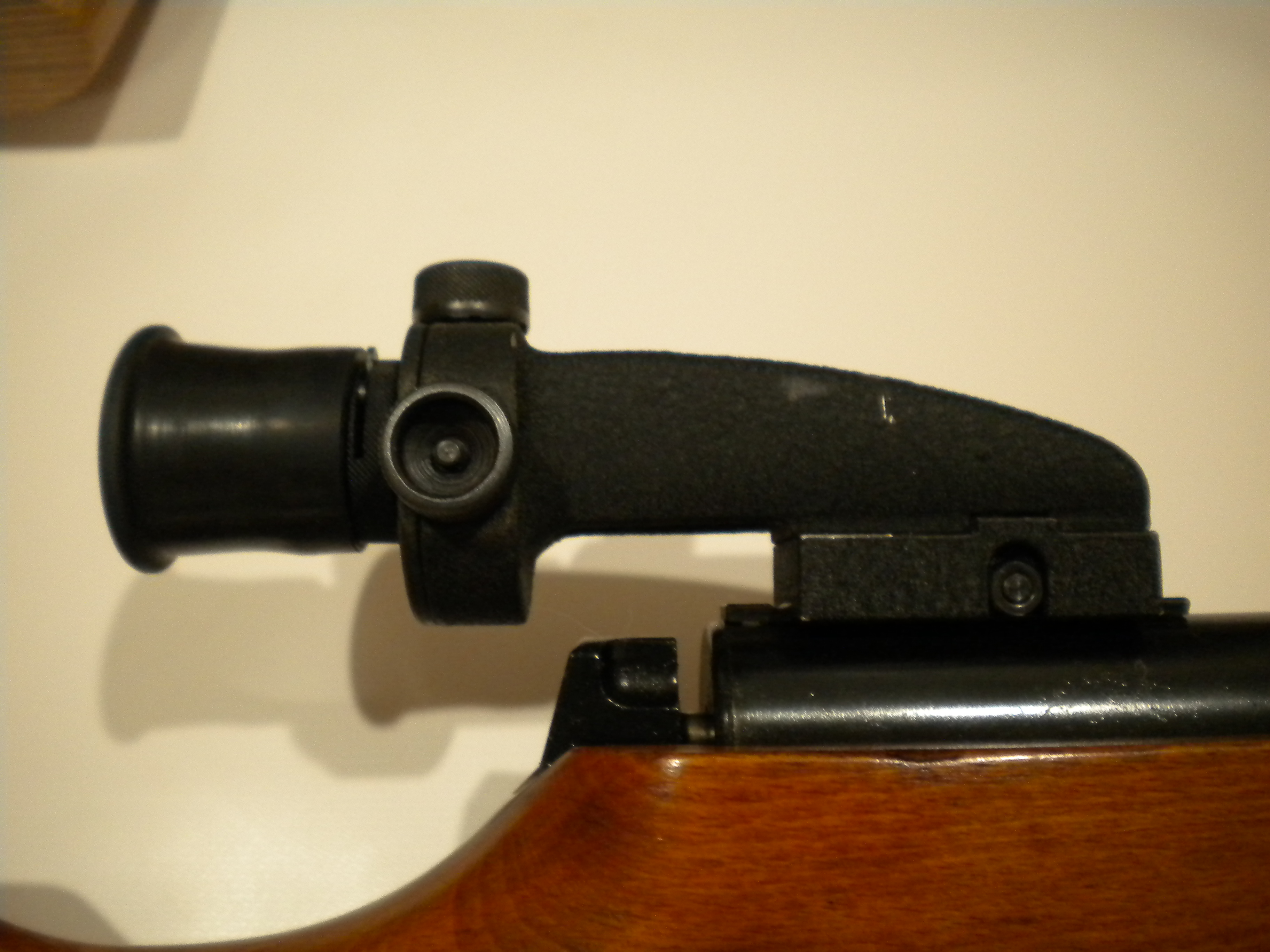

Hey while I have your attention, and we are on the subject of sights.....I'm looking to buy a Diana "82" sight for my model 75 t-01, have you ever owned one of these sights? Are they as wonderful as I think they are? Might finally have a chance to get one, but he wants a strong amount of $ for it......do they live up to the hype?
I've never owned one of the model 82 sights, but handled one at an airgun show a couple years ago. It is made by the Swiss company "Elit," and really lovely. I don't know that it will help you shoot any better than their standard models, LOL, but yes it is a step up quality-wise. Note that classic Anschutz sights will also fit any Diana rails just fine though and are relatively easy to find.
The boxed sight shown in the post above is a Diana "Diopter 60." It will fit the models 60, 65, 66, and 75 match rifles, and many of the older Diana sporters, but NOT the 75 T01 rifle. The "Diopter 75" fits the same guns. The "Diopter 75 T01" fits ONLY the 75 T01 rifle as far as I know.
These pics all show the 60, 75, and 75 T01 left-to-right. The latter two look much alike, but the Diopter 75 T01 has a narrower flat rail shape, and "T01" embossed on top:
These sights are fairly common...but not boxed in such nice condition! And the real jewel may be the FRONT sight - the ones that have a threaded sleeve on both ends were made only for DIana's match guns. The same basic sight, with only a rear sleeve, was used on their sporter rifles.
As discussed above, these sights fit a lot of models, just not the 75 T01. You may be well-served in the future to hang on to it! 😁
