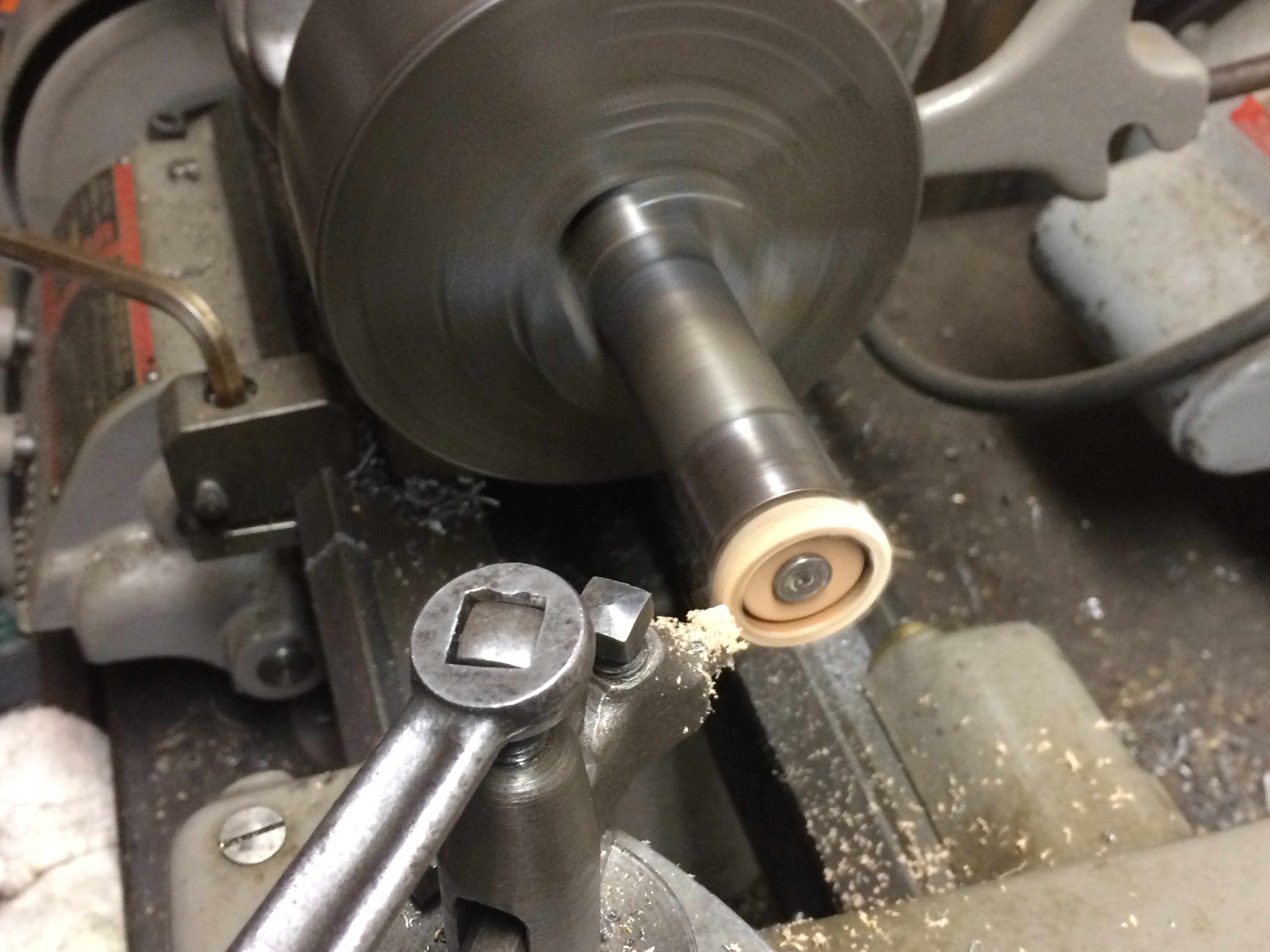

I've made quite a few leather seals for BSA prewars. The Pyramid article above should help you get started. I leave the newly formed seal on the socket and chuck that in the lathe headstock and drill it dead center for the mounting screw with a tailstock chuck and bit.
Here in the fo toe I've mounted the seal on the piston to shave down the seal close before I sand to the final fit. Similar to a urethane seal fit. I'm using a HSS bit to turn the leather actually the same profile I use to cut steel. You should be using HSS on your light lathe. If you don't know how to sharpen HSS profiles you are basically wasting your money and efforts.
You can also chuck the piston rod in a drill and do it all by sanding.
The article suggests an expansion bit to cut the forming hole in the wood block but I use cheap paddle bits.
Many leather seals have a leather backing washer that fits inside the cup. I grind one end of a 3/4 copper coupler sharp and use it as a leather punch to cut a perfect circle for the backer.
(Step 4) I clamp mine with a C clamp
Trimming the seal (step 5) I use a hack saw blade.
You can buy small pieces of leather in the weight you need on eBay for cheap.
