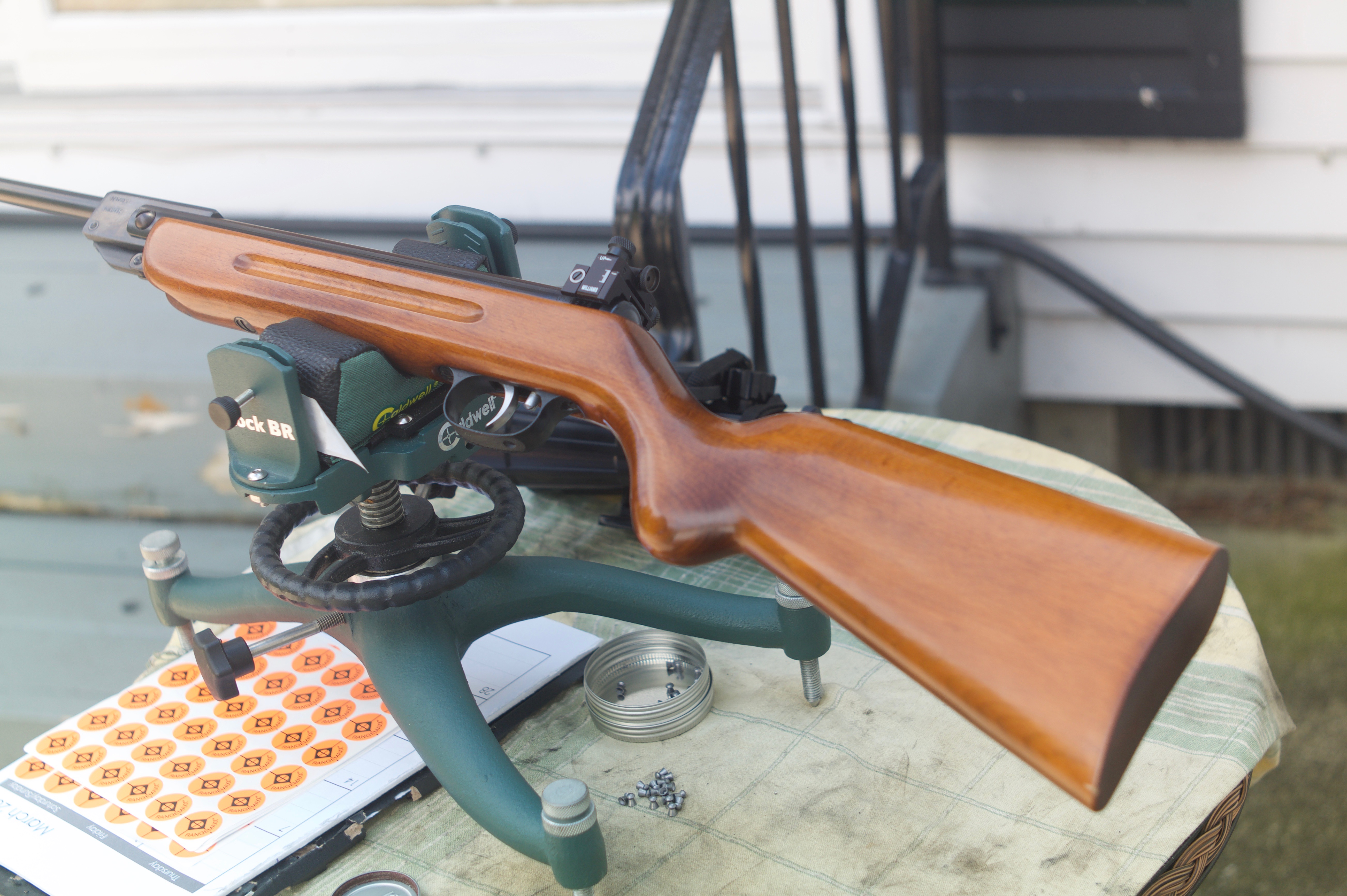

Just bought a HW30 used , has no SS# that i can see unless under the wood . stamped on one side it has , Weihrauch Mellrichstad-Bay also had the rounded hand grip .
Any way to obtain info on this

Bay must be short for bayern
Googled "Weihrauch Mellrichstad-Bay "
Then imagines. And seen several like yours out there mostly auction house .
Sadly thete cookie pop up filling the page prevents me looking deeper
https://www.egunner.com/auction_details.php?auction_id=13533678
All that nra there i wonder if it was a club gun?
Im sure you found this
Thats about it i see
Mike Driskoll will know all about it. His knowledge is amazing. All I can tell you is the obvious. It's an old presaftey model, has a rekord trigger and the peeps aren't original. It's a very nice simple gun. The rekord trigger didn't come on all of them back then. So that's a nice option.
Also it's a leather seal model, it'll have a larger Transfer port and switching it to a synthetic piston seal will likely drop the energy potential.

There was the Rekord, the Perfekt, and maybe another trigger set up correct?
Thanks for the tip on the synthetic seal conversion, that never gets mentioned that I have read, or maybe I forgot........

it looks like it may be much older than i originally thought .
