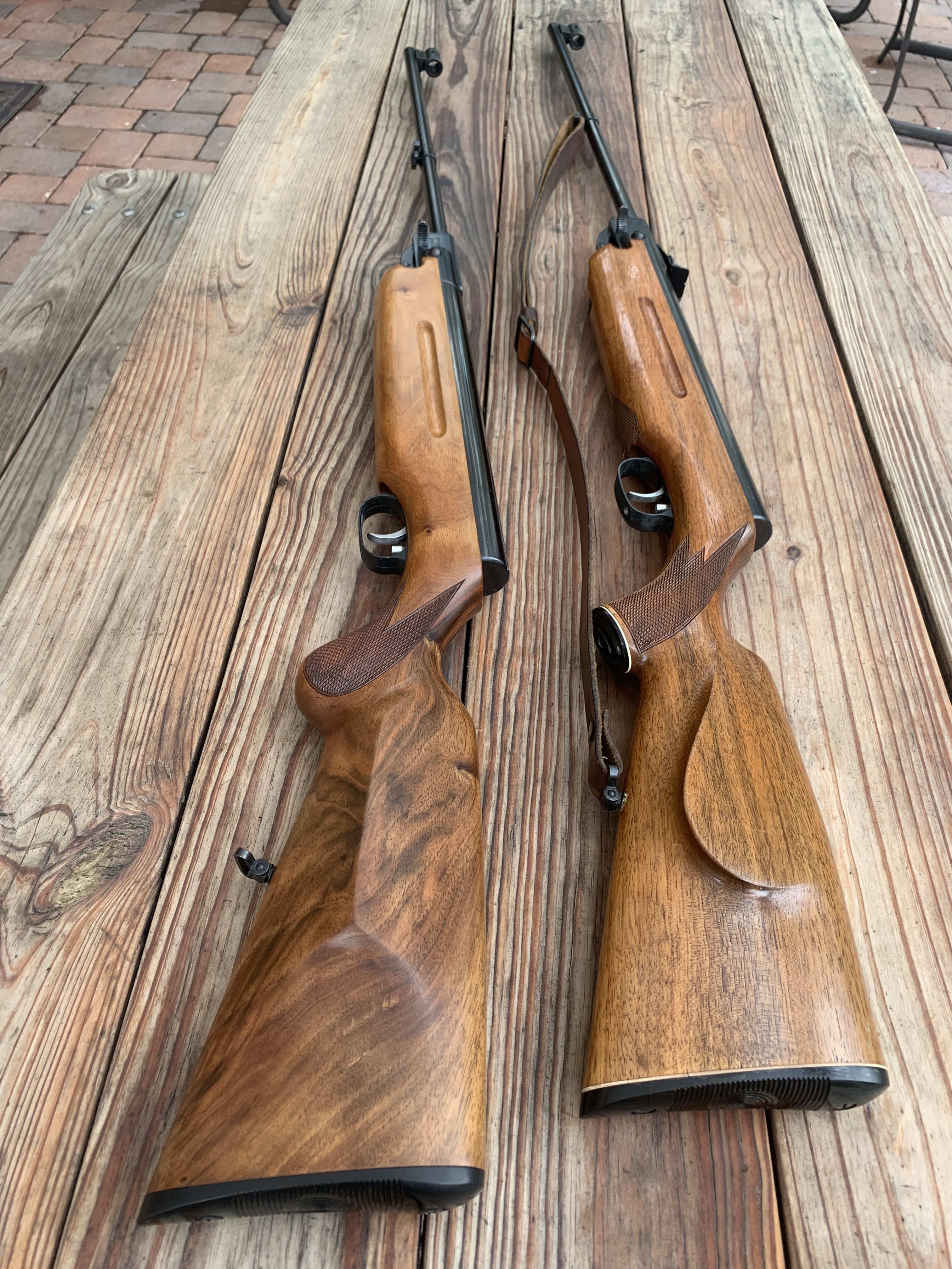

These two are over 50 years old and still going strong after some TLC.
Is that a factory stock on the left? I think it's beautiful. Both the shape and figure appeal to me.
Yeah, if I could buy Matthew's HW35 on the left, I would in a heartbeat ..., but likely he'd want $700+ for it.

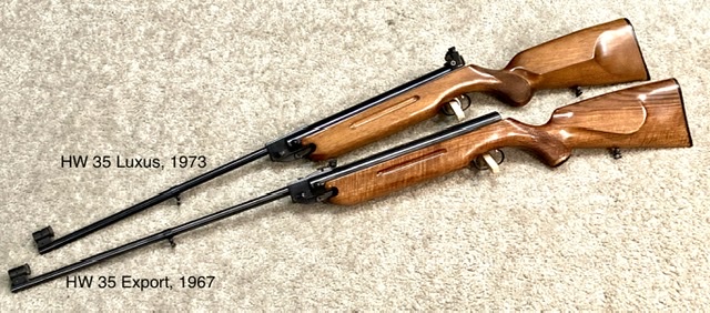

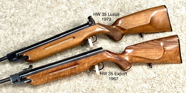

Here's my two, a Bayern Luxus and an Export with 22-inch barrel. If anyone has some 50-year-old "junk" like this they wanna get rid of, definitely give me a call...
Matt...absolutely gorgeous rifles....as always!
