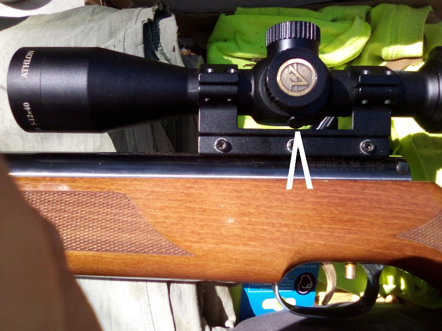

I dont know. This is a 40mm on medium one piece and i got clearance on the lens easy , but what hurts this to go low one piece mount is that nipple plug thing hits ( pointed out).
If i had low 2 piece rings i just cant see a clearance issue. Especially if it was a 32mm scope .
Dont know what a hw 98 differs from another hw break barrel in mounting clearances.
Anyway i dont use 2 peice rings so ???
Next set i will be with a setback/ offset rings . I got one gun i can't go back with the scope enugh for comfortable eye relief .
Why i said give a picture of what you got going on.

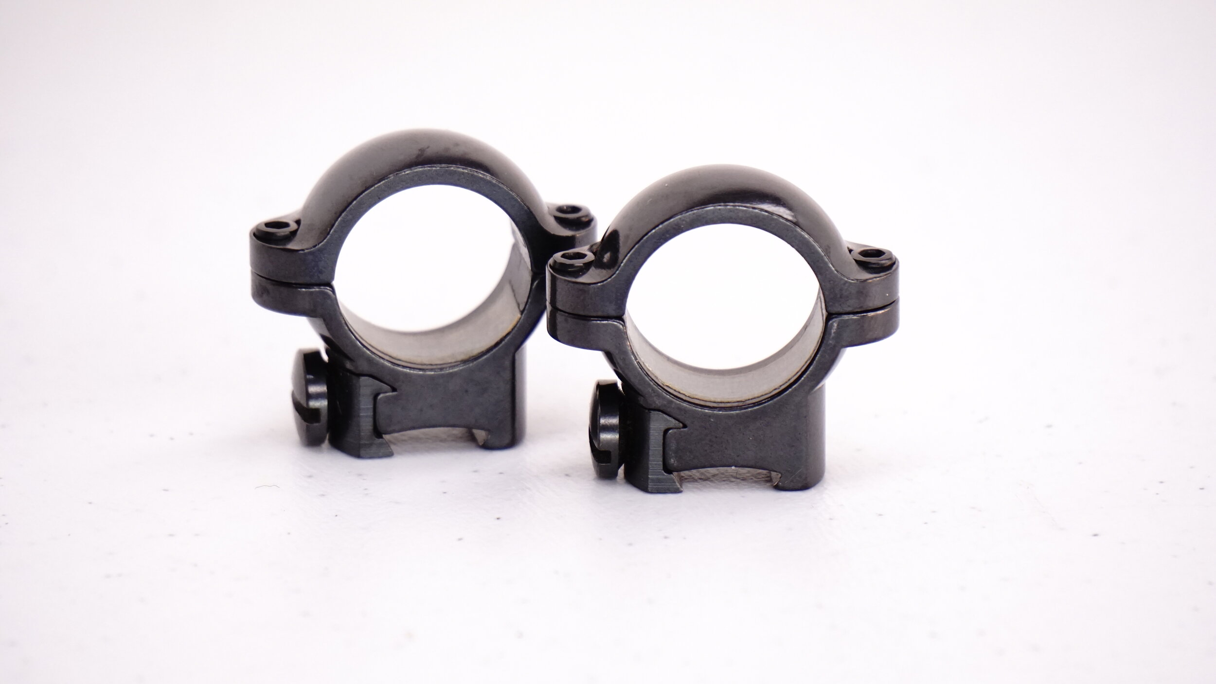

Here's the type of rings I want to use. They're really low. The Lynx rings I have have a stop pin with them, but it's very small in diameter. I guess I "could" bore it out and turn a larger stop pin, but I hate to do the work. The HW arrestors could turn out to be too tall to clear.
The pictured rings are Leupold, but I have a few sets of Lynx/Hilver and Zastava rings that are all very similar.

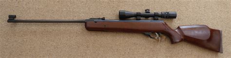

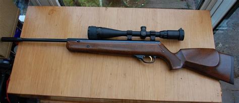

FWIW, SportsMatch T04C medium 2 piece rings mounting a Hawke 3-9 x 40 mm AO on a HW95L .22.

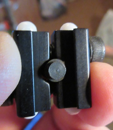

Don't know if they even still make and sell them, but once upon a time, Sun Optics made a recoil stop block. I have a couple of them and the stop pin is a perfect fit for the holes in the top of an HW rifle.
You'd have to search to see what, if anything, you could find on them if you're at all interested.
