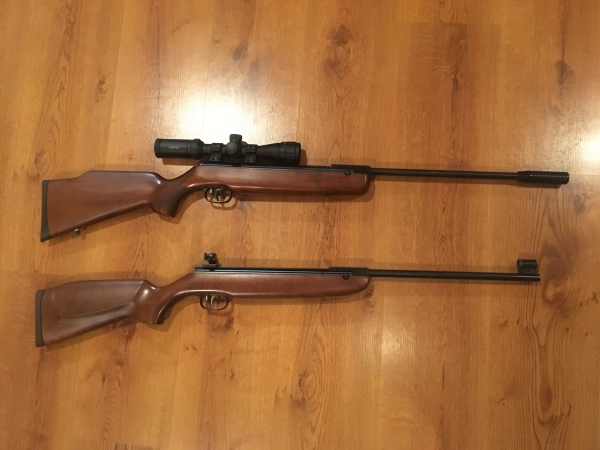

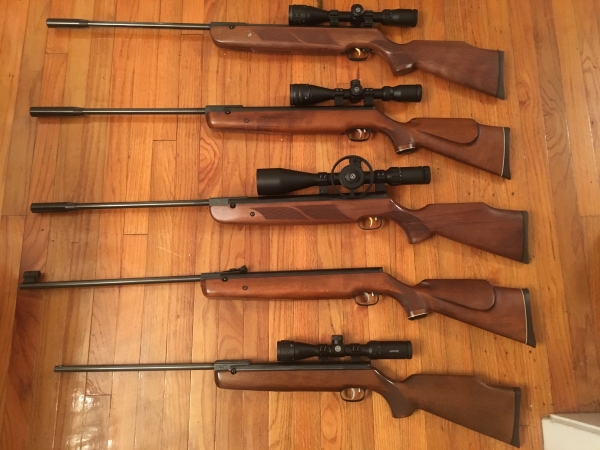

Lets see Allan,
R7, pre-safety, .177
HW 30, .177
R1, .177
R1, San Rafael, .177
R1, .20
R1, San Rafael, .177, 12 ftlb kit
R7, .177
All but two have Vortek kits in them. I don't really have problems with screws backing out on any and they all get shot a pretty good bit. The Air Arms guns probably have a little more of a "finished" feel, I know, I own a ProSport. But the Weihrauch guns are clearly built to last. All I need is a gun and tin of pellets and I am entertained for hours.
