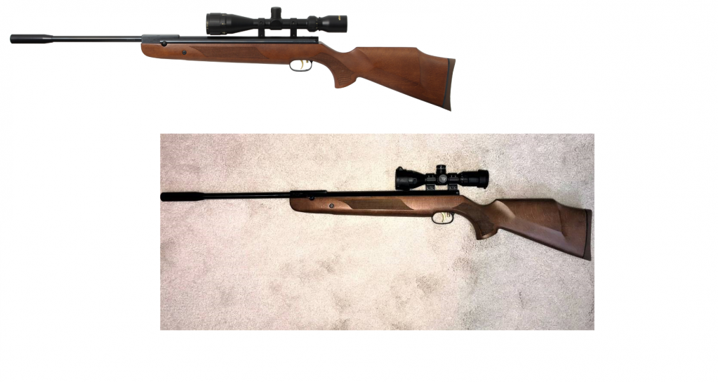

I did say "unless they changed something"...lol. Used to be they were glued on. If you saw my R9 side by side with the Field Pro, you'd probably think they were the same gun and they are...until you see the badging on them to say one's a Beeman, one's a Weihrauch and the muzzle break on my Beeman is glued on. Picture of my R9 is below.
There were a couple years where Beeman rifles had no open sights and the guns were scope only. When they went back to putting open sights on them, Weihrauch ran with the idea and came out with their "HW95 Field Pro" which included a scope and rings.

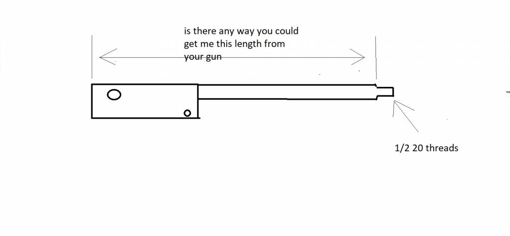

i think nother guy on here mesured his 95 barrle was threaded 1/2 20 was like total length 11 3/8 then ldc screws on i think the versions that are not threaded are 16inch full barles i have my r9 soon i see if it threaded or not

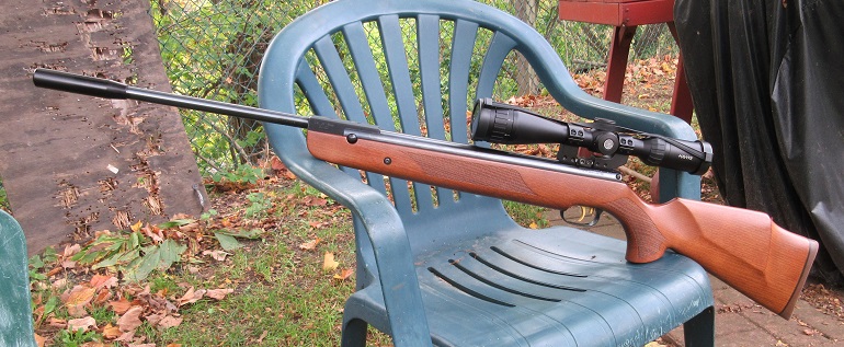

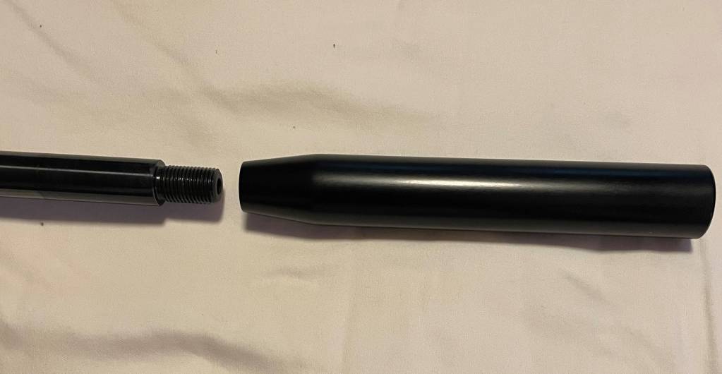

FYI HW95L Trivia;
Rifle/scope weigh:
7.5 lbs = 120 oz Weihrauch HW95L rifle
4.4 oz = Hawke Tactical 30 mm medium 2 piece rings
21.9 oz = Hawke 4-16 x 44 mm SF, IR, compact scope
Total = 146.3 oz which is 9 lbs 2.3 oz
LOP = 14.25” trigger to center butt. WIN M70 30-06 = 13.875", CVA Accura V2 50 BP = 14.5"

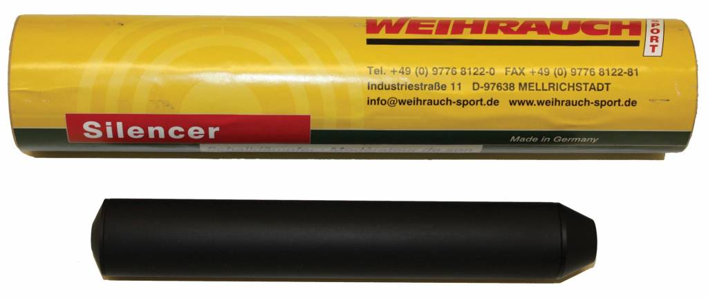

My HW95L, (2018 built per S/N), measures 12 & .1875" (3/16”) from breech block to the end of the barrel threads with moderator/silencer removed. The threaded section of the barrel is .75”(3/4”) long& .50” (1/2”) diameter with 20 threads per inch. Piston seal = 26 mm, 1.02362205”, stroke = 85 mm, 3.35”.

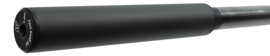

Moderator weighs 4.32 oz, 122.6 g, 1892 gr.
The Hawke tactical medium rings put the center line of the scope 1.5” above the .22 caliber bore.
Barrel length = 15.75” from end of moderator to end of breech block.
Rifle twist rate is 16:1.

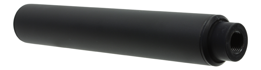

Moderator is 6” long. Female threads start 2.25” in from beveled end of Moderator. Rifle length = 41.875” from end of moderator to butt center.
