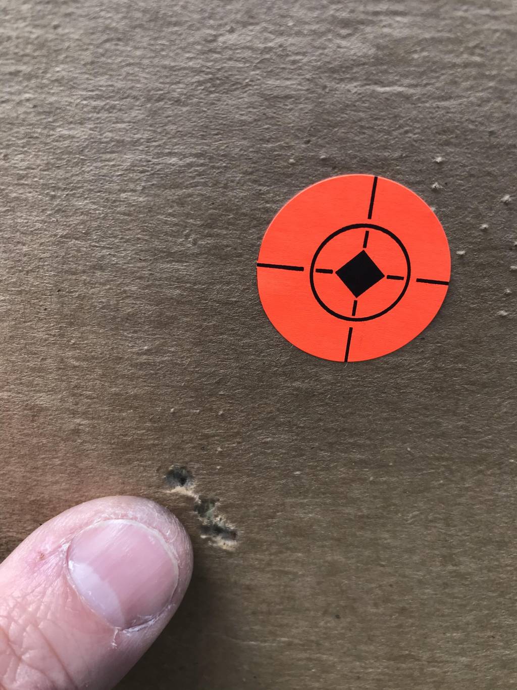

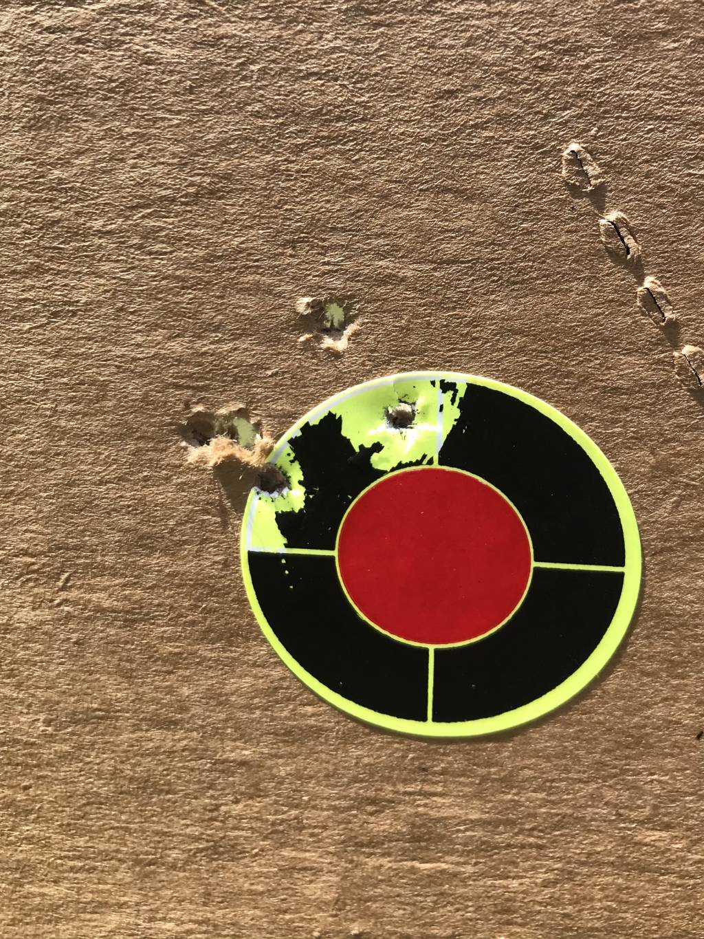

Finally got the Hw97 out to the range for 25 yard testing. The crosman premiers did ok and the h&n ftt did better and had the same point of impact. The jsb exact 8.4 shot the best groups but the point of impact was quite a bit lower. Pics in order are 10 shots h&n ftt, 5 shot jsb exact, and 5 shot crosman premier.
More testing needs done and I need more practice. I had a stiff head wind and I wasn’t cleaning my barrel in between pellet types. Has anyone experienced pellet point of impact that far off with jsb pellets of the same weight? Since the vortek install I have not chrony’d anything but the crosman premiers 7.9. My HW97k in factory condition shot the jsb pellets low at 10 yard but they were the most consistent on the chrony.
I have that kit in my HW97 4.5mm. The FTTs are good. Mine likes the 10.9gr barracuda match best. It’s stupid good. I have a fixed 10x scope and the barracuda match can land on the middle of a 20mm spinner that I can barely see from 30 meters 91%of the time, the other 9% I misjudged the trigger break between heartbeats or forgot to glance at the bubble level. From past experience, I don’t think I would shoot 7.9gr more than 10 yards. But 7.9gr can hit flies at 10yds
