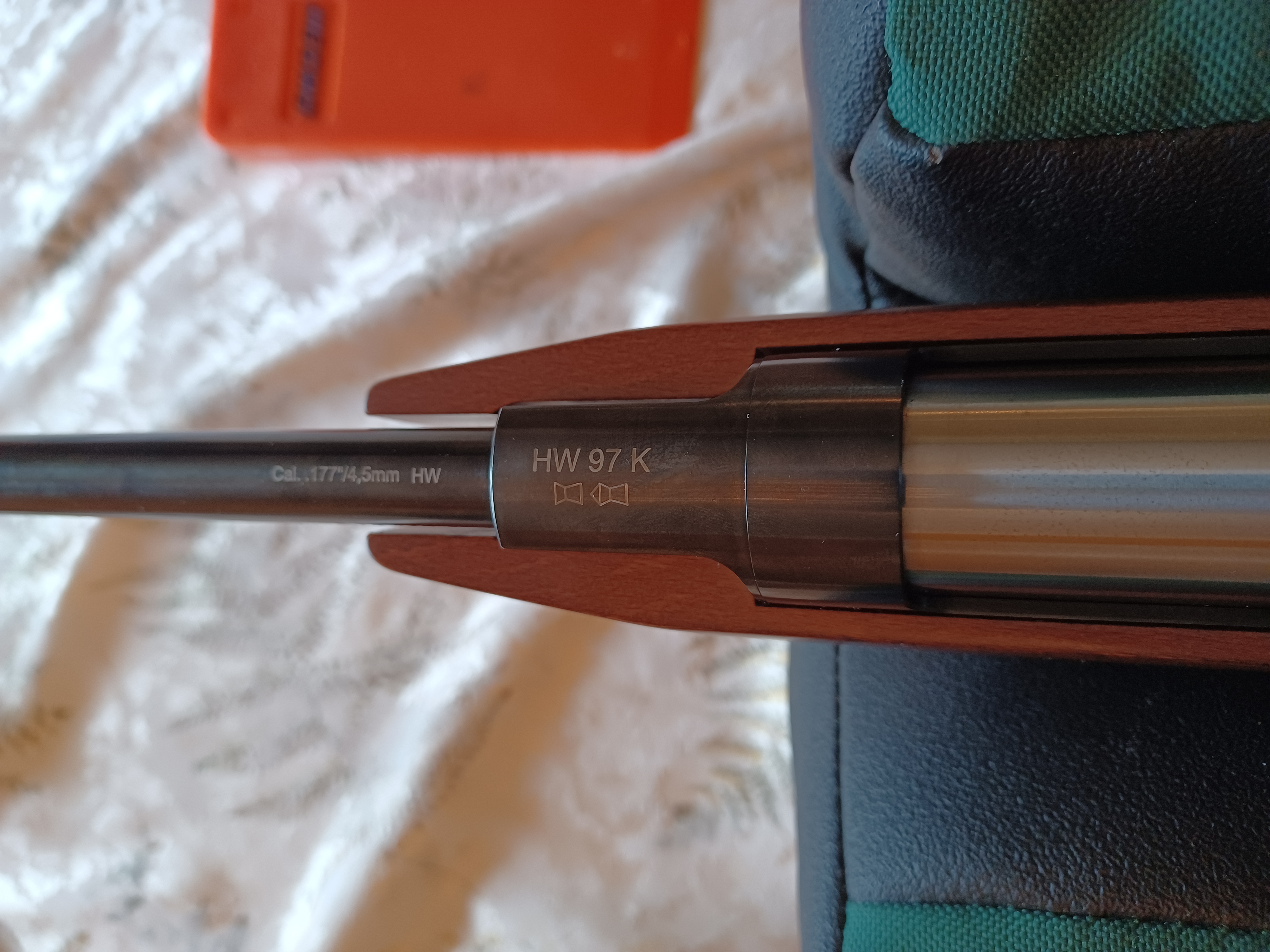

Will try to upload a picture. This is after 3 nights under wedging. Looks much better still slightly off-center.

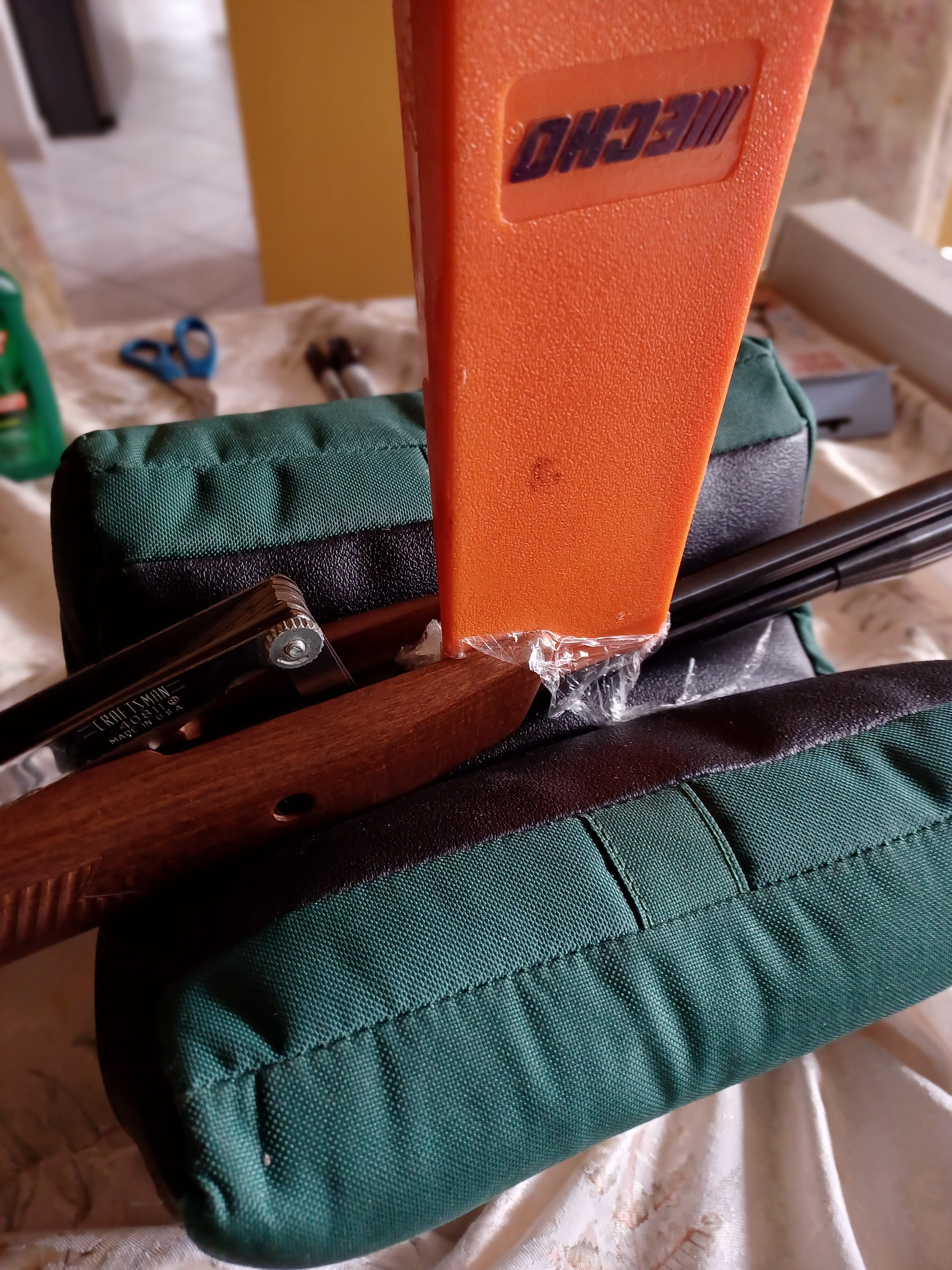

Here is my wedging operation. :) Using a feeler guage and a wedge. I'm careful not to over wedge.

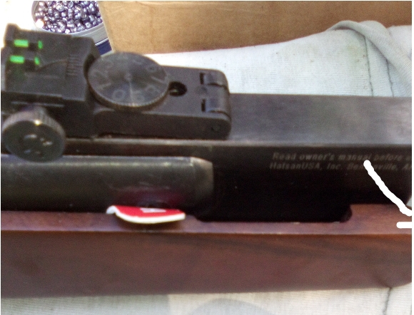

Ya, this gun the windage knob rubs when i cock it .
I just used a cardboard shim in the stock to push/ hold it out so the knob dont hit ..
I figure over time it my set up right with that shim in keeping it "straight"..
I put the shim cardboard so you can see it and where it at.. i can poke it down out of sight and mind..lol
