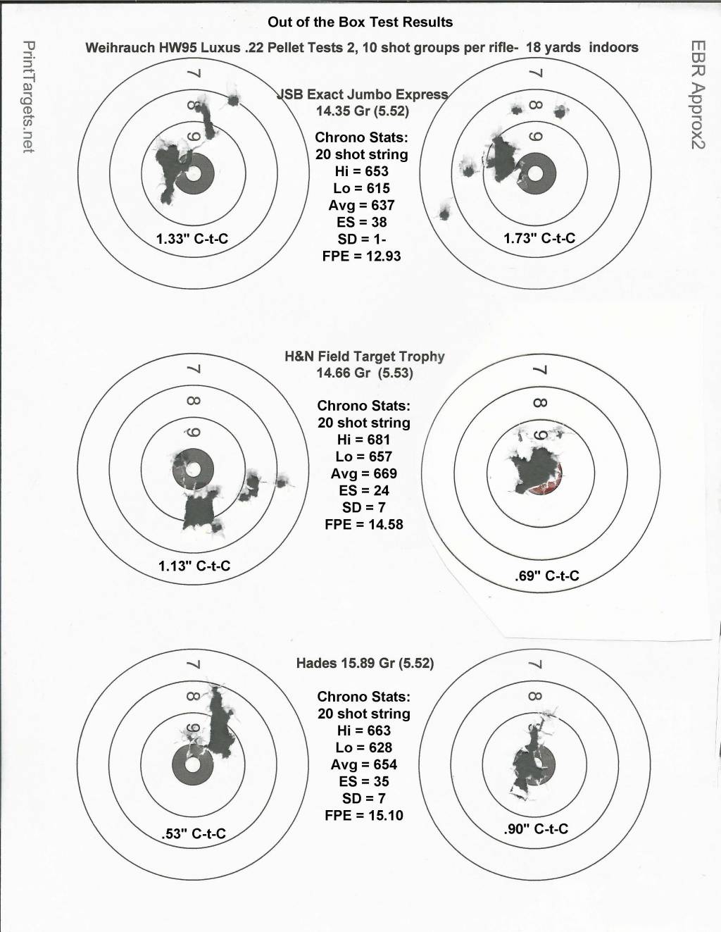

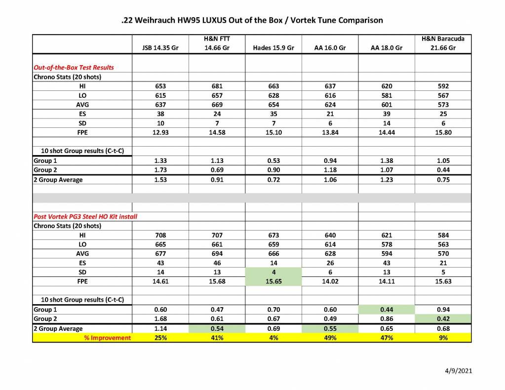

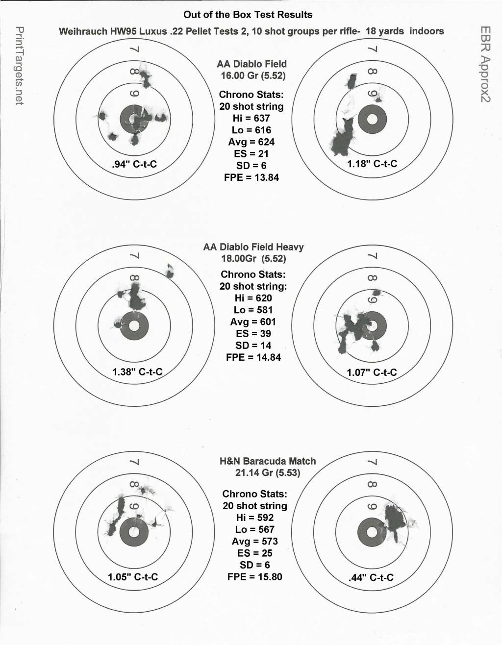

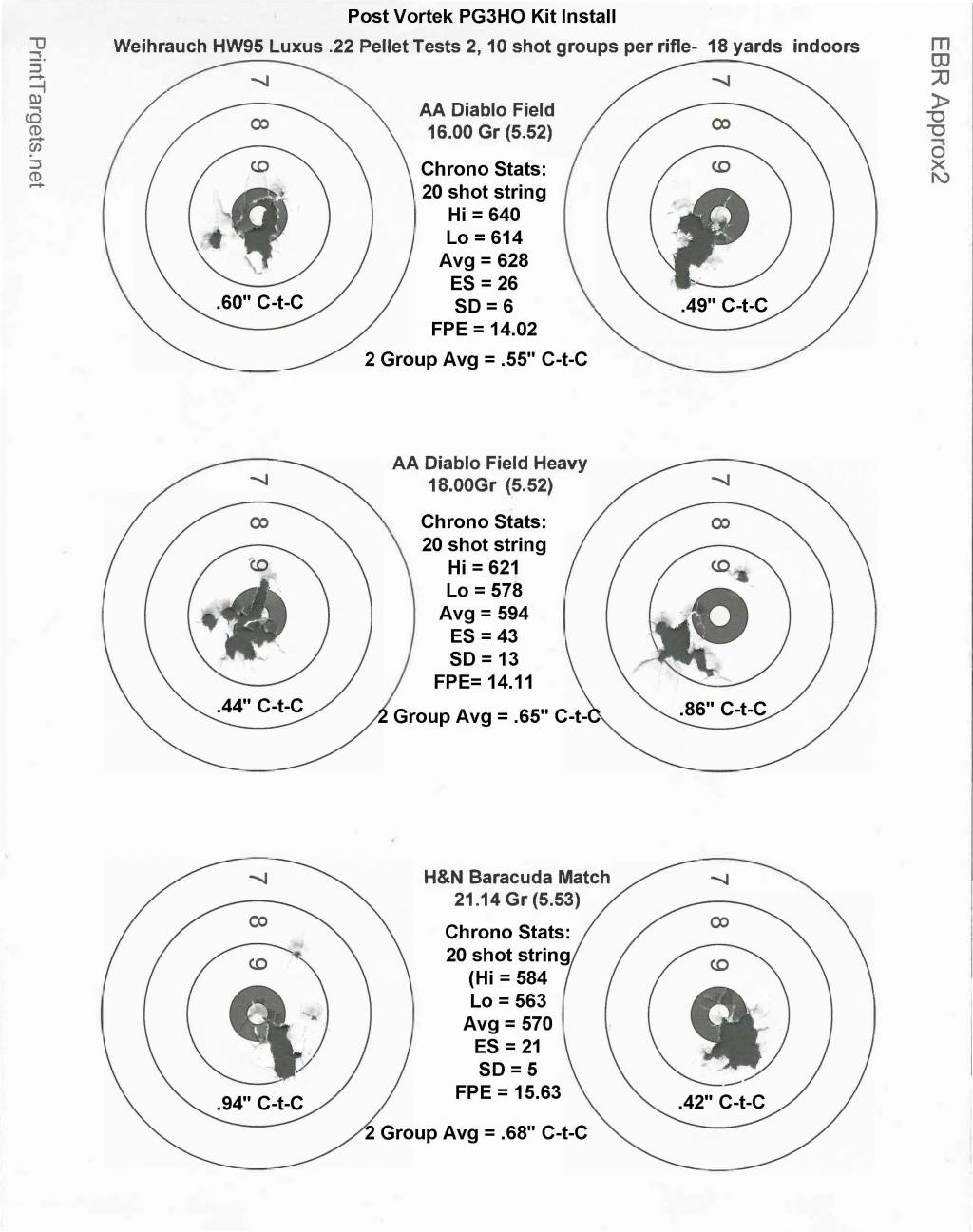

For those of you that wonder if it is worth it to go to this level of effort, you can see the dramatic and immediate improvements in the groups by looking at the 2 group averages in the accompanying test results chart as found below. While there are some anomalies in the chrono stats that I really can't explain, I believe they are more to do with the varying weight and conditions of the pellets than the rifle's power plant. The rifles shot cycle is now extremely smooth, with no "buzz," and only a solid thud upon report. The trigger is incredible. You will note that nearly every group average was significantly improved over the out-of-the-box testing results, and all groups showed at least some shrinkage. The power level actually increased with the Vortek kit while the groups significantly improved. I only expect these results to get better after a reasonable break in period.

Cool! The results are very similar to my HW95 with a Vortek PG2. I got a tiny bit more power, around 720 fps (at the muzzle) with the H&N FTT 4.66. On the other hand, I didn't notice an increase in accuracy, possibly because I'm still fiddling with my scope. The two main benefits IMHO are twang elimination, and the experience of working on your own gun.
The cocking effort is considerably less than with the original spring. I always ask Tom at at Vortek (can do so easily within the notes section at checkout) to reduce the number of coils to produce the power level I desire. In this case, I asked him to target an output of 14 to 15 fpe. As you can see from the results, he pretty much hit it on the nose. I find that with the .22 and .20 caliber, this power level typically produces terrific groups while eliminating buzz and any harshness during the shot cycle, extending scope life almost indefinitely and making the rifle much easier to cock.
