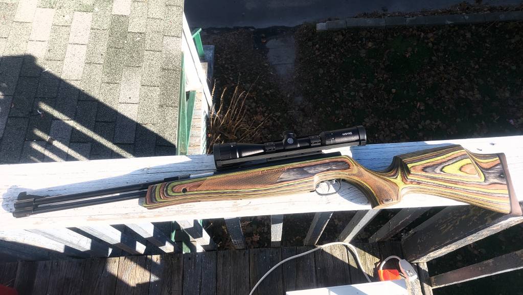

Christmas has come early , # fistbump Santa! I couldn't resist, the stock is exquisite, the machine work is un paralleled in my opinion. I present to you perfection in a box!
 I liked the option of iron sights on the 77, and without the "moderator" on a 97 it squeezes a few extra fps ( debatable) as a toss up between the blue laminate 97, and the above. with the 77s heritage it was tough to choose between the 370 mm. karbine and 470 OG length , opted for the shorter barrel For decreased pellet dwell time.
