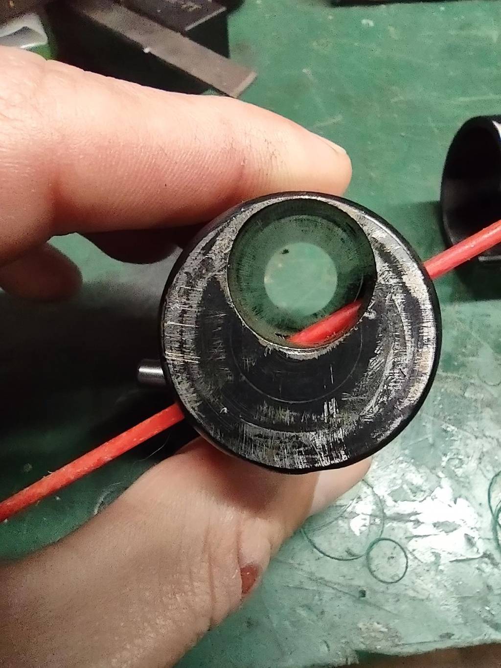

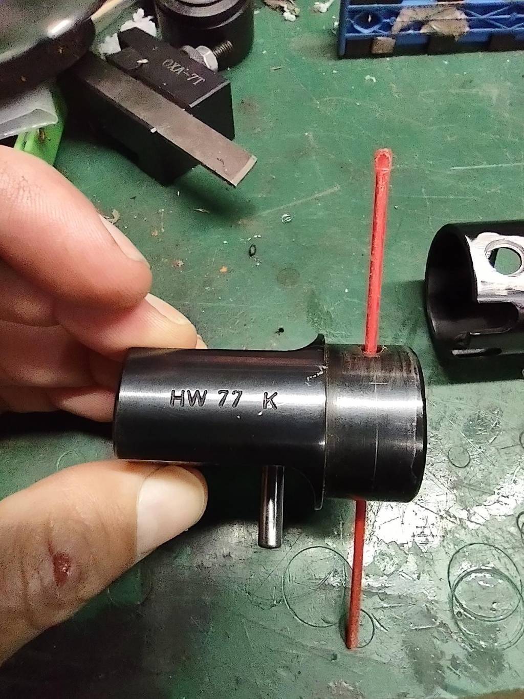

Alot of guys don't know that the barrel can't be simply pressed out, myself included until I repaired a couple with broken welds that got damaged in shipping and I happened to notice the pin.
And that hidden pin is a bear to get out. The hole it goes into isnt drilled all the way through. So you can't tap it out until you drill a new hole in precisely the right spot to drift out the pin.
The pin that goes here is why you have to cut the gun apart to change the barrels. No idea why they put the pin here. The press fit is so tight that it's completely unnecessary. But, overkill has been a pretty good formula for Weihrauch over the years.
Just wanted to show the "why" since I have one apart.
