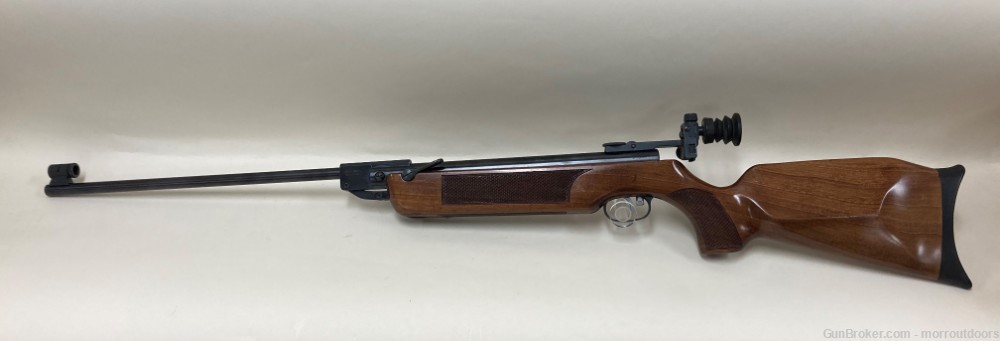

I recently acquired a 55M and now I'm setting to work on it. The stock has some dents / handling marks and will be refinished by me with Napier's London Oil. I will strip the gun and examine the internals but the rifle cocks and shoots very smoothly as it is now. Breech seal looks good but it's coming out. I'm expecting that it and the piston seal will be OK as is but may need some TLC there. Then I'm going to completely disassemble everything on it and have the metal work re-blued. Will take photos all along the way. Will be a spectacular airgun. Many thanks to Scott Blaire for his guidance to date. Teaser photo below :
Looks pretty good in it's present condition.
Yeah, so does Barbara Streisand... at 30 feet. Seriously though, what the photo does not show are some pretty deep dents and scratches. The surface rust isn't all that objectionable but I want to see this airgun back to its former glory. I'll probable retain the leather seals and spring (if it's straight). Inspecting the breech seal indicates that it is synthetic so I'm not sure what is on the piston. Either way, I need to tear it down and make sure the internals and inner surfaces, etc are up to snuff.

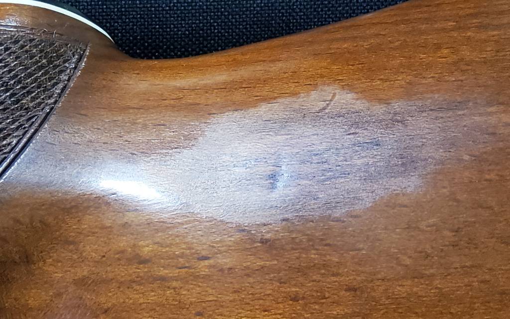

My Feinwerkbau 124D has a dent (I posted a thread on improving the stock) on the stock that steam was used to try and remove. If there that deep it won't remove it. Improve yes...remove No ! Here's a pic. You can see that this dent wasn't removed and the finish damage caused by the steaming process.

Sorry to see that. I had a 124D that had some small dents and couldn't real get them out but I didn't have any finish damage either. As I understand it, Beech is difficult to work with when using steam and the finish on the stock blocks the steam too. I talked to an airgun tuner and he said that he puts tiny needle pricks where the dent is and then steams it. He then blends in some stock finish to cover the pin pricks. I really don't know first hand. I've steamed out plenty of deep dents in wood but never on finished wood.

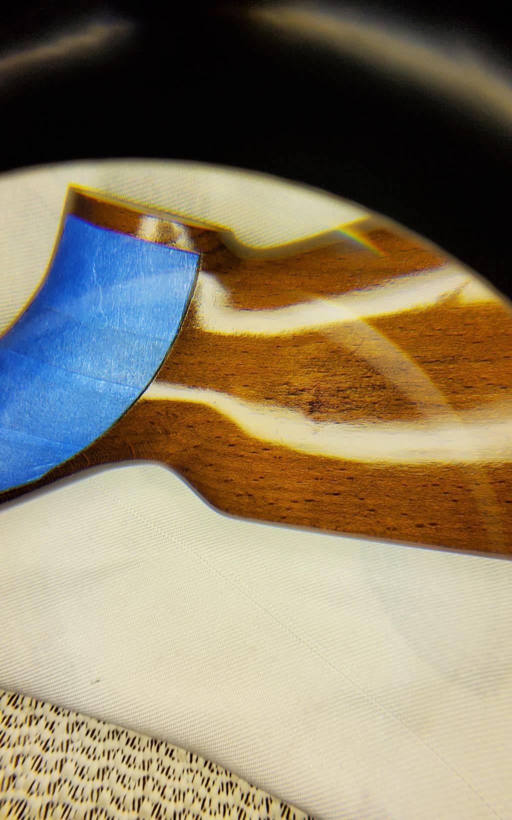

I didn't correct the dent completely but the finish looks a heck of a lot better. Like to see some shot groups with that rifle Bill. My 124D during repair.

Your repair looks good from what I can see in the photo.
