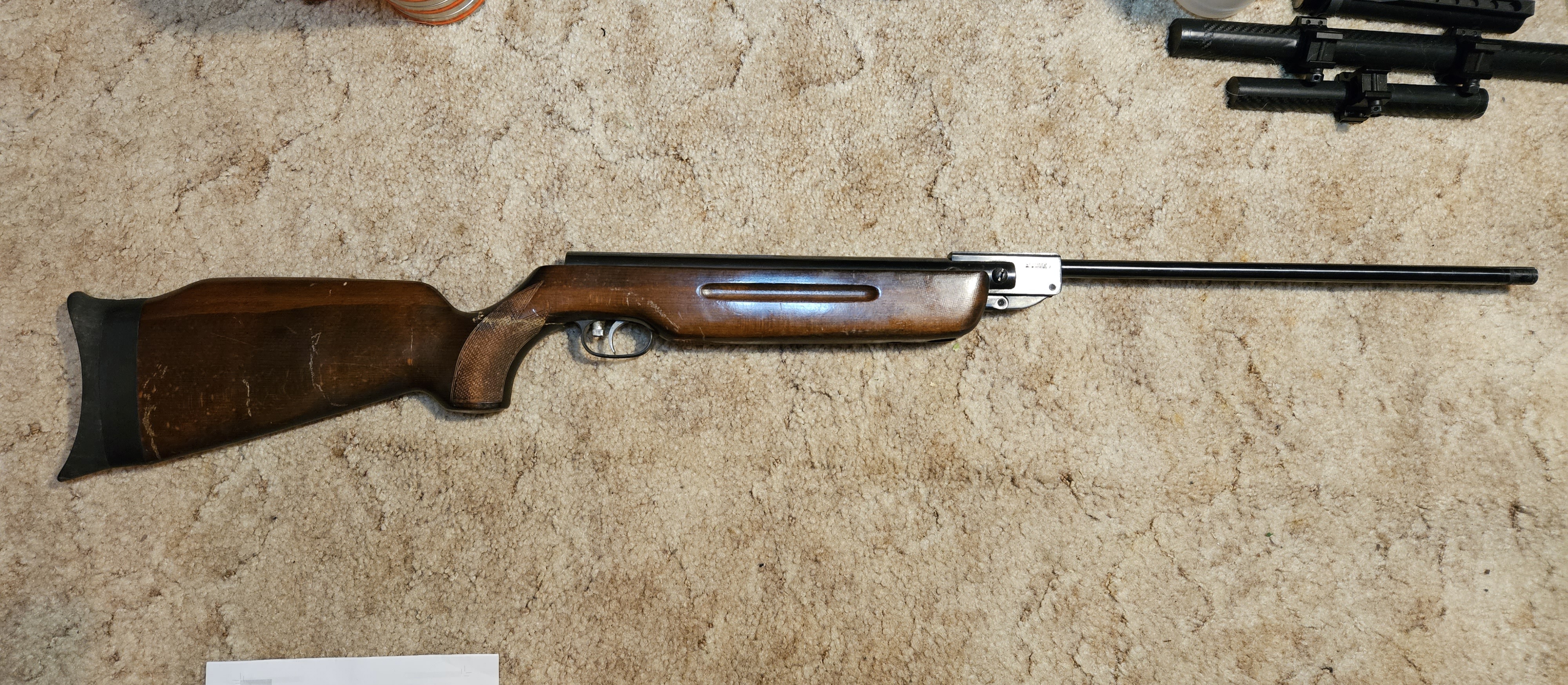

When I first received my 55, I was kinda freaked out by the front site. Then I found out it was original. Glad I didn't get crazy and remove it.
The chronology of the sites is textbook material. Again thank you for participating. The pictures from VAG are also something special. Museum visit via the web. Where else will you see such a beautiful display of 55s? The added Vintage components are impressive. Those alone are rare and require a Safari hunt to find.

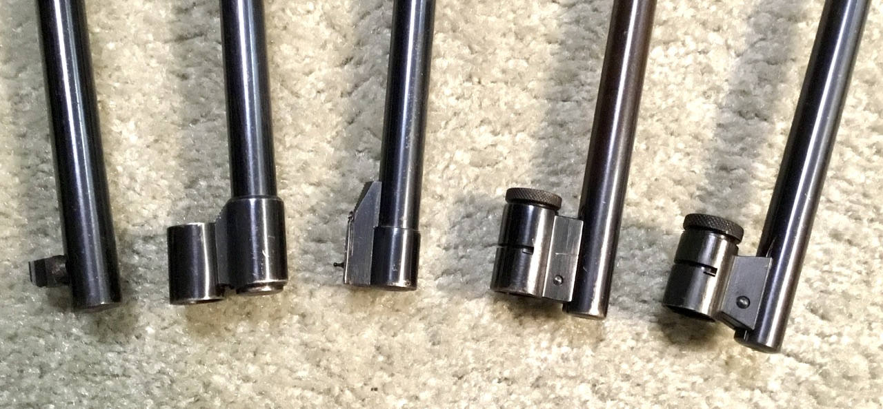

I have read your posts on different forums and really appreciate the history and photos that you contribute. Whenever I see your posts I want to hunt down a HW55 or older version HW50 of my own.The HW 55 was made for almost half a century starting in the early 1950's, and along with different stocks, etc., there were countless evolutionary changes. Kingfisher61's gun is a very early one. The fixed-post front sight is correct, and also note the much shorter threaded rear section, cast metal buttplate, side screws in the fore end, longer heavier barrel, and different trigger guard. And many other subtle detail diffs if you look close.
Here's a selection of HW 55 front sights. Left to right in order of age:
+ Fixed blade in transverse dovetail, same as in the OP. These came with a snap-on hood which often gets lost.
+ Later sight with interchangeable milled posts, this one still has its hood.
+ Another version of the interchangeable post version, again with a missing hood.
+ The first style of tunnel sight with flat metal inserts. There were some variations in height with these, but note the low rectangular mounting dovetail. They use the same inserts as later sights.
+ The taller tunnel sight with trapezoidal dovetail, standardized by the early 1960's and by far the most commonly seen today of course.
Here's a detail of the neat milled posts (note the retaining screw at the front). Other makes of guns at the time used these too.

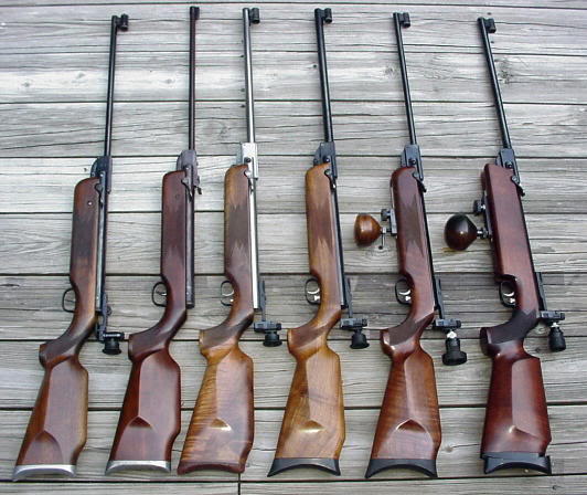

Drooling now .K61, your photo above from the Danny Garvin's fantastc Vintage Airguns site is from one that I sent him years ago.

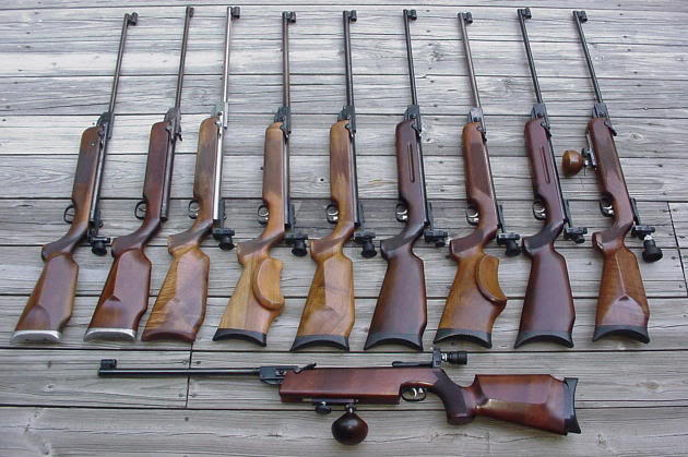

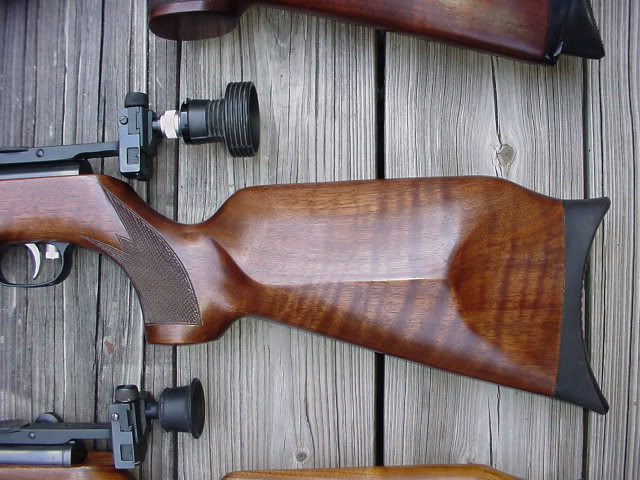

These ten beauties are NOT my HW 55's (waaahhh!), but belong to an anonymous friend in Alabama. He is a pro-quality gunsmith who typically refinishes the stocks, and does some preservation / restoration work on metal parts (one is awaiting re-blueing in these shots). As you can see he also loves to outfit them with vintage accessories!
I soooooo want to own one of those 55s with the finger groove fore end.
I have heard repeatedly about how lively they are in hand, coupled with the accuracy the 55 is renowned for........... what is not to desire there I ask you?
Thanks as always to you fine folks that keep the history alive.

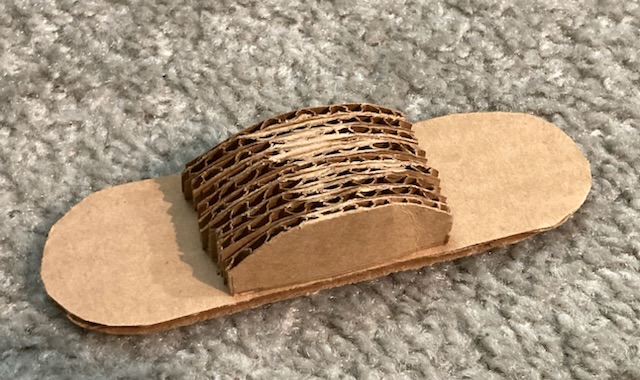

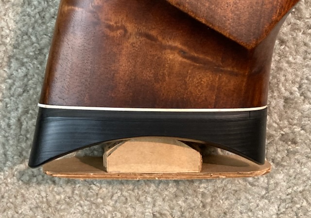

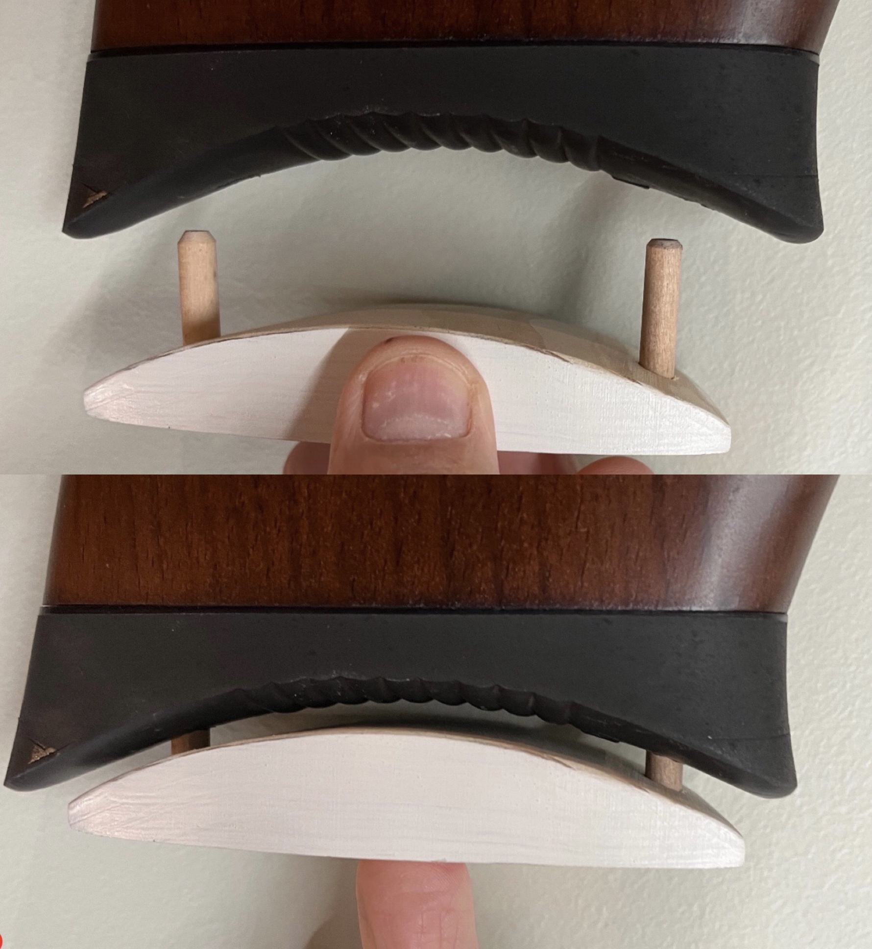

Glad you got your dream HW55. That‘s a beauty.Ha, I hear ya - my HW 55's are also stored horizontally.
But here's a super cheapie solution for curved rubber buttplates stored vertically, of which I also have a few. Using plain old corrugated cardboard, cut a base to fit the slot in the gun cabinet, and curved scraps that are a smaller radius than the gun's buttplate. Thus the weight rests on the buttplate's center, and not its "ears."

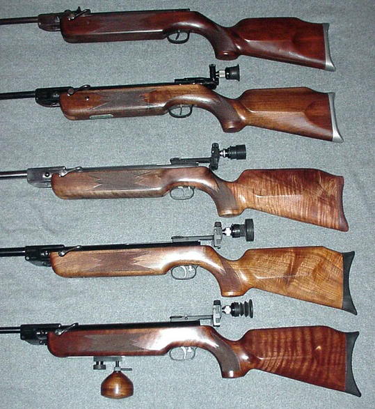

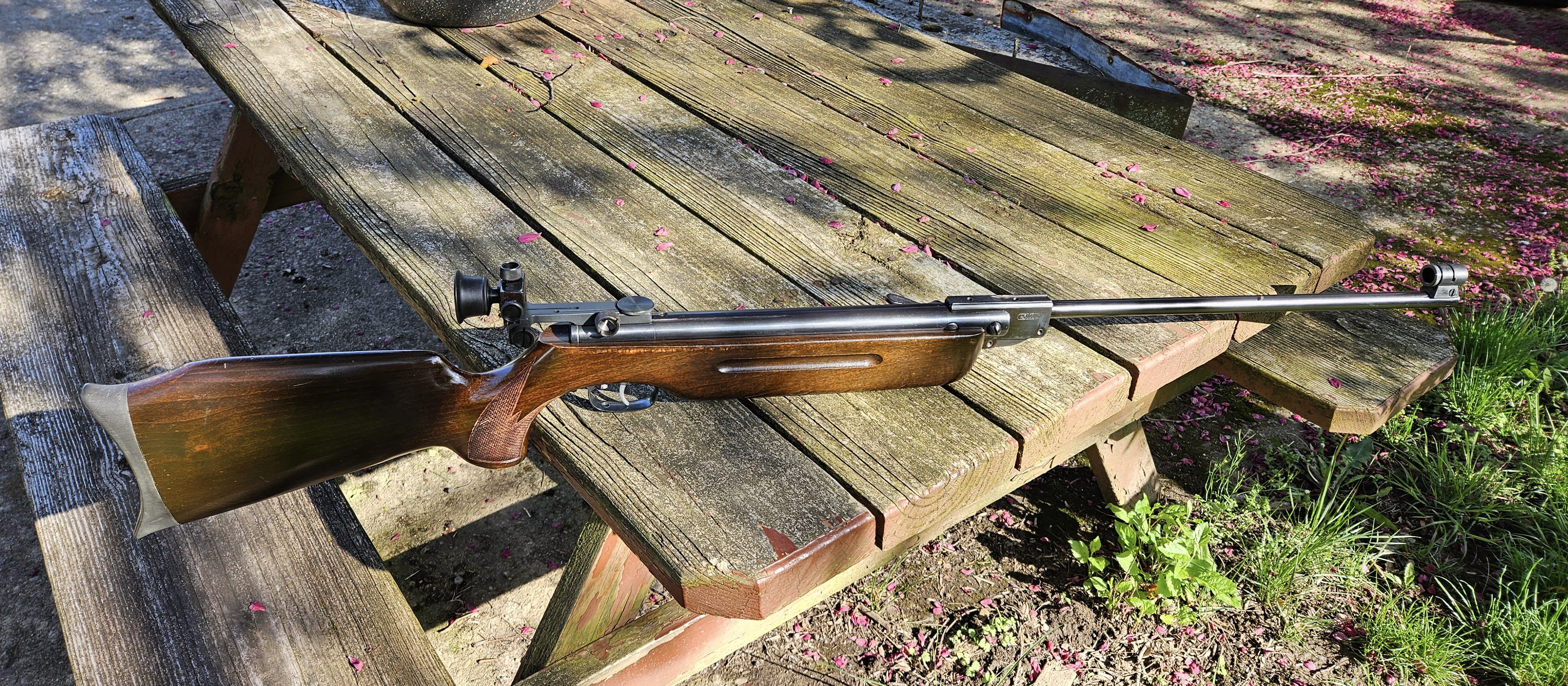

Way to go!!! Gorgeous 55S!!!!And I now own one.
1965 HW55S that is.
Purchased earlier today at the Findlay Ohio show from Mr. Driskill.
My expectations were exceeded, and this is exactly what a low powered Sporting/Match rifle is supposed to be.
Enough depth in the stock forearm to shoot accurately without the full on squarish match look, and light enough that it isn't burdensome to tote around the back yard popping the odd sparrow or pine cone.
The shot cycle is quite pleasant, and the rifle overall, is quite refined in manner.
Always a pleasure to meet and talk to you sir.Thanks Chuck, great to see you yesterday. Glad you like it (and had the diopter for it!), and hope you will continue to enjoy it. Best as I can figger, it dates from 1965.
I should mention that r1lover had a hand in that one - it came from a friend of his in CA that he put me in touch with. I never had it apart but it was obviously nicely maintained and shot quite well.
Funny thing is, the only reason I knew of that peculiarity, was due to a post of yours some time ago.I picked that injured one up a couple times - glad it's in your hands!
One interesting detail on older 55's (including the one you got from me) is that the breech leade has a subtle taper - done by actually banging a mandrel in there. These guns tend to prefer pellets with a larger skirt diameter, so I find the classic older RWS designs (Hobby, Meisterkugeln, S'dome, etc.) are usually best in them.
Not sure when they quit doing this, possibly 40xxxx serial range.
