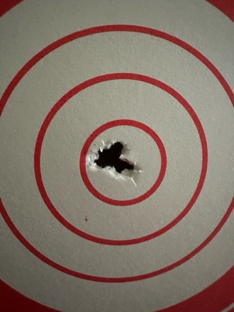

The five shot group at 100 yards was shot just before dark with no wind. The 12 shot 1-9/16" group at 100 was supposed to be 10 but I miscounted. I adjusted right and got the windage perfect but it was too dark to see the correct Mildot got the holdover so I was happy. The H&N Barracuda Match are as accurate as the JSBs but cost a bit more. I tested the H&N Barracuda Hunter and they were terrible.
Edit to add, blowing that picture up big looks like 14 shots at 100 yards. I must have shot an entire magazine.

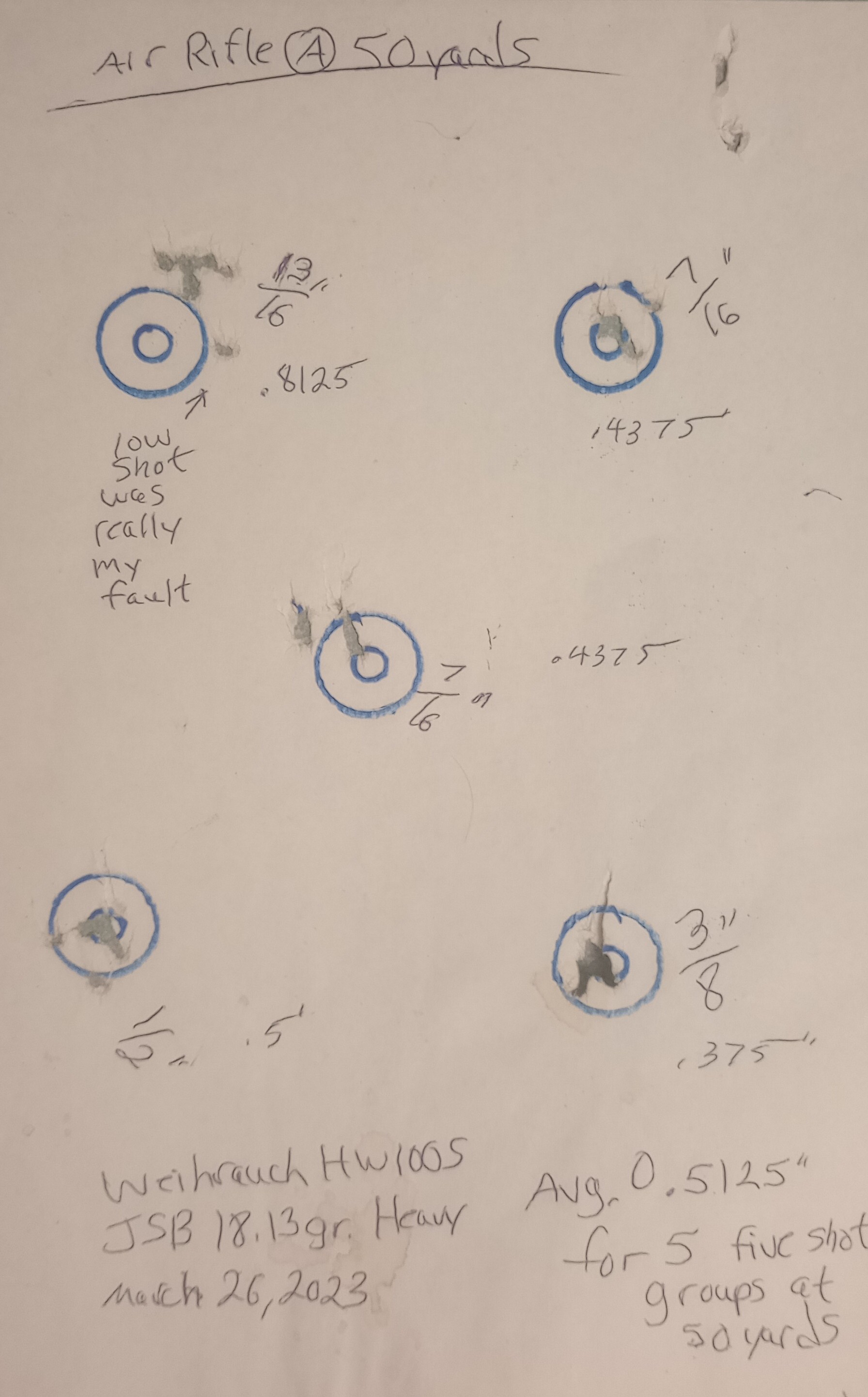

Six very accurate five shot groups at fifty yards with 38 ft lbs of muzzle energy is extremely satisfying to me, I couldn't ask for more. If I could estimate 100 yards correctly I could kill squirrels at that range but I think that would take more skill than I have.

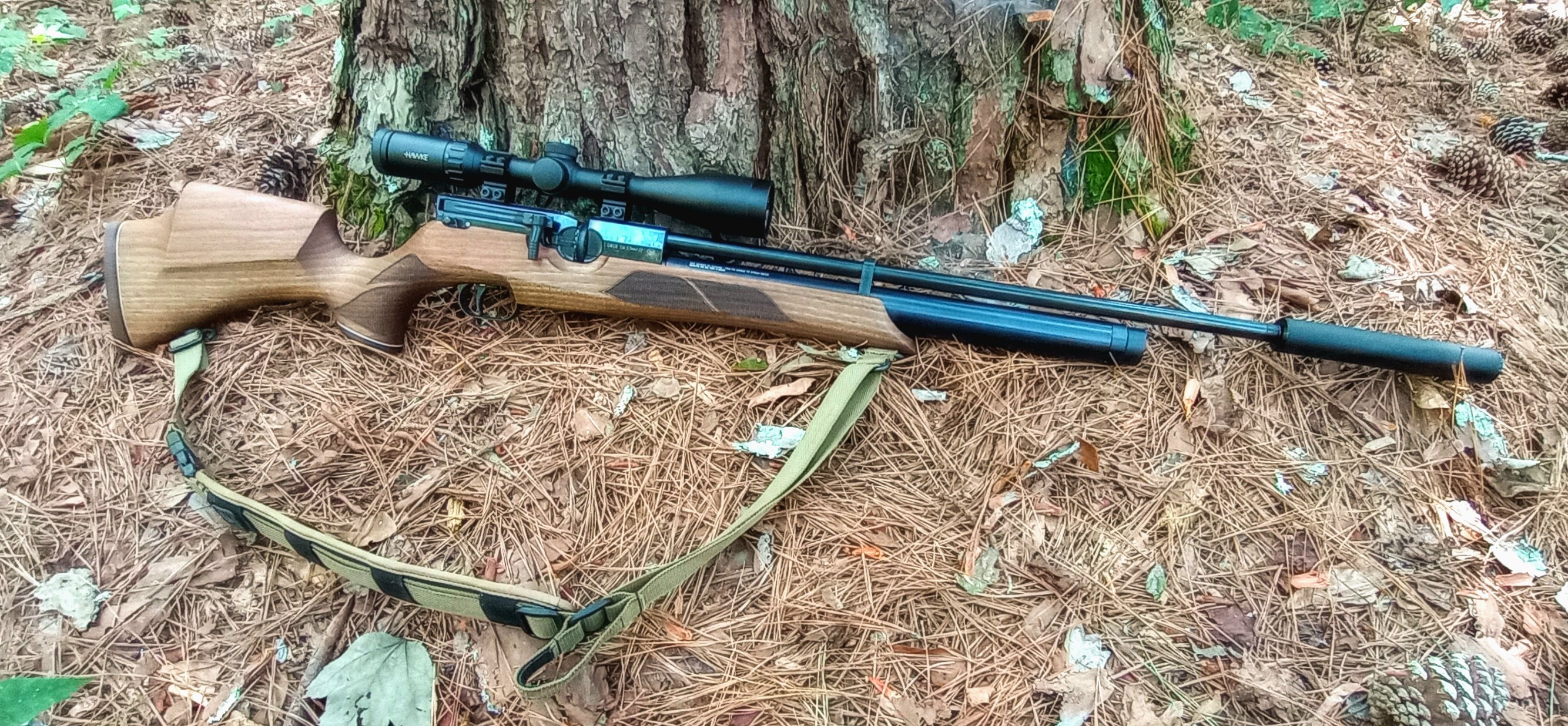

More skill than most have, especially with an HW100 taking squirrels at 100 yards. Candidly, I wouldn’t even consider a shot at 100y. My HW100 .22 Carbine shines at 15-40 yards, for backyard squirrel pesting and paper target shooting. I realize there are excellent long range marksman that will do this at 100, not me!

Three magazines would be more than enough for me also with the HW100. I have the 410mm barrel on my Carbine.
I get about 32-36 shots now with the 18.1 flying at 812-825 FPS. I think the reg is about 115 BAR, since the last tune. Best guess since I don’t have a reg tester.

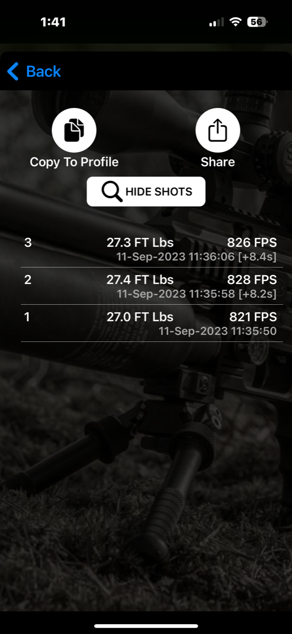

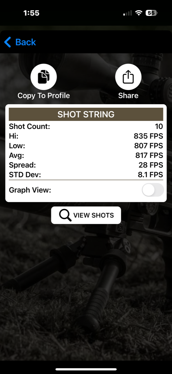

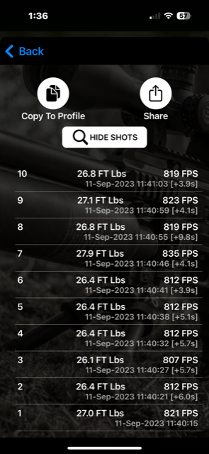

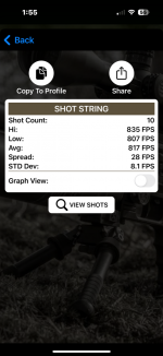

Here is my last shot string from today. I may have had a bad pellet, so I am throwing out the 835 FPS. Also, here are five 5-shot groups at 30 yards at approximately 817-825 FPS.
As an aside, I also ran out the regulator from a 200 BAR start, from approximately 823 FPS to a low of 749 FPS. When I looked at the needle, it was about 100 -110 BAR at the drop off. I believe I had about 36 shots before I saw a steady decline 784, 779, 765, 763, 749. I saved this shot string, but it is not in the pics. This is just FYI....
