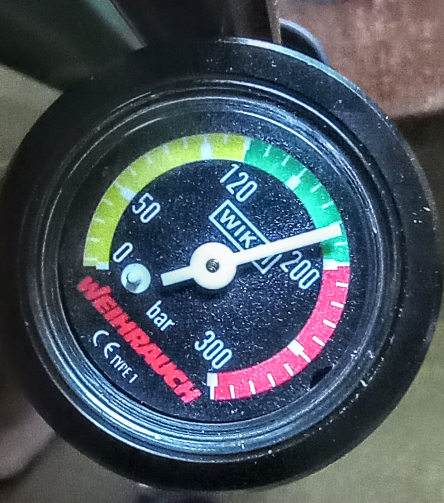

Does your Wika gauge have the same square marks at 50, 100 and 150 bar (these seem to correspond to factory regulator set points) as my Wika gauge in the picture attached?

Here's a picture of the gsuge, I tried to sharpen it as much as possible so the details would show but it is a phone cam pic.

Didn't know it would post giant sized! Looks like there are just standard marks on all of them at 50, 100, 150, 200, 250, 300. Ever 50 Bar.

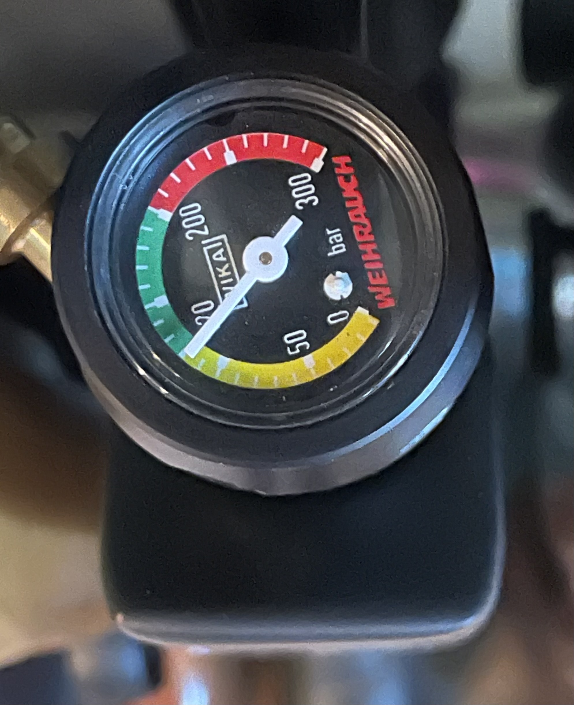

Here is a picture of the UK gauge, note that the ”green“ area extends down to 80 bar.
I think the 50, 100 and 150 marks have significance.
I know that the FAC rifles have their regulators set at 150 bar. A UK friend told me the UK spec rifles are set at 100 bar. The 50 bar may be for the HW44 pistols in the UK - I believe that air pistol power is limited to about 7 ft/lbs there (!).
-Ed

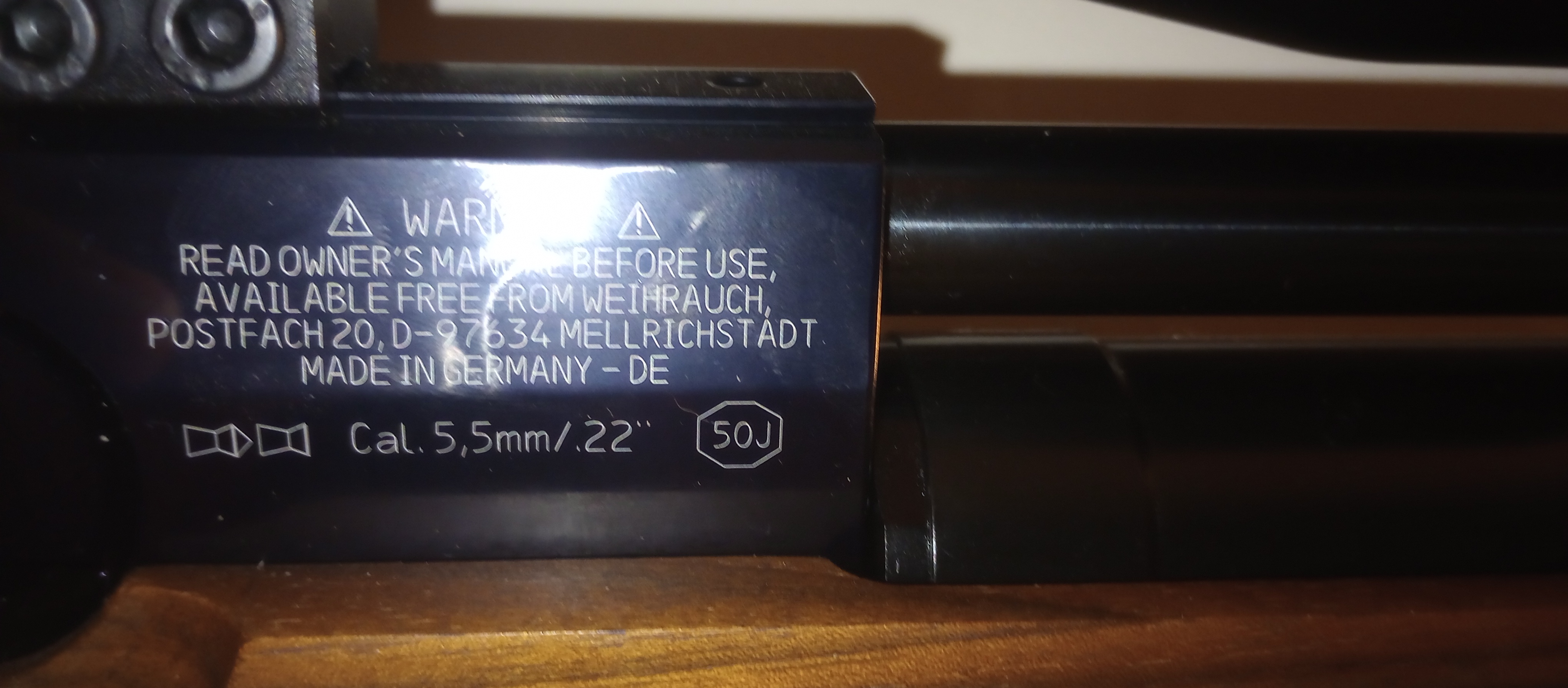

Hey Phil
You must have a different HW100 .22 than my HW 100 .22 Carbine. The max velocity that we tested with a Chrono was about 885-890 FPS with the HST turned up to the max. Dropping it down to 95-97% for a balanced tune put it at about 850 - 860 FPS with the 18.1 JSB. I have since lowered my velocity to about 825 FPS at approximately 115 BAR, when I notice the larger velocity drop. It shoots very accurately at 25-35 yards at this velocity and with the reg at 115 BAR approximately. Don’t have a reg tester to be precise.
Do you have some newer more powerful version that just came out? I guess I am surprised you are getting 975 FPS with the JSB 18.1g, as I thought their .22 calibers were 28-30 FPE. I am asking because I did not think Weihrauch designed the .22 calibers to shoot that fast. The tech at Air Venturi and I had a conversation about this when he was fixing / tuning my gun recently. Yours is an anomaly.
In any case, I kind of agree with both Ed’s in this thread, in that I believe slower is better and just as accurate, with better shot count for the .22 calibers. But, you seem to like it shooting hot, so your factory setup works for you.

Apparently I am one of them ol' power lovin' Muricans. 🤪 This velocity works wonderfully for squirrel hunting, the trajectory is so nice and flat. I can zero at 43 yards, the pellet is only about 3/8" up at it's highest point, then it's simple to use a Mildot reticle for holdover for longer distances. The regulator worked fine with a 220 Bar pressure, giving greater than 28 shots if desired, although two full rotary mags seems like a good refill point. With our bag limit being 8 squirrels I'd have to be shooting mighty poorly to run out of air on a hunt before limiting out.
The hammer spring pressure and regulator aren't as easily adjustable as say an FX Dreamline but the adjustments are there with a bit of work for those for wish for lesser power and greater shot count. The 100 is a very versatile rifle. It's a little on the heavy side but many PCPs are.
