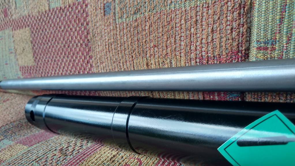

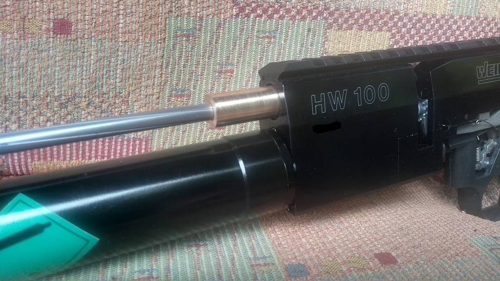

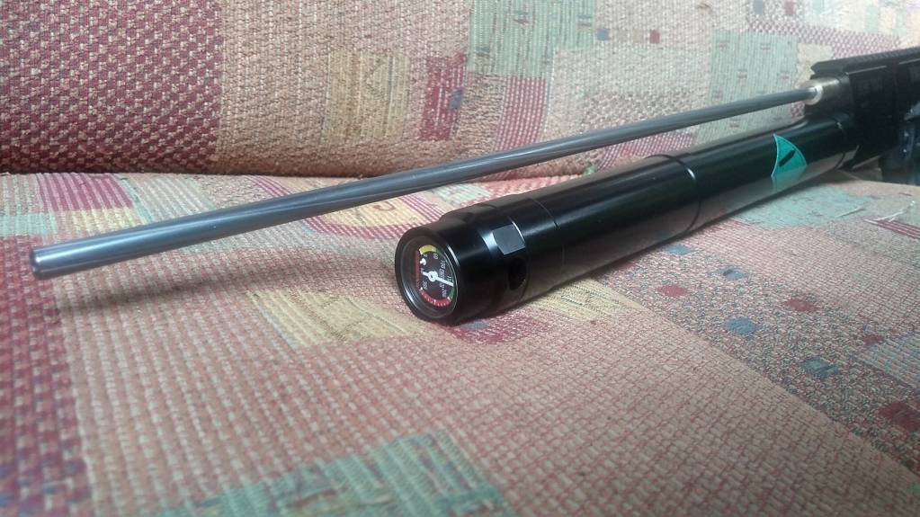

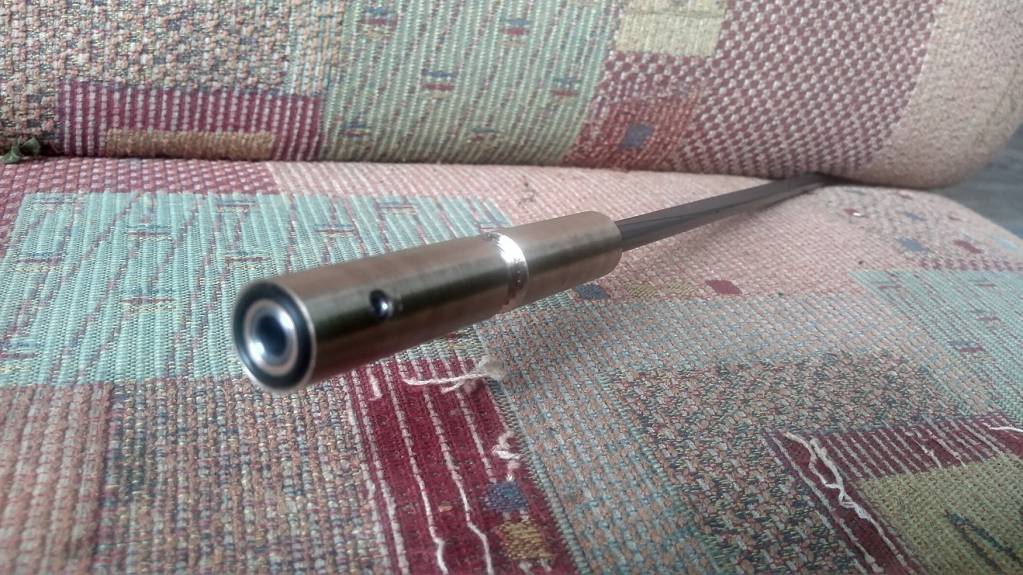

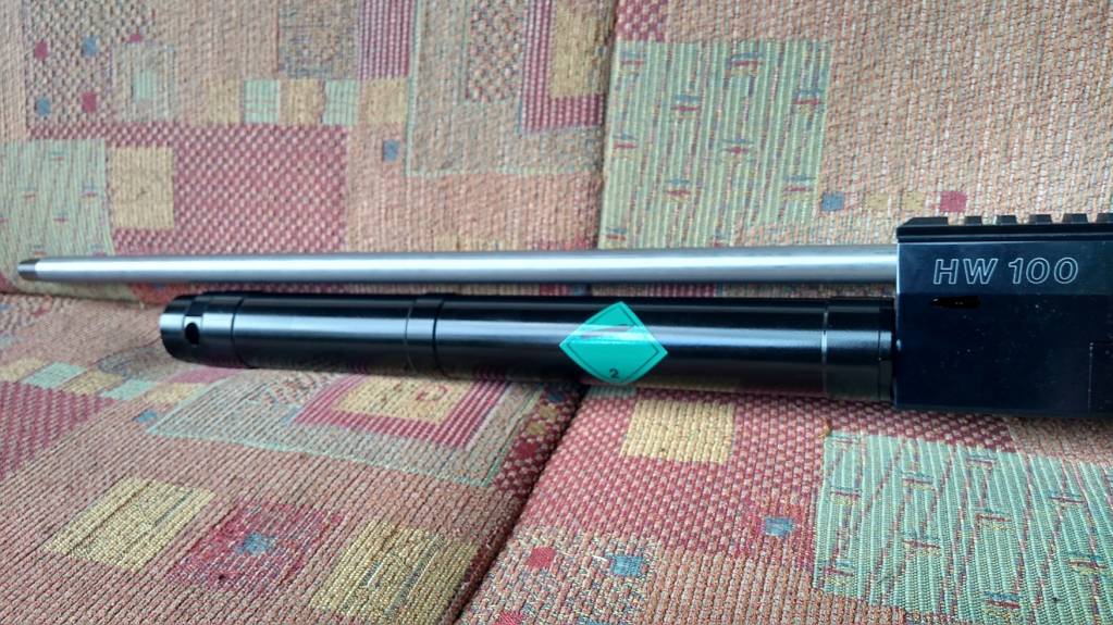

i took the liner from my dreamline .177 and married it with my hw100

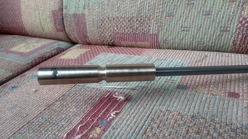

i made a brass adaptor with o-ring groove and two grub screws for clamping the fx liner in place
the brass adaptor is glued (loctite) into the steel pipe

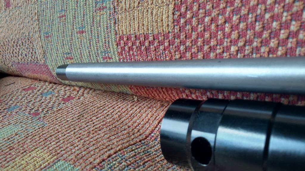

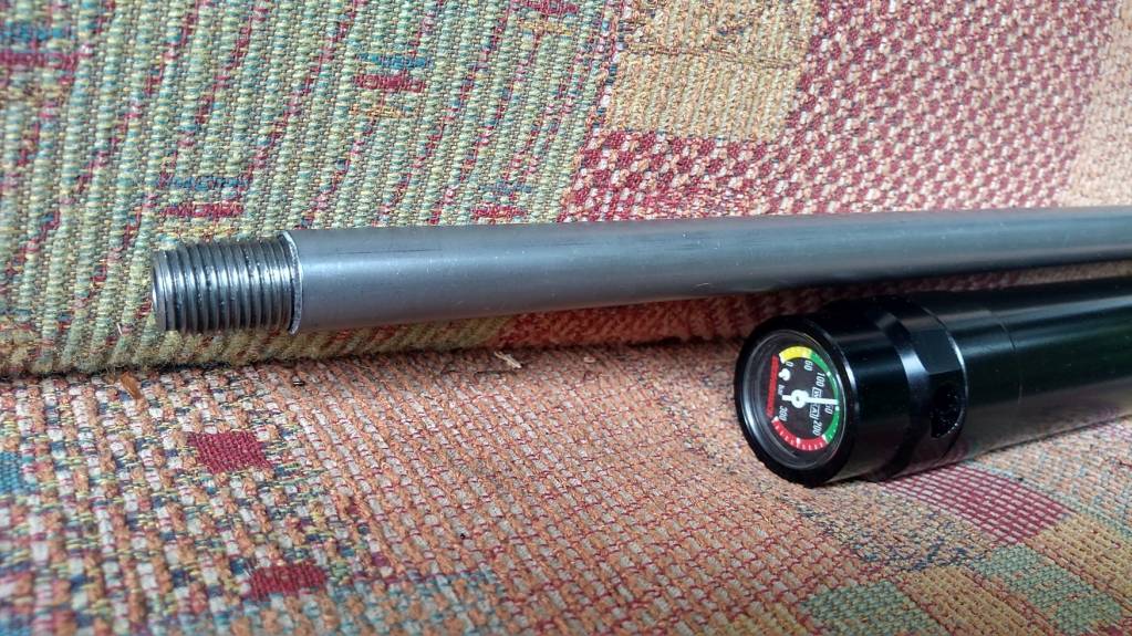

the seamless cold-drawn precision steel pipe has inner threads 1/2" UNF at the end to screw in the fx liner clamping nut
now its time for testing and to add a carbon sleeve because the steel barrel is uncoated.
