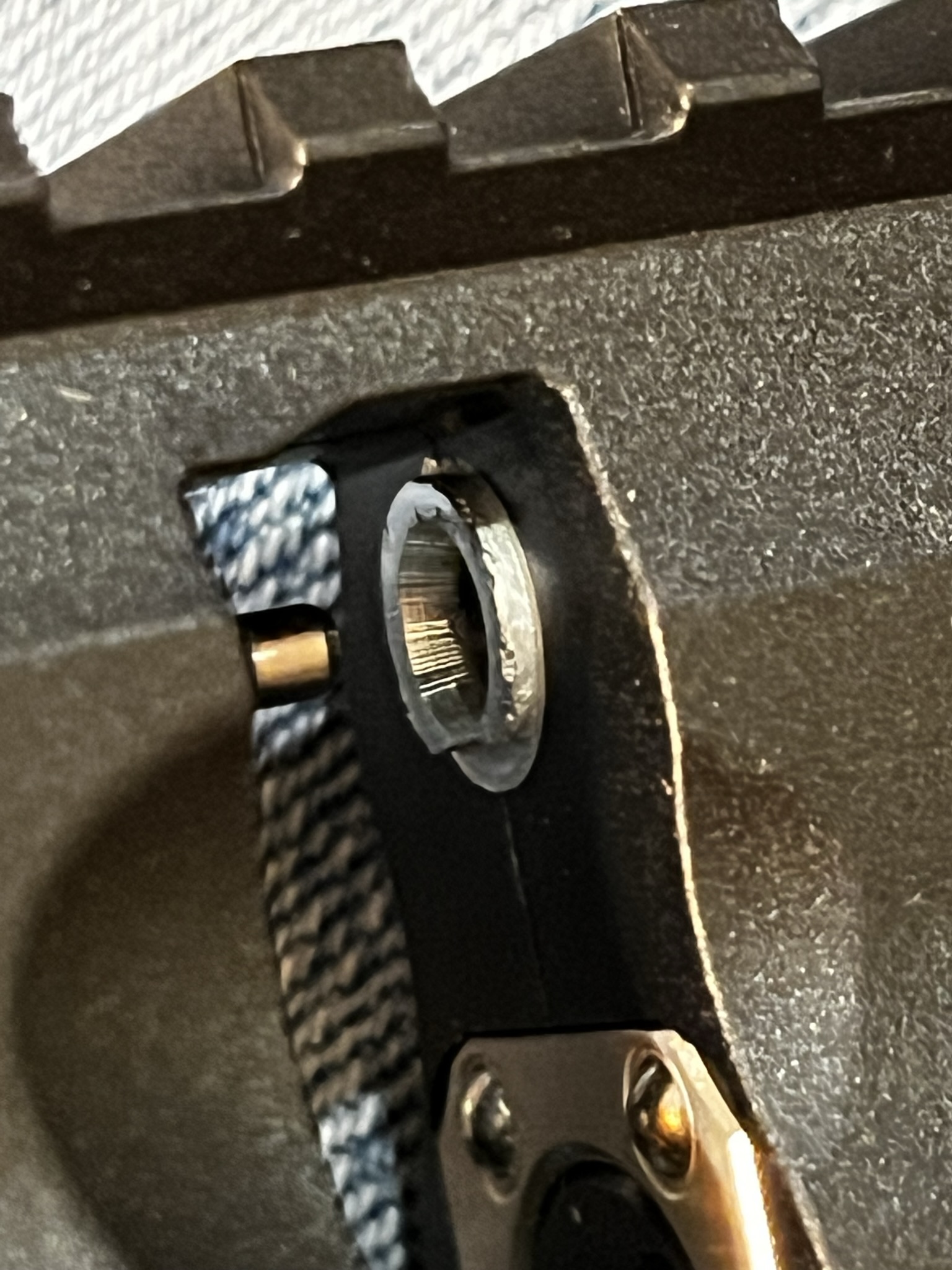

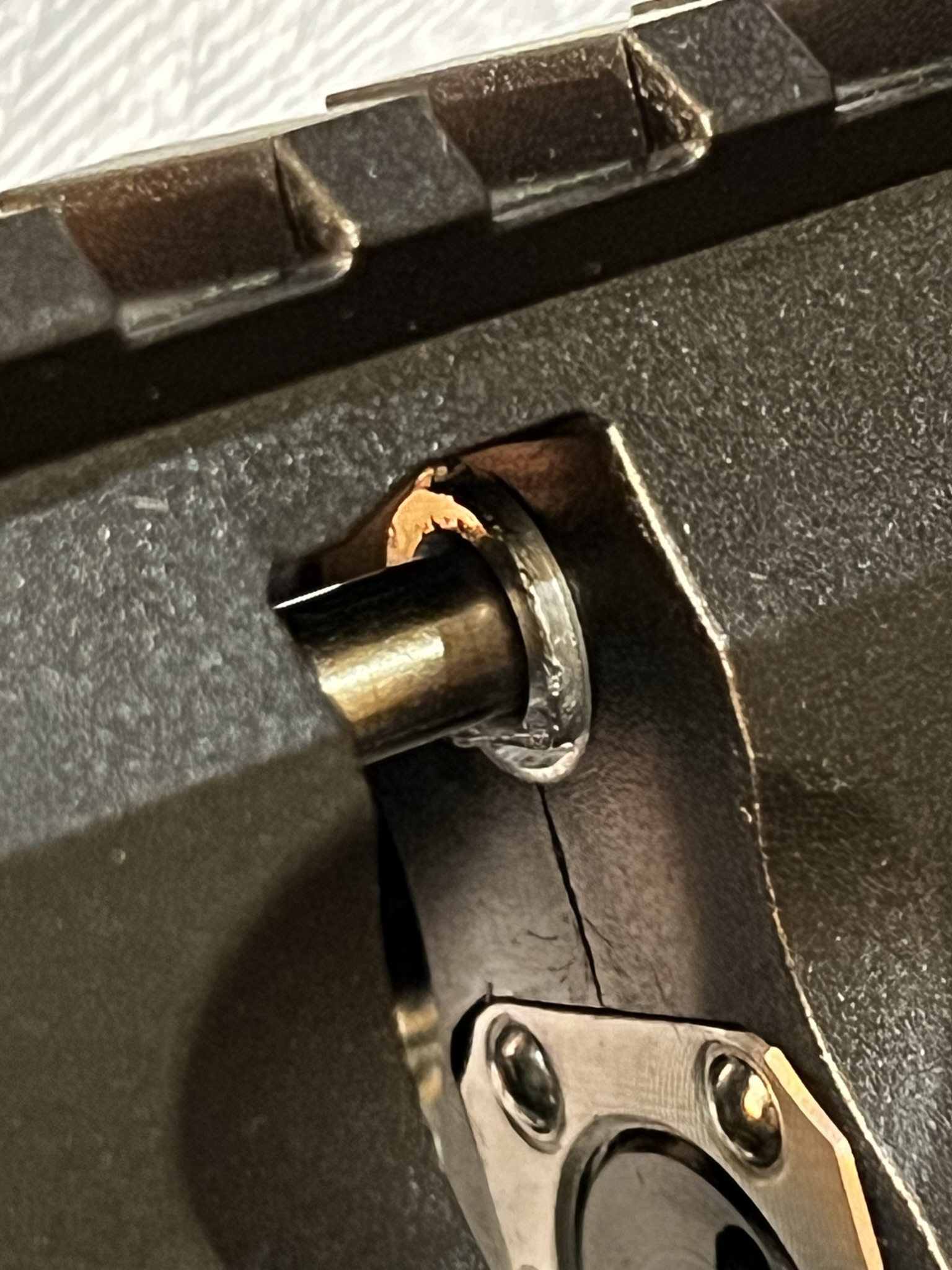

I recently purchased an HW 44 and the outer edge of the breech looks like it’s damaged. The vendor indicated that it is normal. It certainly does not look like precision German engineering to me. Would someone take a look at their pistol an see if it has similar marring?

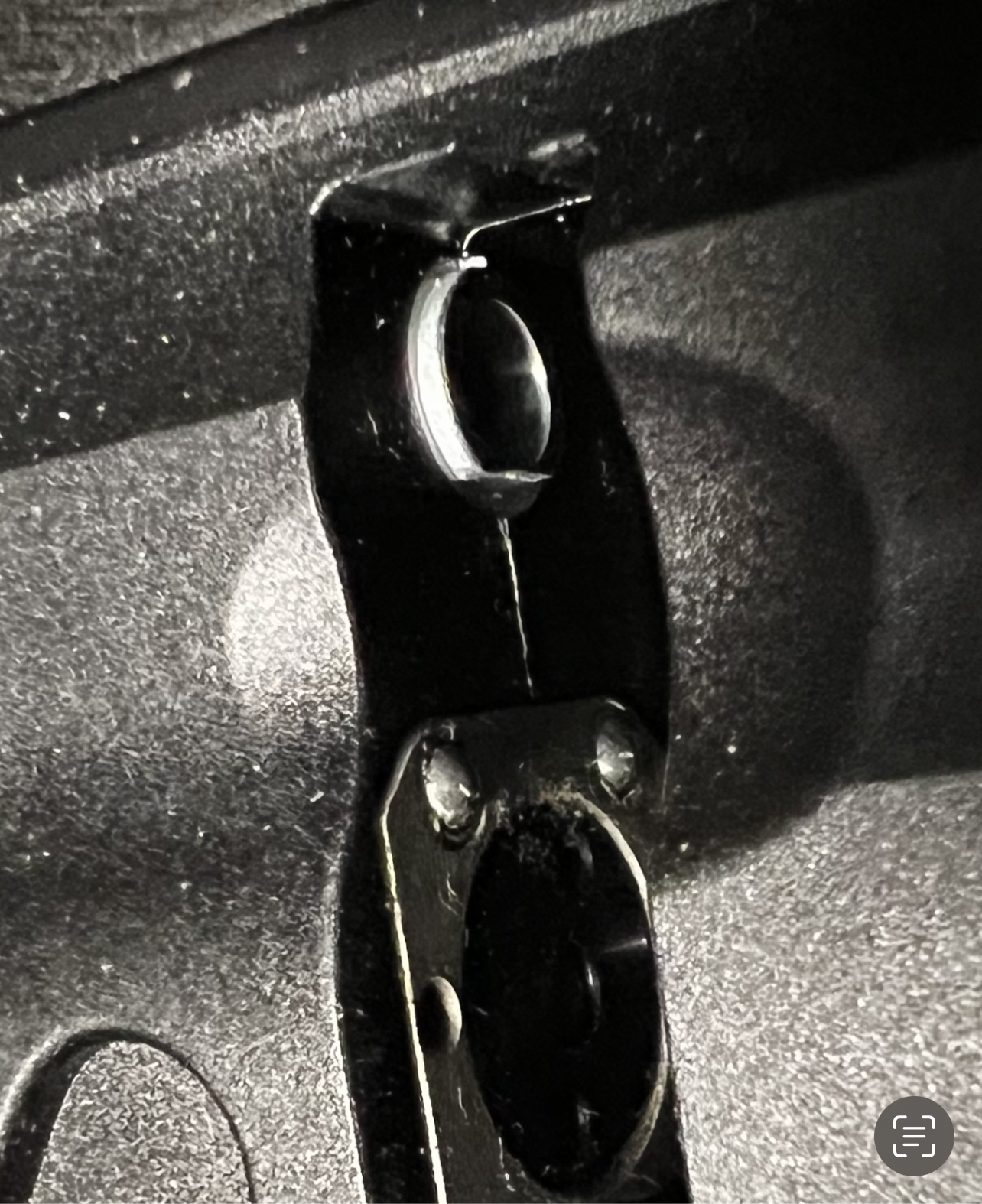

Agreed, BOTH the outside and the counterbore for the lead-in are seriously bad.
The lead-in, is badly chattered, like either the barrel was not tight during the machining, or the cutting tool was not tight, or the tool needed sharpening, or...was not turning fast enough.
And the outside looks like plyers or vice grips got ahold of the outside diameter. That's NOT normal either.
If you bought that gun new, I'd seriously think on returning it. You bought a...well used gun, with some hard handling.
1 - Remachine the barrel, 2 - replace the barrel, 3 - return some of your money so you can get the barrel remachined yourself, 4 - or return the whole gun.

That looks terrible. The inner edge looks like someone tried to open it up too - look at all the chatter marks in there. That's definitely not a new pistol you got there. Wanna out the vendor?

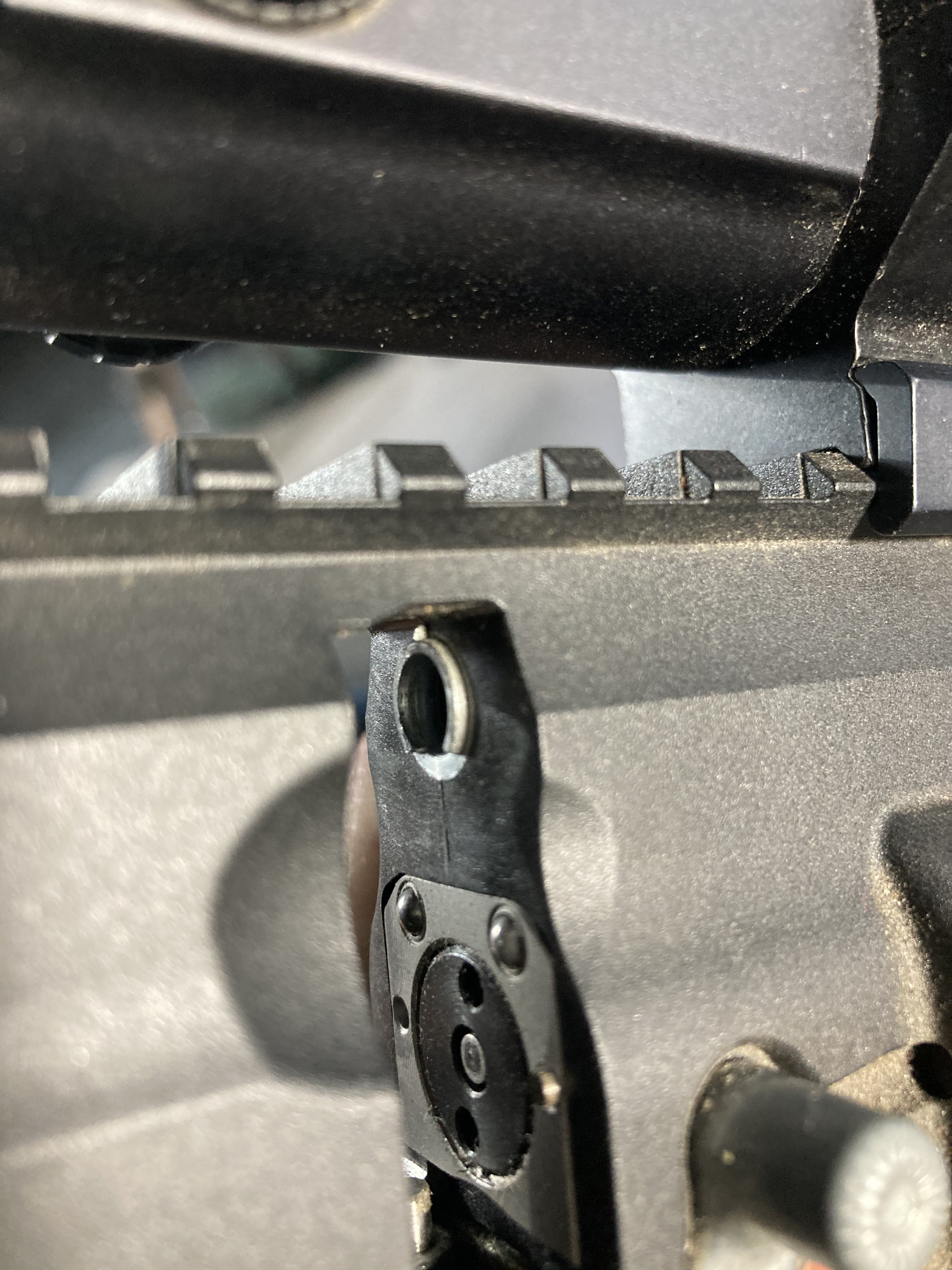

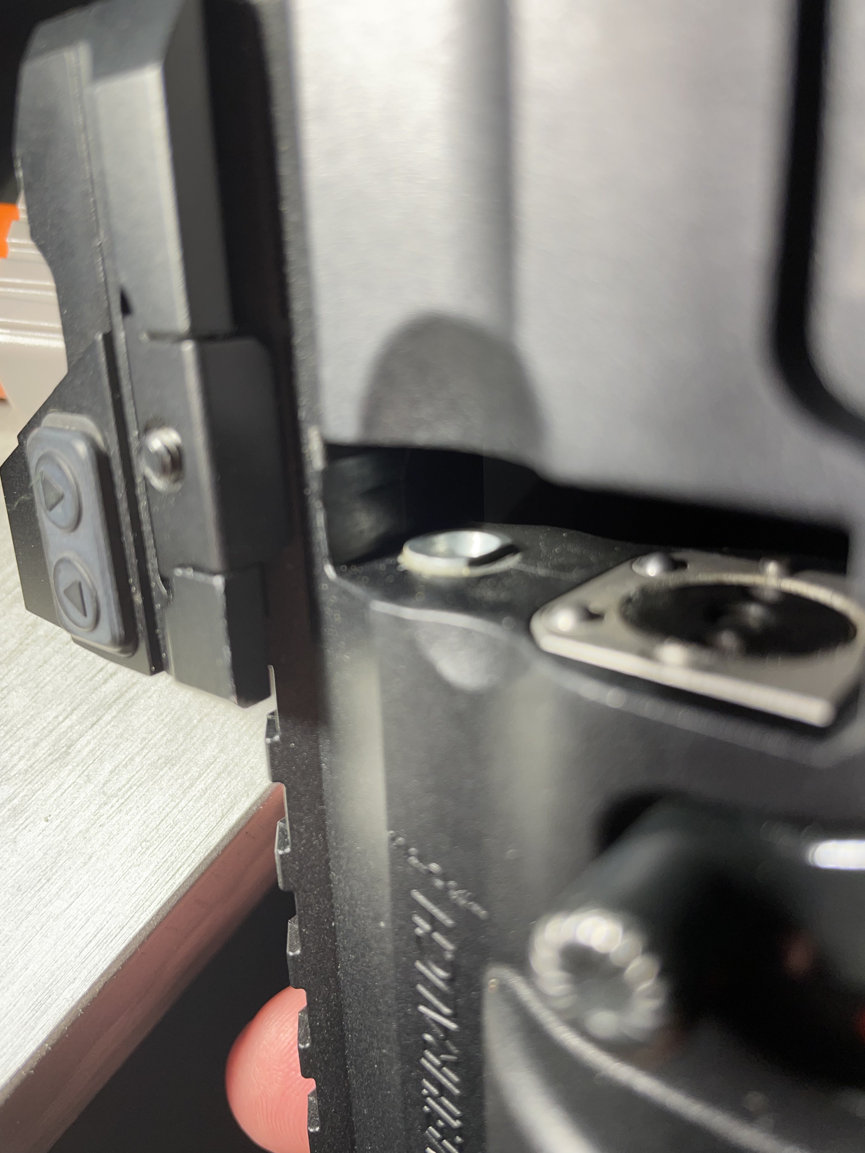

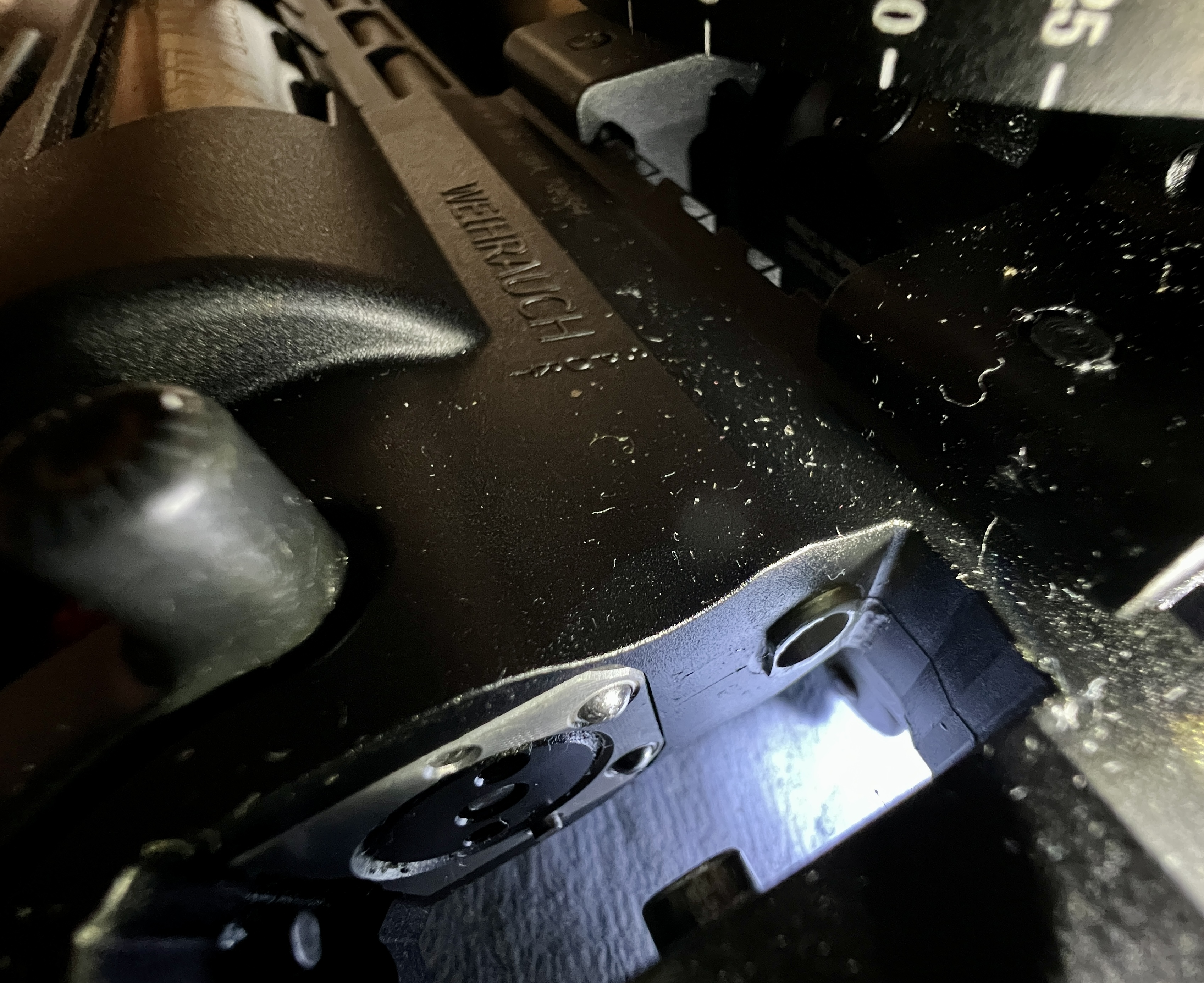

Not normal. Here’s my two HW44’s and they are not damaged like that.
I’d demand a new pistol, and if they don’t agree tell them you asked here and have pictures to prove it’s not normal.

I have the HW110 - the rifle version.
That damaged breech port is not the end of the barrel - at least not on the rifle. The barrel actually screws into the breech - it is threaded.
It would be nice to find out is the damaged part that the original poster showed is removable - as it contains the breech seal O-ring. If you could remove it, it sure would make replacing that breech seal o-ring easier.

Thanks to all that responded to my initial post, especially those that provided photos.
The vendor replaced my HW44 with a new one that appears to be in excellent condition. It’s concerning that I had to use this forum to this to get a favorable outcome. Had I not been a member of Airgun Nation, It appears I would have been stuck with a defective product. My only complaint at this point is I am out $38 in shipping cost for the return. They said they would include two tins of pellets to offset the shipping, but that didn’t happen.
