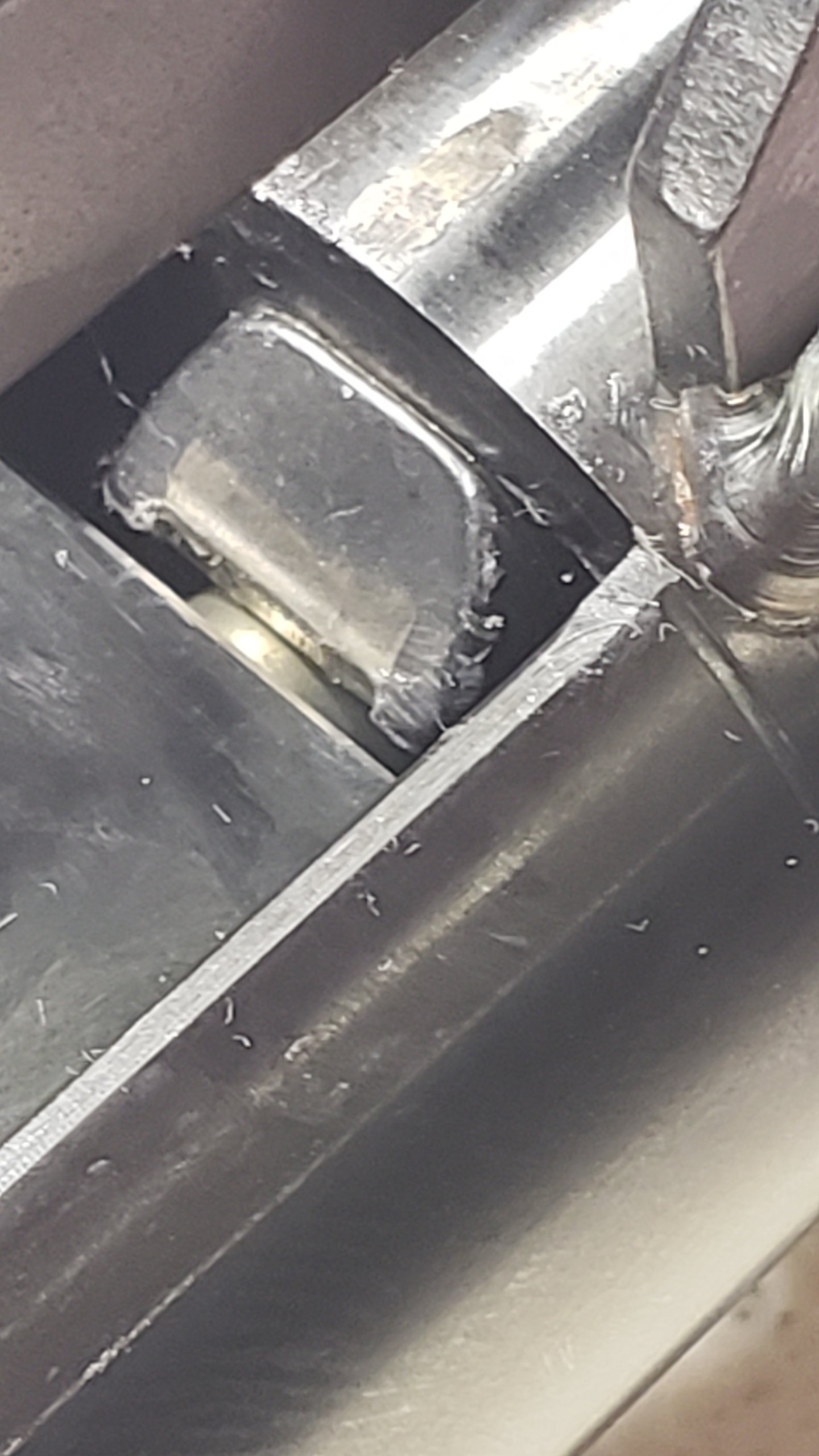

HW30s needs lots of moly or equivalent around and behind the ball mechanism. I accidently washed the grease out of mine and things went crazy. To open it I would have to hit the barrel hard, and to close it I would have to slam it. It would make a little chip too when it closed (dry metal on metal). I called AOA and they laughed at me, told me to pack it with grease really good and make sure to get plenty behind the ball. After that it opens and closes with ease, a gentle pull is all it takes.

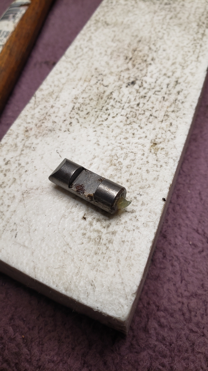

Only put good Moly grease on the chisel detents. Oil won't protect it enough. There's a tremendous amount of friction there point to point. I've seen were the fixed chisel wears away and the gun wont lock up at all. The fixed chisel is brazed into the compression tube and isn't replaceable. If it wears out you have to buy a new compression tube $$$$ on the 50s.

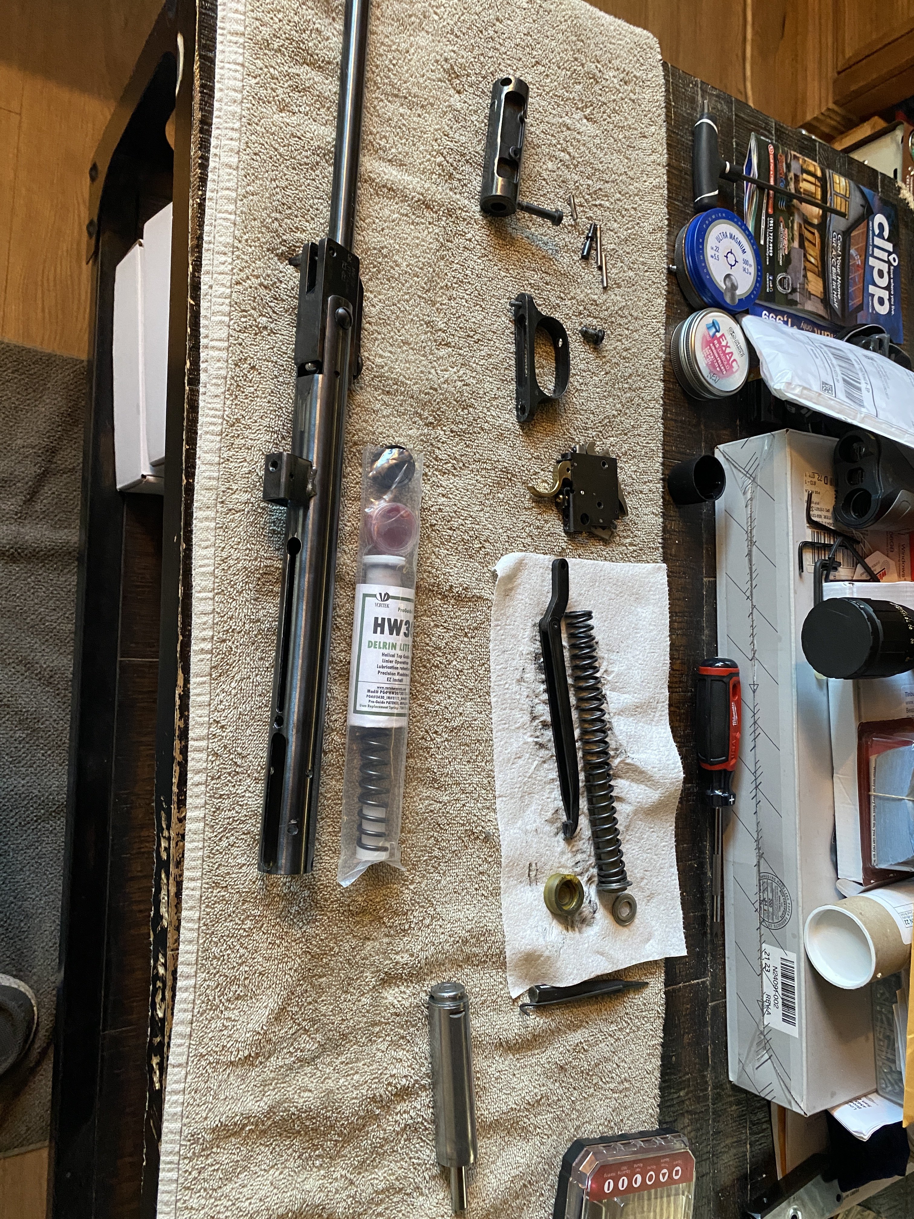

You can oil the chisel bore. But that usually makes a mess and washes out the moly. It's not a bad idea to remove the chise, polish the bore and spring ends and reassemble the whole thing with moly. I usually do it on every tune and the new guns haven't been great. The bores are roughly machined and I usually find swarf and rust.
Got the hw30 back from AOA. Works perfectly. Their fix was to oil the ball detent to work it loose. I had done that prior to shipping it back, but I guess I didn't wait long enough for the clp I used to seep in. Now very, very smooth open and lock. No more compromise of the breech which had been leaking air when firing. Very happy. Been using Crosman vantage and remington impact elite NP's while it was gone. Those definitely have more power and a much harder cocking stroke and violent firing cycle, but the hw30 is such a fun plinking gun you can shoot all day. HW50 is probably my next step up in power, unless someone suggests a nicer model.
