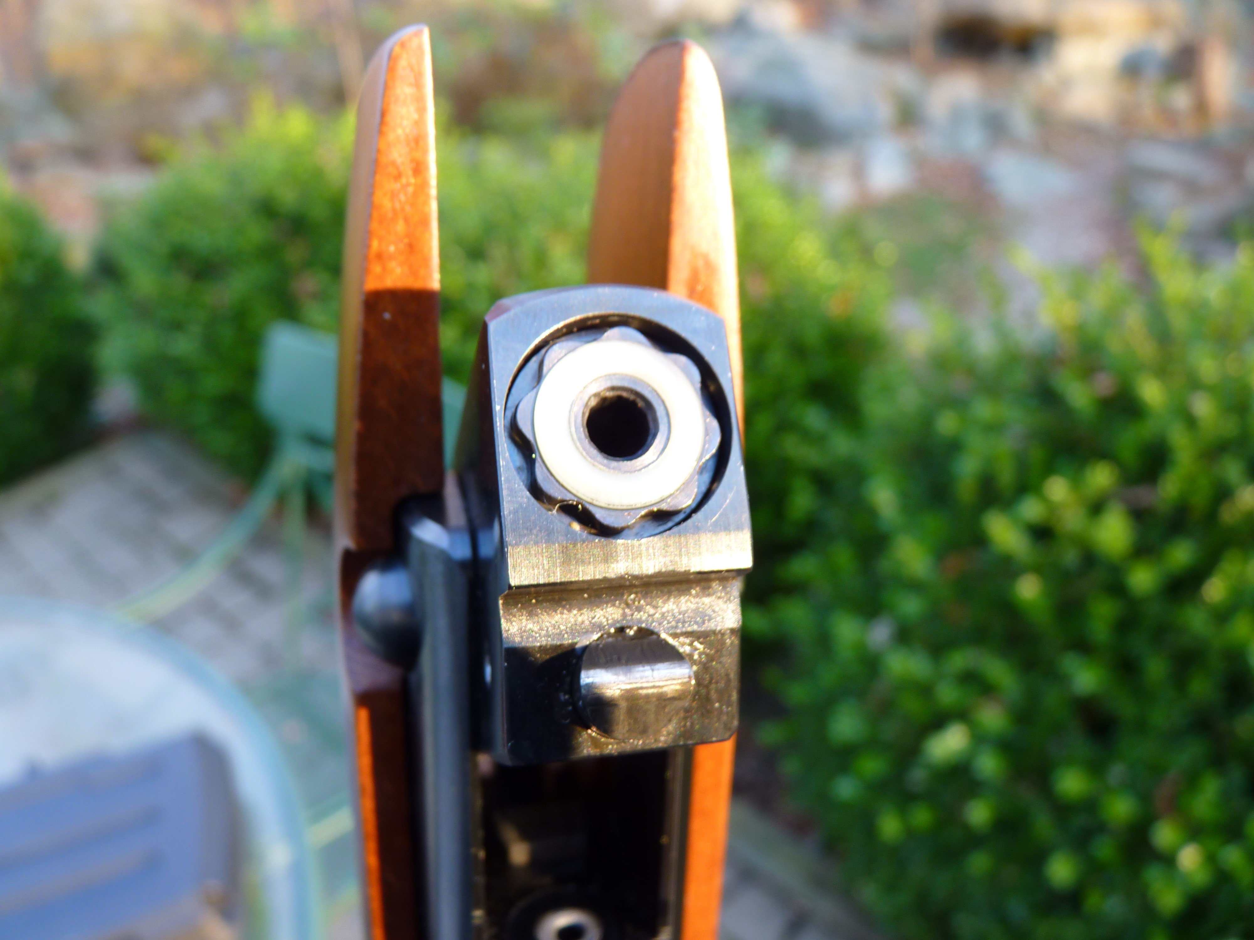

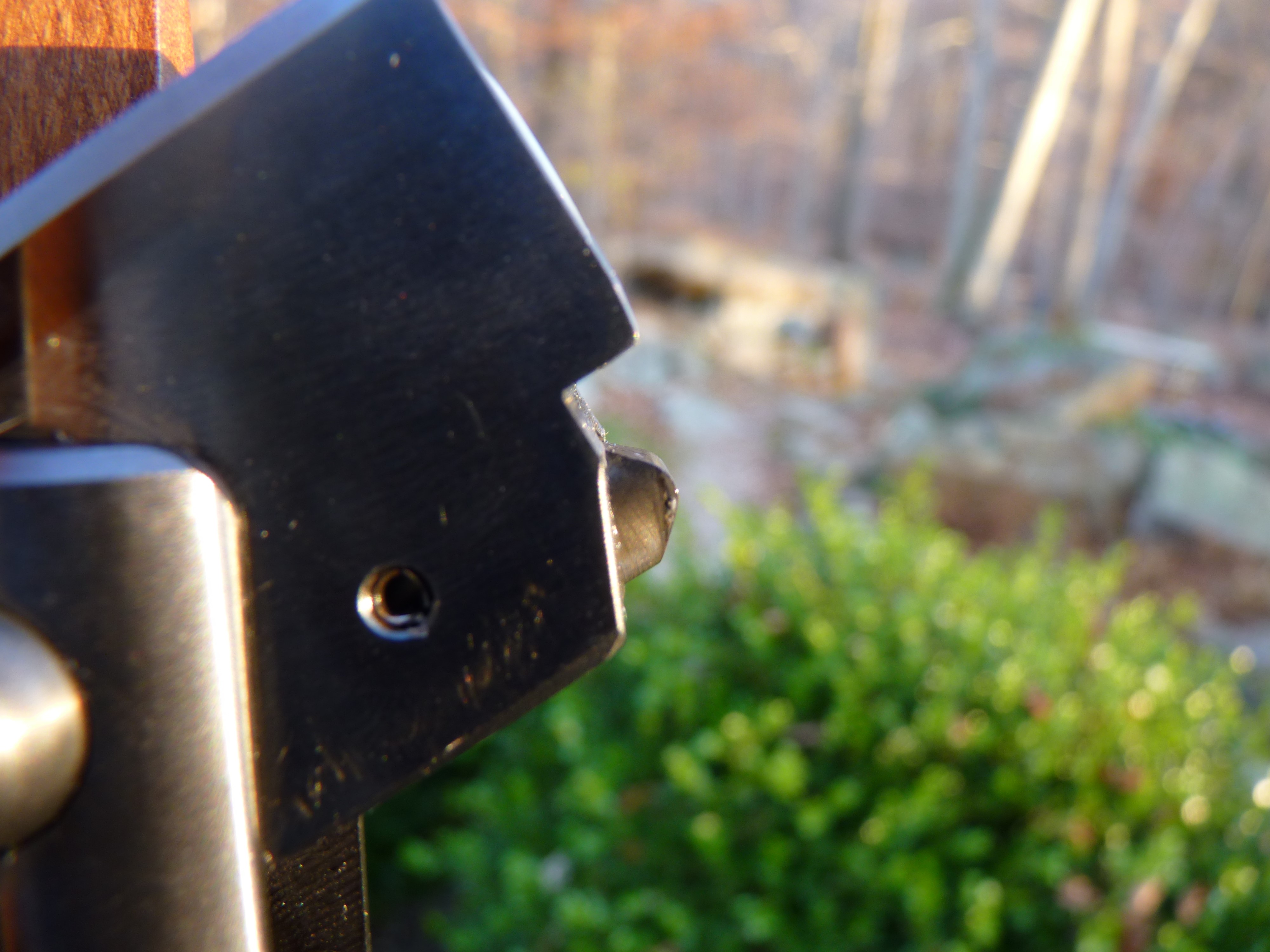

@cankiller: Could you be more specific about the problem with the ball detent? Include any pics w/a description of the issue if possible.
Thanks in advance from a new (AoA-acquired) HW30S owner :)

Can't do it because it's back at AOA for a fix. Problem was I could not close the breech. Not only not holding closed, but could not physically close the breech fully. Just guessing the ball detent came out too far. Will update once AOA gets back to me.
The ball and spring are staked into the breech block. They aren't removable. The only thing you can do with them is to oil them and exercise the ball to allow the oil behind it.
The ball locks the breech in place against a steel dowel between the forks. The ball pops over and holds pressure against the same steel dowel that locates the breech position. Either the ball wouldn't fully extend, compress and or the pin is damaged.
The ball might not fully extend or compress if it has machining chips, rust or dirt in the ball socket. If there's crud in the socket it may work its way to a bad position again. It may break up and never cause a problem again. Hopefully it's fixed for good.
