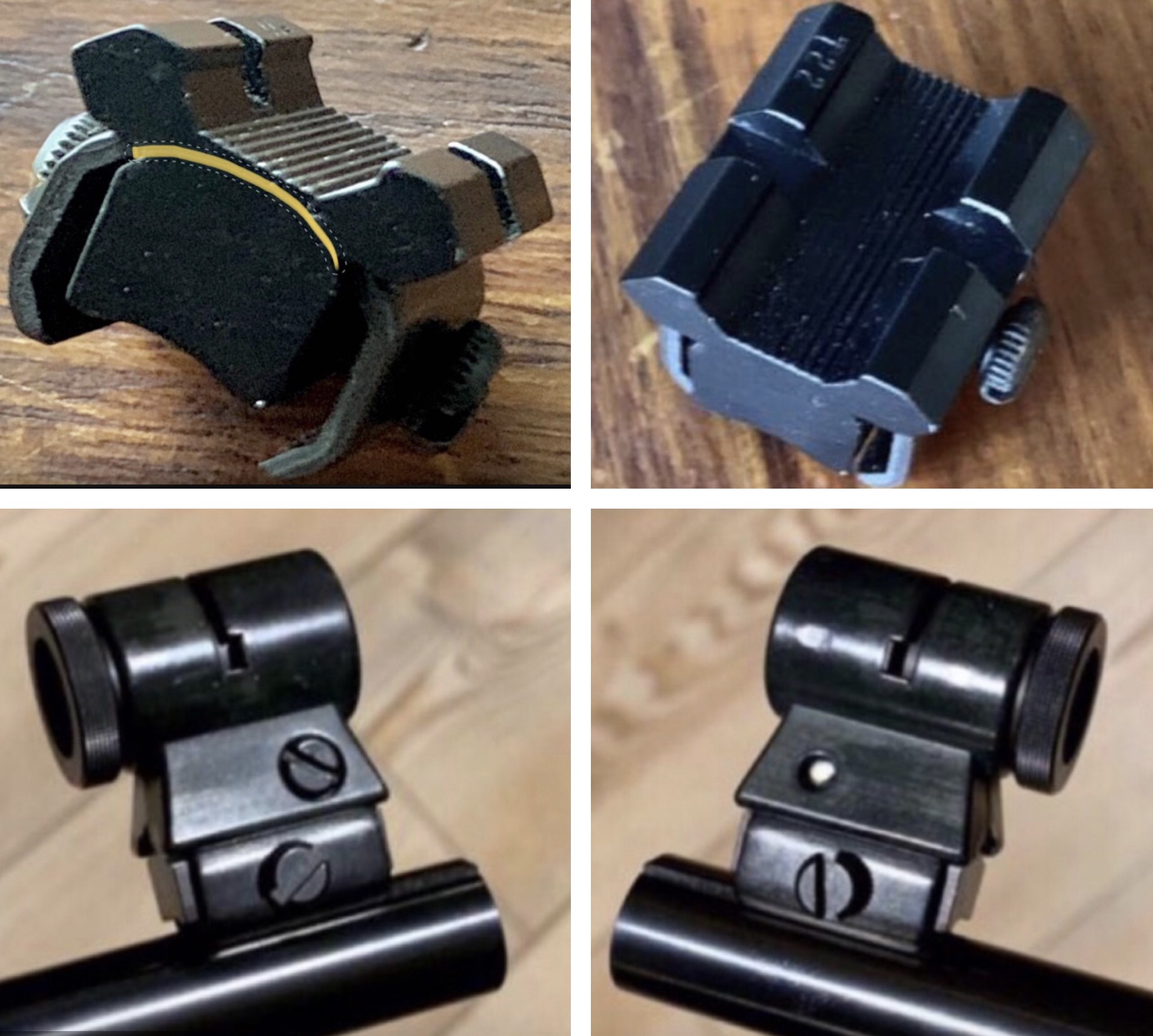

I needed the Weihrauch front sight raised up about 3/8 of an inch. Could not find one anywhere. I decided to make one. When rummaging in my parts bin I came across this “Weaver” dovetail-to-picatinny mount. Plenty of meat on it to grind and leave a 8mm dovetail needed for the front sight. Grind and file down the picatinny rails (dotted/yellow line) leaving/matching the same 8mm dovetail that’s on the barrel.

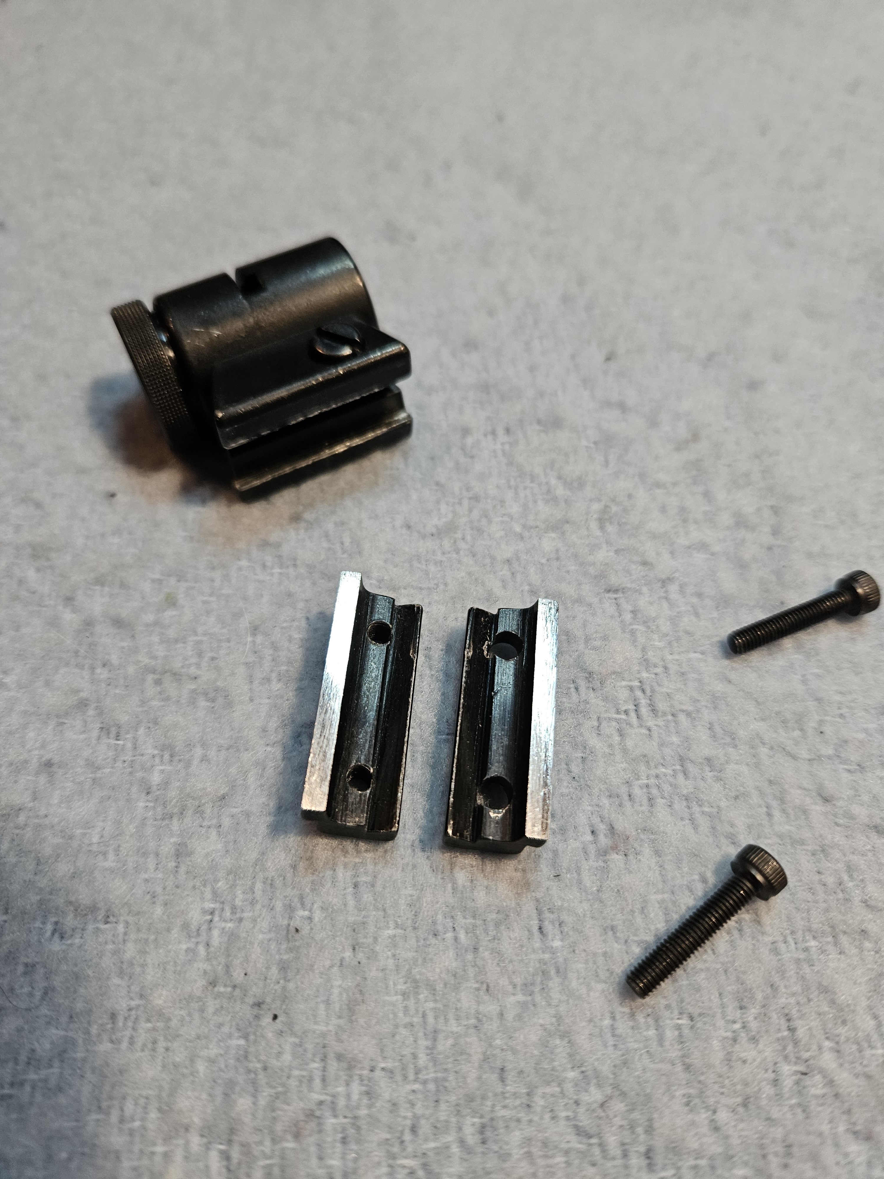

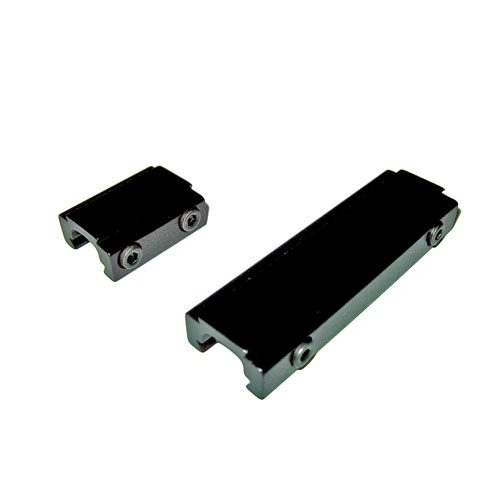

I started with one of these Feinwerkbau risers

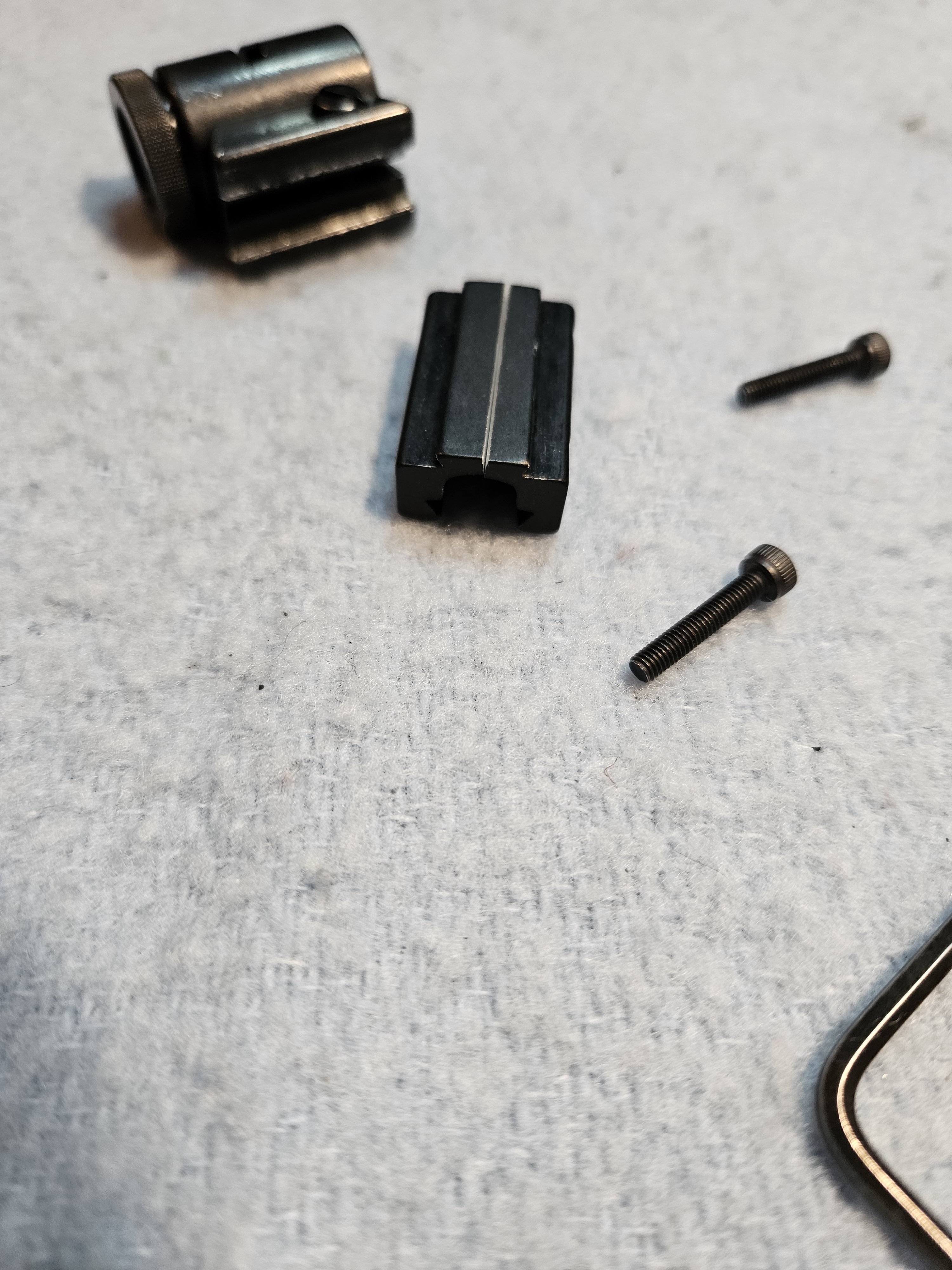

Using the shorter front base, I sliced it in half lengthwise using a cut off wheel in a 4 1/2 inch grinder.
I then cleaned up the cut on a bench mounted disc sander, and proceeded to file the cut edges to reduce the overall width to fit the dovetail width of the Weihrauch globe front sight.
The cut edges were reduced to the point that the Weihrauch sight would fit with a firm press of the fingers. No hammer or beater block of wood necessary, if you take your time and check your fit often.
DO NOT get in a hurry, use good sharp files in good lighting, and CHECK YOUR PROGRESS often. You are trying to sneak up on a good firm press fit with your fingers.

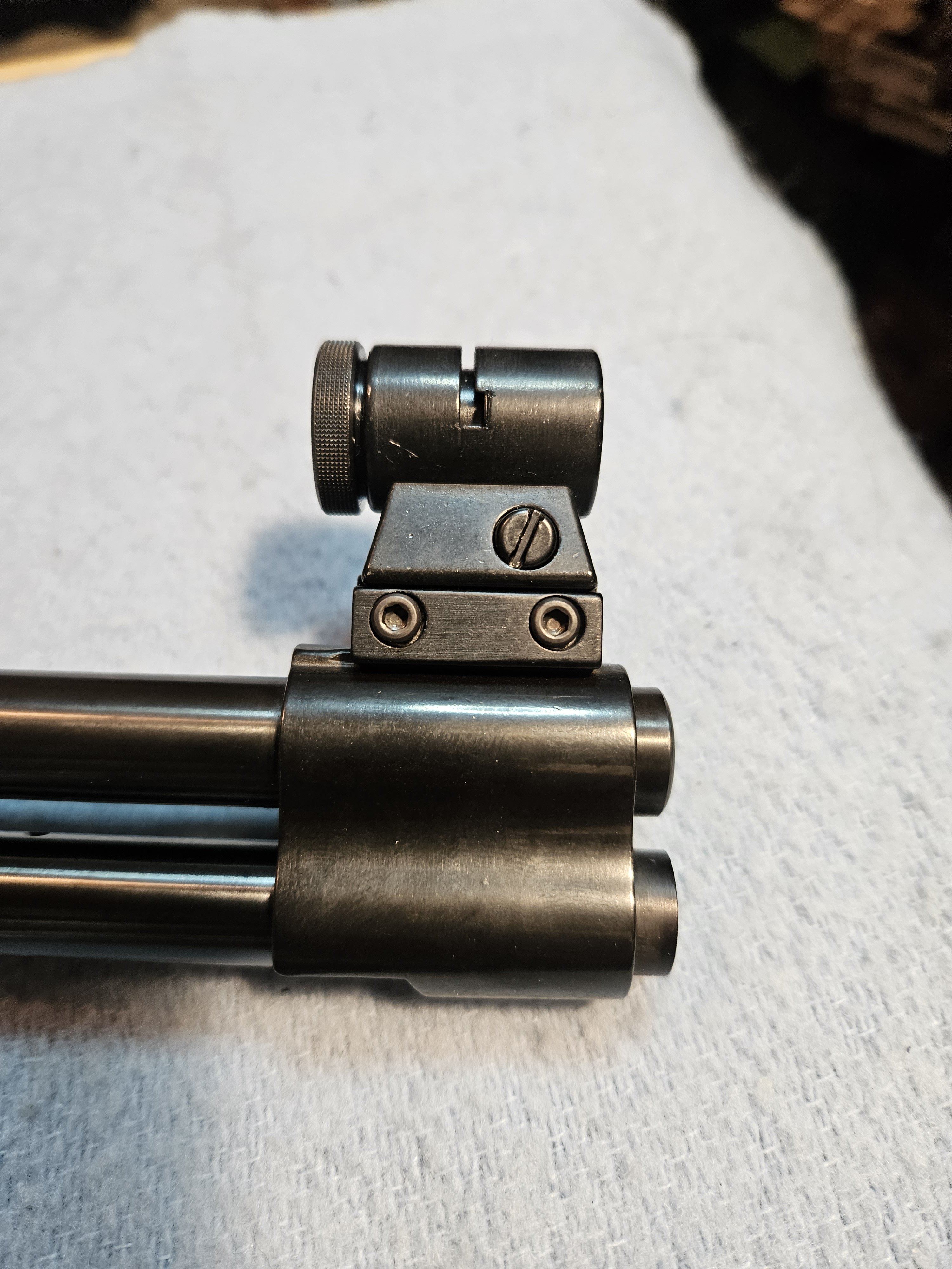

End result

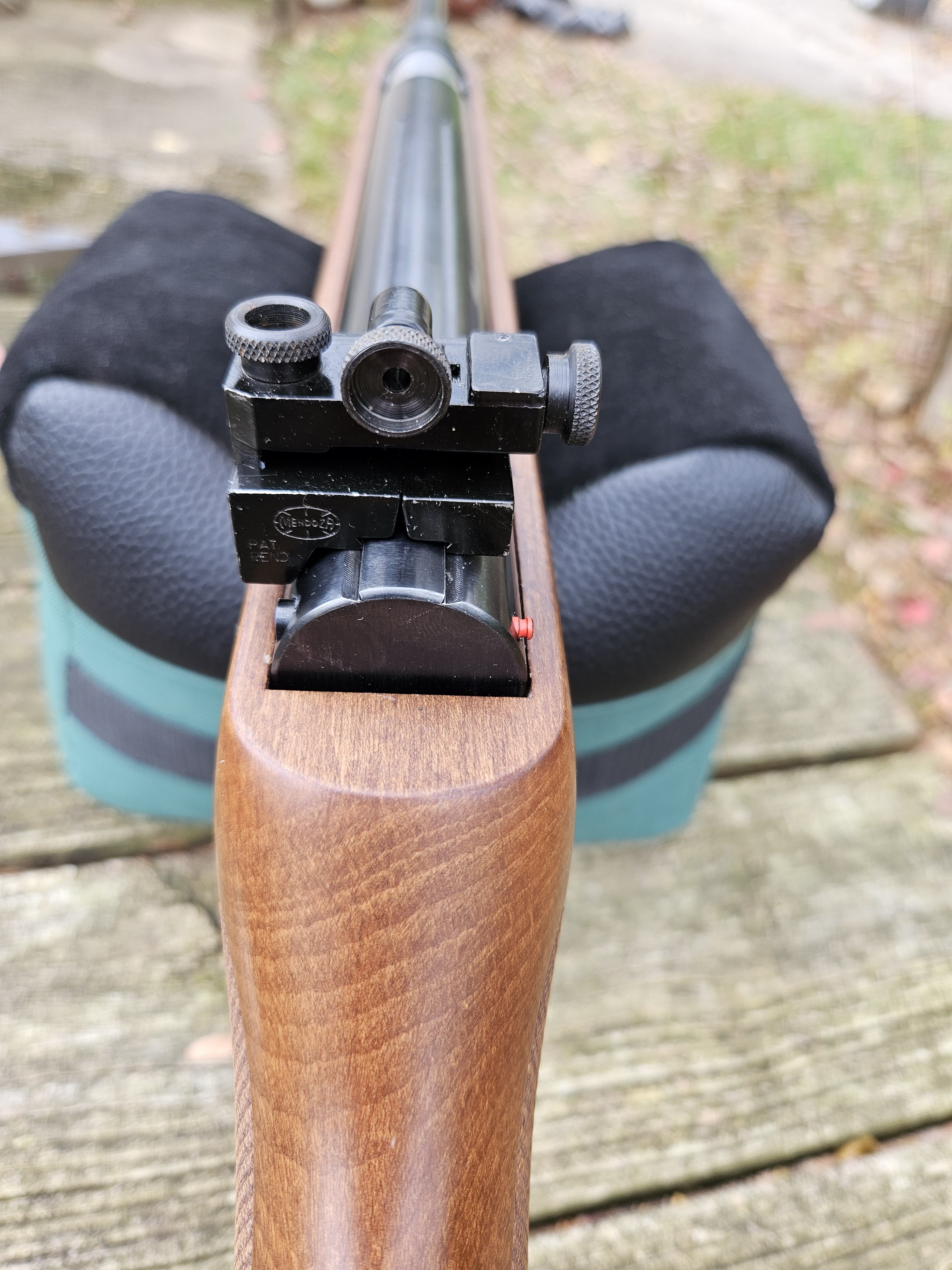

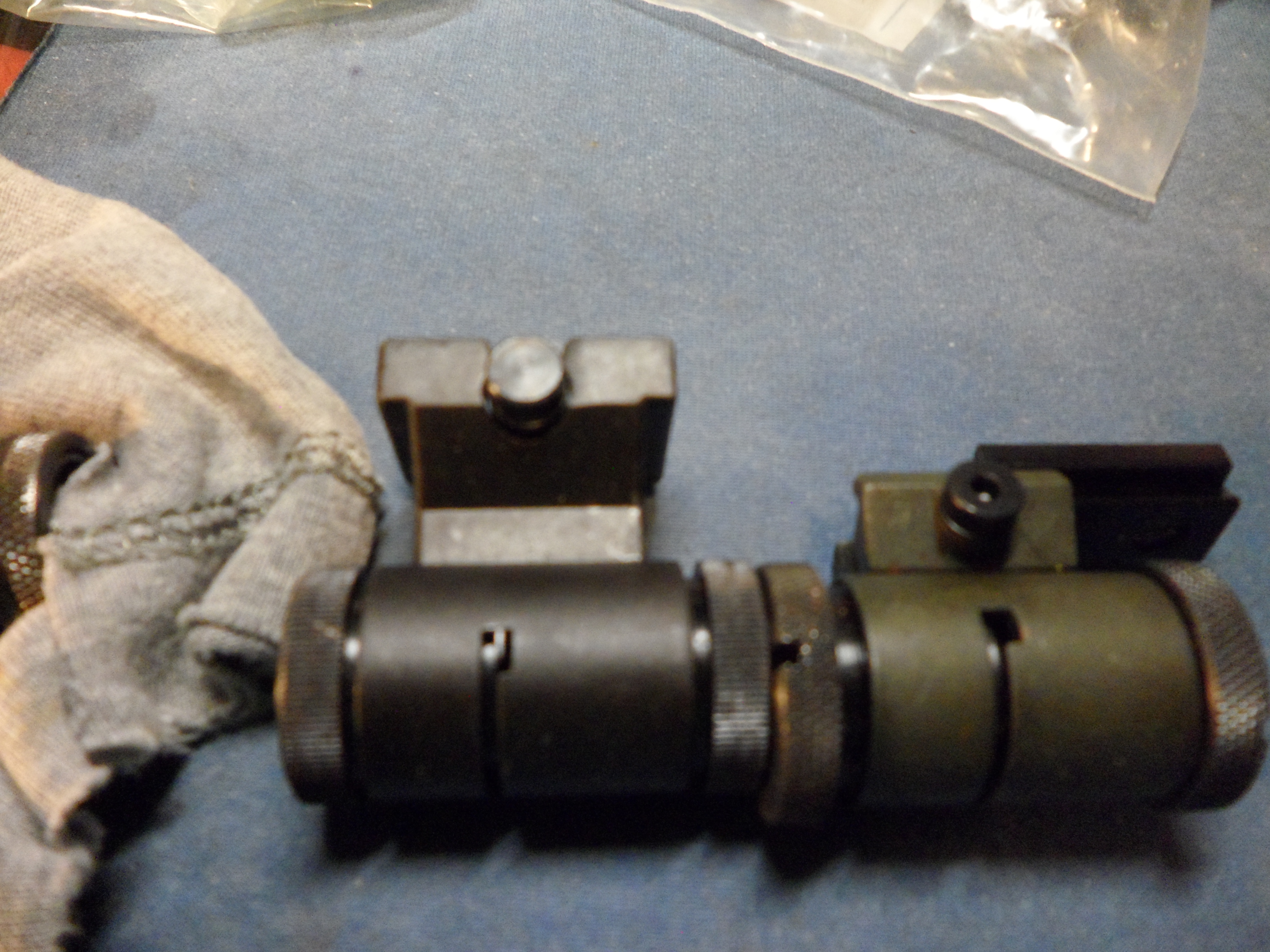

I used an old Mendoza rear peep because of its beefy base and two screw securement so as to avoid the sight creeping back under recoil.
My HW77 is making close to 15 ft. lbs. With 10.3 JSB pellets, and the sight has held tight through a half of a tin so far.
The sight line is a little higher than I prefer, but the alternatives involved either reworking the factory stock, or buying a new stock.
Minimal outlay and some time spent fitting parts together avoided those alternatives and the head position with this set up is quite comfortable for me.

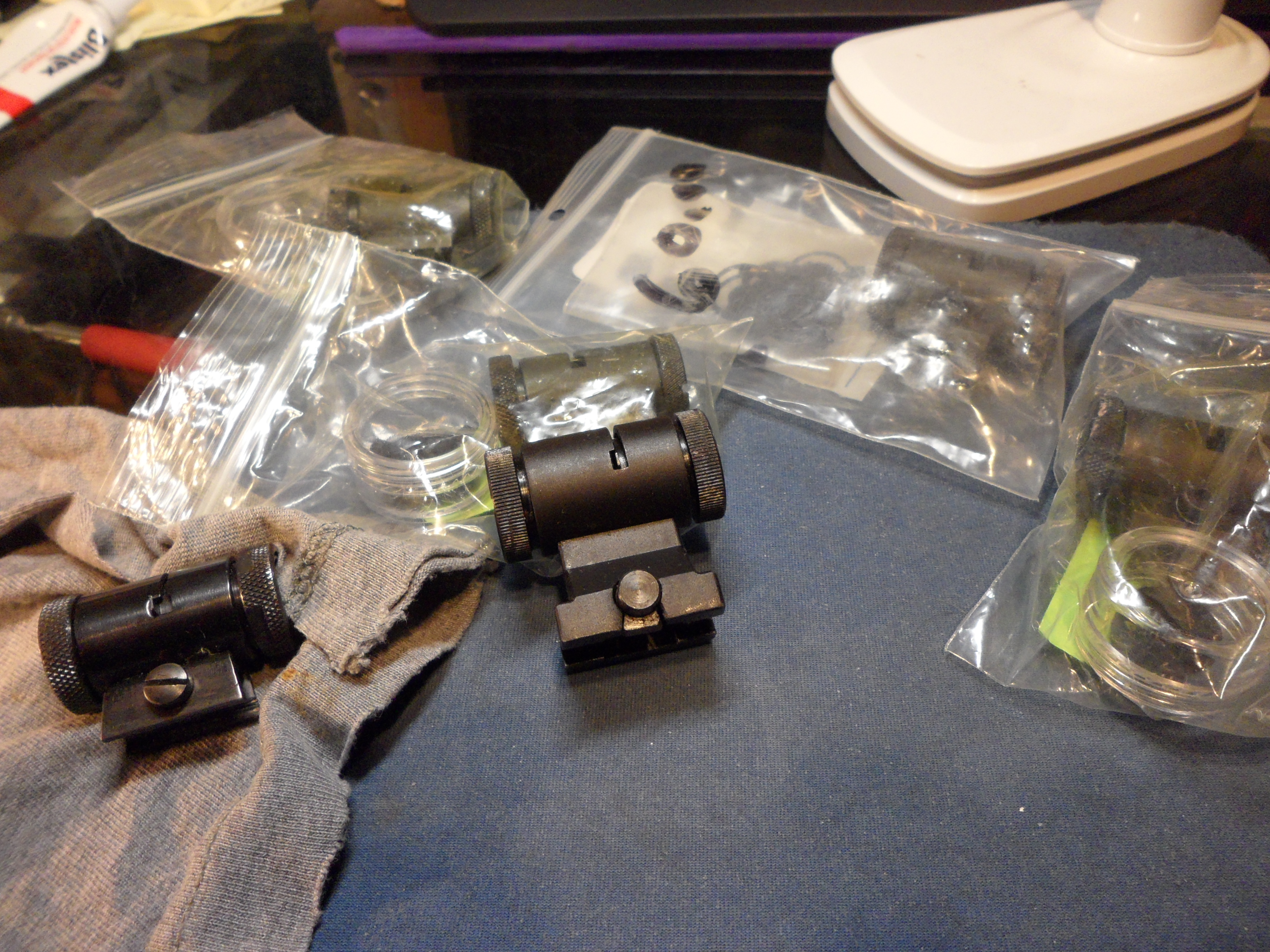

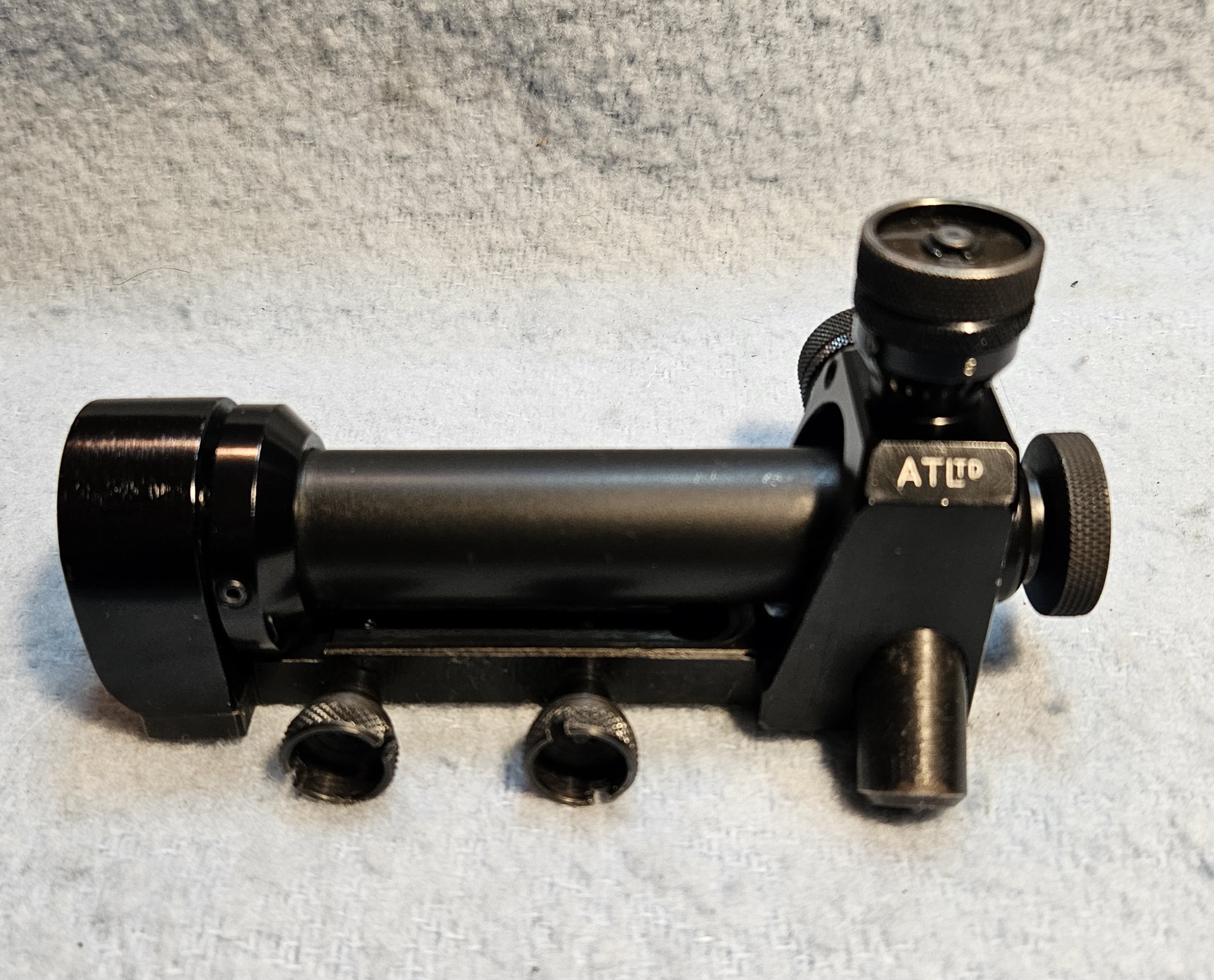

Just to establish my bona-fides as a fellow 'sight nut', I present-
Andrew Tucker rear sight from the UK.
