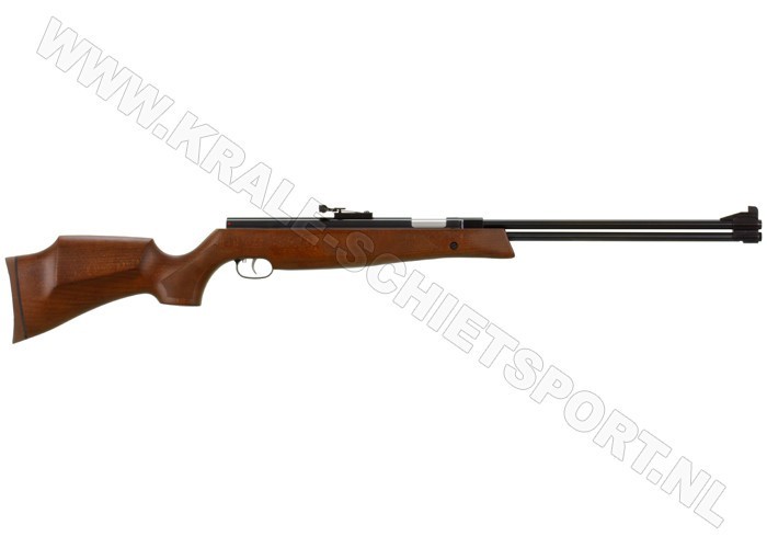

Weihrauch 77 with Diopter sight

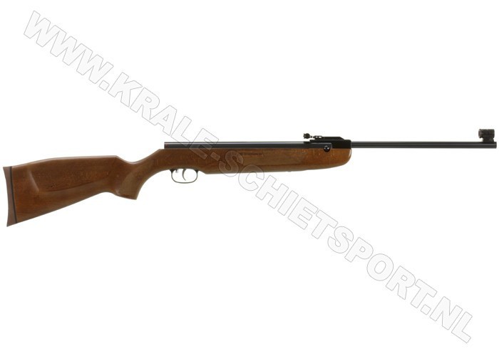

I first saw a model 77 with the Diopter sight on the rimfire central forum for air rifles. I don't want to return there to go digging through all of the posts to find the guy, so I'm just going to ask here if anyone owns one of these? I'm awaiting price info from Krale, who would have to order it from the factory, since I already own 2 77's one in .177 and the other in .22 cal., I don't plan on putting scopes on either of them, so the thought comes to mind, to just purchase a set of Diopter sights, I was looking at sight set's and found what looks to be what is on the HW77 Diopter. I had hoped it was a special set that was made in Germany, but I believe it's an american airgun company Daisy.

That sight looks like the cheap copy of FWB sights that have been offered by several companies in the last few years. You don’t want one. It’s heavy, has rather sloppy adjustments, and its mounting foot is a cheap sharp-edged stamped thing that can scratch the gun. (Yes, I am a terrible snob when it comes to diopters, LOL).
Weihrauch’s own classic OOP diopters will fit, but my personal preference is old Anschutz sights. They can be found all over Ebay, gun shows, etc. They fit perfectly, have precise adjustments, and (unlike HW’s old sight) leaves plenty of room for your thumb behind the receiver.

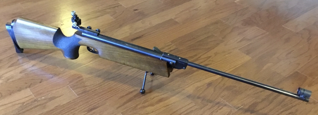

This pic shows a classic HW 55 CM (same groove spacing as the HW 77) with a classic old steel Anschutz “Universal” sight. My avatar pic is another variation of this sight on another 55.

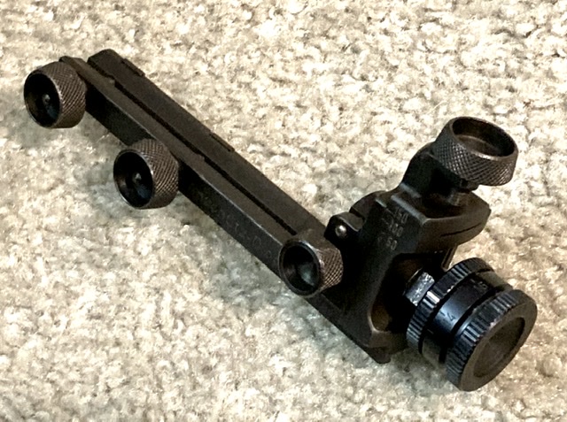

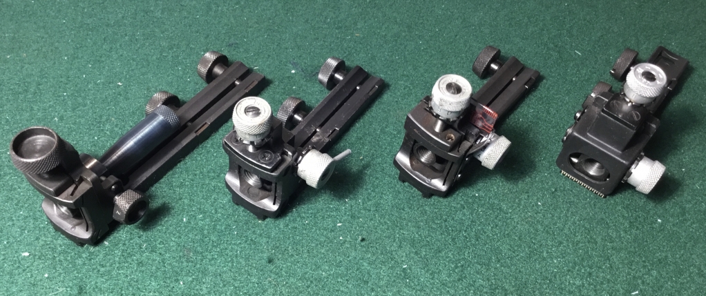

The sight on the right in these two shots is an alloy-bodied model that Anschutz supplied with match air rifles and less expensive .22 lr target rifles for many years. The other three are variations of the upgrade, steel-bodied “Universal” sight supplied with their top models. Back in the day the Universals cost much more than the alloy ones, but most modern sellers don’t really seem to distinguish.
My personal favorite is the one second from the right with the clear acrylic elevation/windage scale. My avatar pic is this sight on an HW 55, with a Gehmann iris.

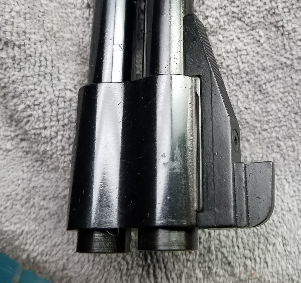

Thank you again so much for the clarification, I really would have been looking for something that resembled what was on the rifle. Now at least I have an idea what to be looking for. No need to buy a 3rd 77, but now I can go get something else...... Here is a photo showing the front sight mounting on the HW77's and any other model underlever with the front sight blade. It's removable from the top via a small FH Cap screw. It straddles the dovetail mount, which is 8mm. Once removed you can mount the globe front sight to it.

Welcome MANNEKEN78! That is indeed an original Weihrauch globe front sight that I took off my HW50s (HW99). It was the one with interchangeable elements. HW probably don't list it as fitting the 77K since they provide the blade front sight. They also don't seem to mention anywhere that there's a rail below the sight.
About shooting at 10m, I think it would be possible (can't think why not), but I can't say for sure. I only shot it offhand at the range at 25 yards, with good results back then. Hope this helps!

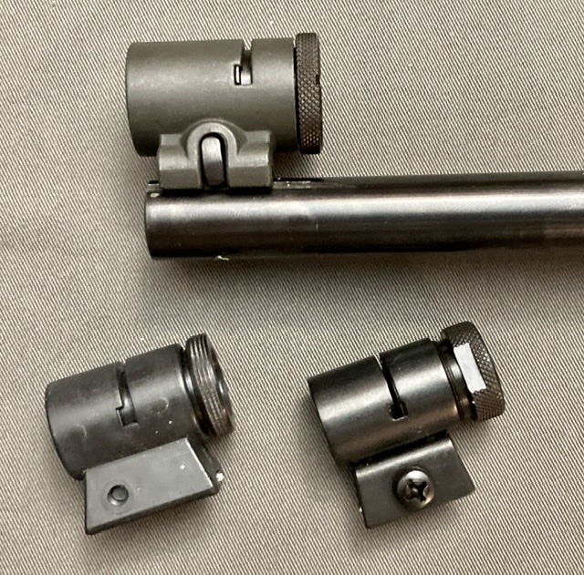

I don't own an HW 77, but it sounds like the front rail spacing is the same as on barrel-cocking HW's - a more or less standard one of about 9mm. Anschutz front globe sights fit perfectly, and Diana ones will also work in a pinch.
HW and Diana globes have an "M17" thread on the removable sleeve (17mm x 0.5mm). Anschutz has the slightly larger "M18" thread, which was standard for most German match guns for many years. This is a significant advantage, as there are many OEM and aftermarket options for Anschutz metal inserts, and a huge range of useful accessories is still available for M18 sights - clear acrylic inserts, threaded-in adjustable apertures and lenses, etc.
This pic shows a basic-model older Anschutz globe on an HW 55 barrel. Below it is the OEM HW globe to the left, and a Diana one to the right.
