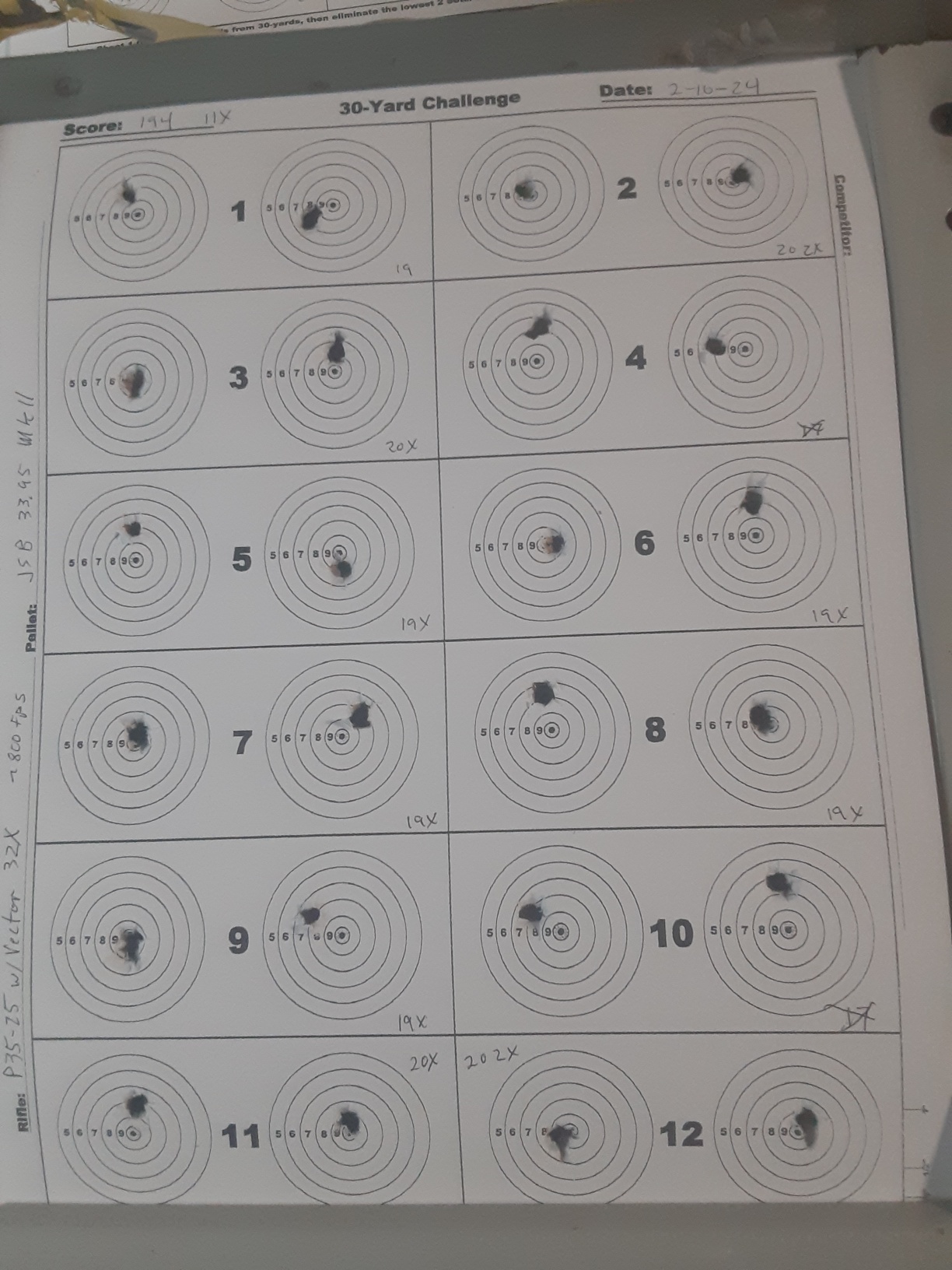

I'd previously shot a 192 and 194 with JSB MKIIs. I shot them again this morning and shot a 190. I was thinking maybe the barrel needed cleaned but the second half of the target was quite a bit better than the first so I think it was more me. But still three targets in a row better than the best FX target I've shot says I will need to stock up on the MKIIs.
I thought you might be interested in the weight sorting results and pictures are always nice so I'll include one. The longest column, the most common size, for the FX is 34 grains. The range is from 33.4 to 34.6grains for the FX. For JSBs, the range is from 33.7 to 35 grains and the most common weights are 34.3 and 34.6 grains. There were only 4 pellets in the remaining tin of JSBs less than 34 grains.
I included a 30 yard challenge target, the 194 I shot with the JSB, unsorted and straight from the tin. I'm still not sure weight sorting does much when I'm shooting at 30 yards. I suspect I would see a bigger difference at longer range. But I think the SPA magazines are costing me some points. I've tested results with Carm magazines in my 177 and 22 caliber P35s and I don't think they hurt me (my one 200 was the P35-22 using Carm magazines). But the spring in the SPA magazines seems a little overly stiff and the body of the magazine is aluminum with fairly sharp edges. Wish I could get regular capacity Carm magazines for this gun but they only offer a 10 count "high capacity" magazine that sticks out about 3/4 inch right into my left cheek. I will probably get a pellet head size gauge for 25 caliber and see if head size makes a difference. It seems to make a little difference in 177 caliber.
