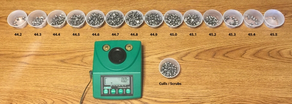

This is only the second time I have weighed a 5 tin sample. Each time the five tins were from the same order, so my assumption is they were from the same manufacturing lot (take that with a grain of salt, because it's an assumption). My first results were almost the same spread and distribution as this time. If you're saying you weighed a tin of these pellets and had no variability in weight (a 150 count tin where all the pellets were the same weight), I have to think there is something not as it appears. Were you weighing on a scale that had a 0.1 gr resolution, or weighing to the nearest whole 1 grain? I ask this because every manufacturing process has variability, On a good scale reading to 0.1 gr, I don't think anyone will find a tin of these pellets that does not show different weights. Measuring to the nearest whole gr... maybe a tin of all 44 gr or a tin of all 45 gr, but even that would seem odd to me based on the spreads I've seen. But, like I said... I've only sampled twice. That's hardly proof-positive.
What gave you the impression I think fliers are caused by weight alone? I said I weigh the pellets to eliminate "the weight based fliers while looking at groups". If all of my pellets for a group are the same weight to 0.1 gr, and I have a flier, I can reasonable eliminate a heavier or lighter pellet from the tin as being the source, thus I have eliminated "weight based" fliers. And yes, I would expect this to manifest itself as a vertical shift in POI. Any source of variability in our shooting system could cause fliers. Slight damage to the head of the pellet could cause spiraling and produce a flier as well (these could show up as high, low, left or right, as you mentioned your fliers do). This is why there was a cup with "Culls/Scrubs" in it. These were the pellets with skirt issues or significant head dings on them.
Now, the real question is that which Wildcatfun asks... does a 1 gr difference in pellet weight for a .30 cal 45 gr pellet show up as POI shift? I don't know yet. Hopefully as I characterize this new gun, I can shoot a 10-shot group with 10 pellets at 44.4 gr, and another 10-shot group with pellets at 45.4 gr on the same target, and we'll see. While I agree that just over a 2% change in pellet weight seems VERY insignificant, when we start shooting these things to 100 yards, we are really stretching the envelope of the airgun/pellet system. My initial tests and sighting in will be at 50 yards, and I'll bet there is a group POI shift of a small amount even at 50 vs 100 yards. But... we'll see. It would be very sweet if there was no visible POI shift at all, but that would surprise me. I would LOVE to know I can just wash, lube and shoot them, and forget the weighing part.
