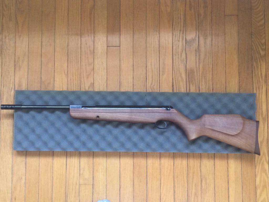

I picked up a lightly used Webley. Beautiful
gun. Cocking had a dry grating sound so I opened it up to find the spring guide broken and a fair amount of chamber oil inside. I made a snug fitting Delrin guide and lubed sparingly with moly paste. A little dab where the top rear of the piston rubs hardest when cocking. Polished the rear of the piston and the sear contact areas. A little moly on the sear.
The gun cocks and fires very nicely. You must use a deliberate application when triggering the single stage unit and when you do it performs very well. It’s not a two stage trigger so I’m not going to expect a super light crisp performance that a two stage can safely yield.

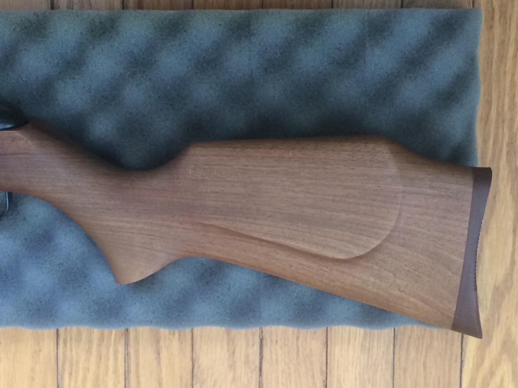

The walnut stock needs a little help so I’m going to apply a coat or two of boiled flax seed oil to bring up the grain a bit.

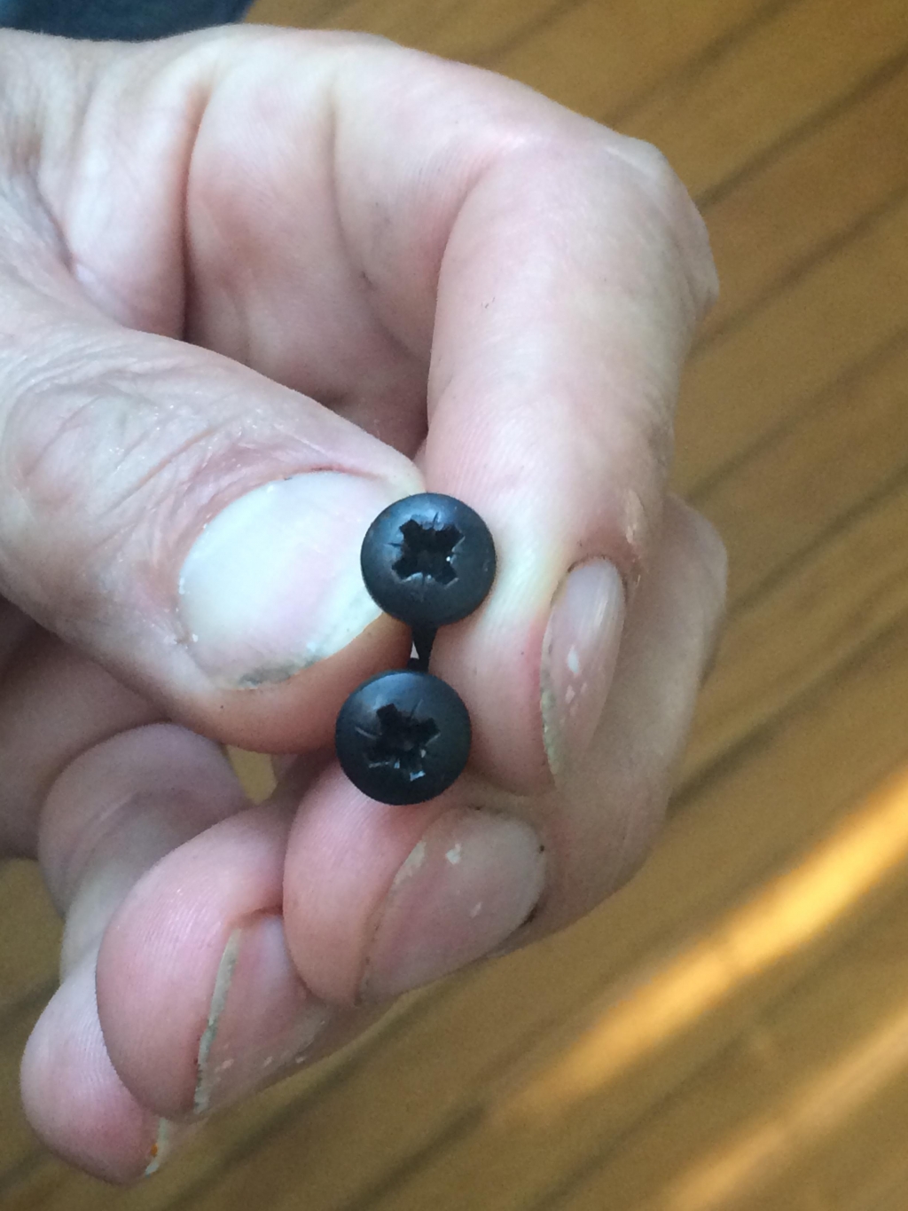

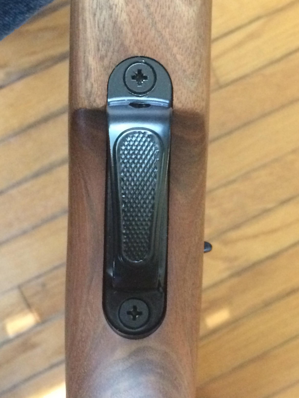

An odd thing I noticed. The stock screws are a mixture of phillips head and Pozidrive. 3 Pozidrive and the rear trigger guard screw is phillips.
