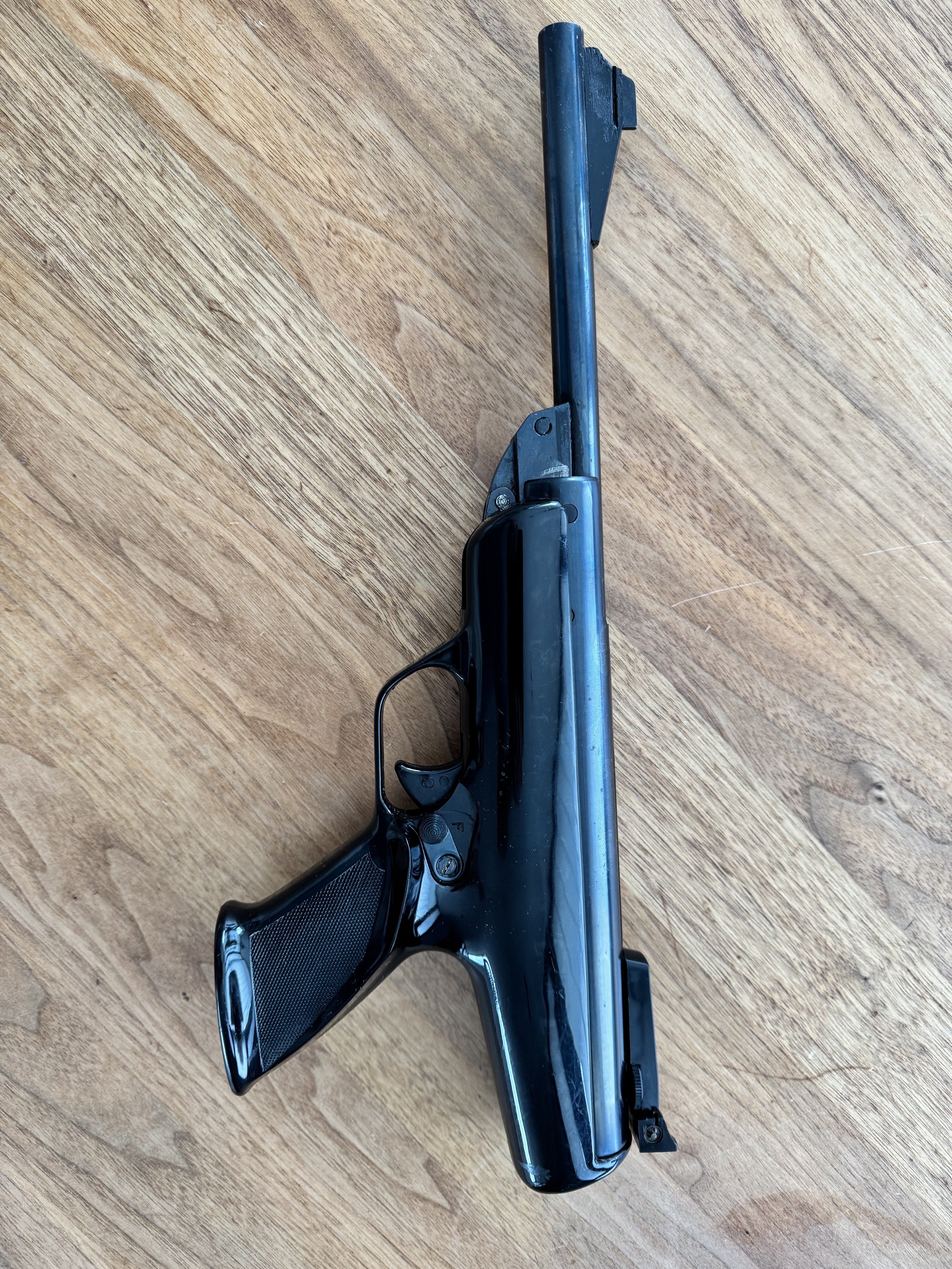

N/A Webley Hurricane
Tempest was a hard pistol to shoot accurately . Hitting a can or similar target was fairly easy @ 10 / 20 yards. defiantly not a bullseye gun for me .
This Hurricane tuned and polished by David Slade (his gun ) is still that same short slam of a cycle , but still a smoother experience . Now if i can find a muscle bound 16 year old to cock it 40 times in a row for me to shoot this morning 😁😁😁

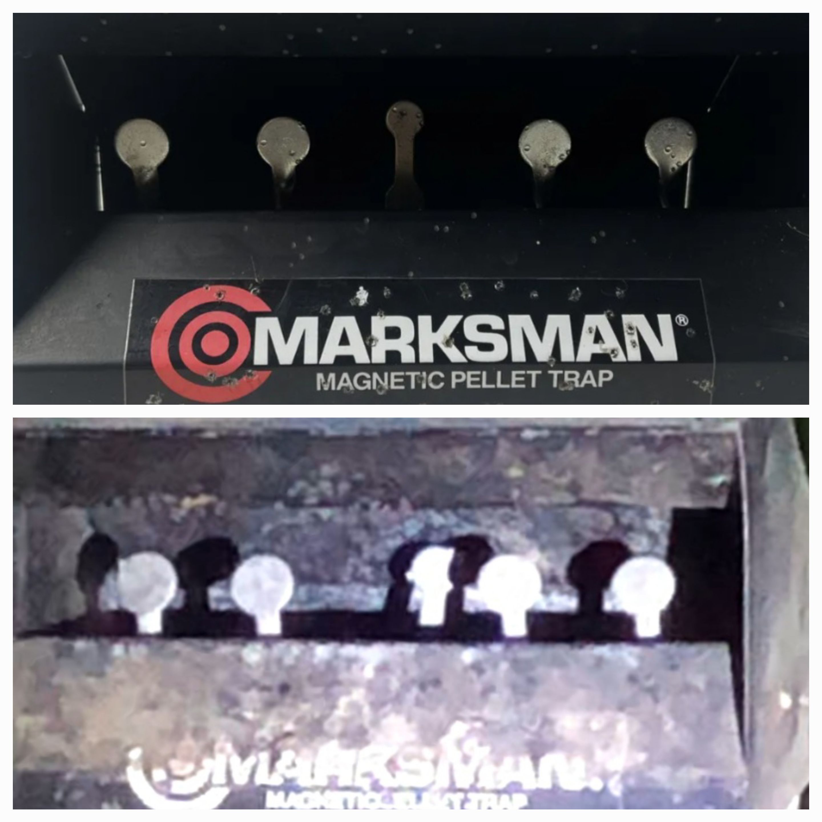

BTW shooting a can in half is very difficult ! you need to shoot all those thread like strings of metal to get the bottom of the can to cleanly fall to the ground , and the can is hanging on a piece of wire so it swings around .
This was my primary target at 10 yards with my pistols, and you could easily miss half of your shots with no fault of your own shooting the Tempest. My other pistols missed when you missed. That bothered me enough to part with it.

This was my primary target at 10 yards with my pistols, and you could easily miss half of your shots with no fault of your own shooting the Tempest. My other pistols missed when you missed. That bothered me enough to part with it.View attachment 579570

I am thinking to buy a Hurricane that has just been owned , nothing ever done to it , just to see the difference in the one i have . Also been looking for another Tempest but the prices are way out of line .
