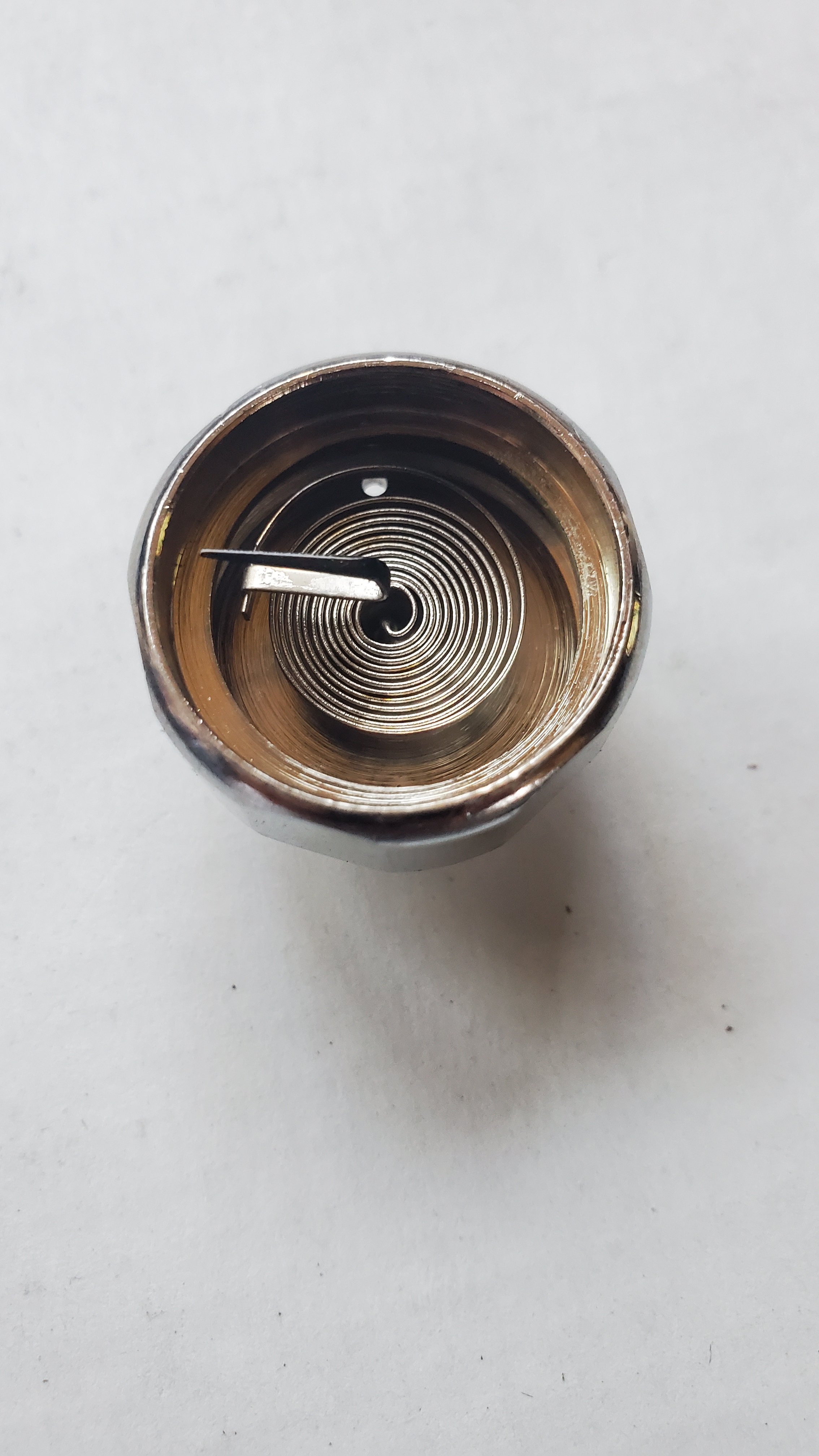

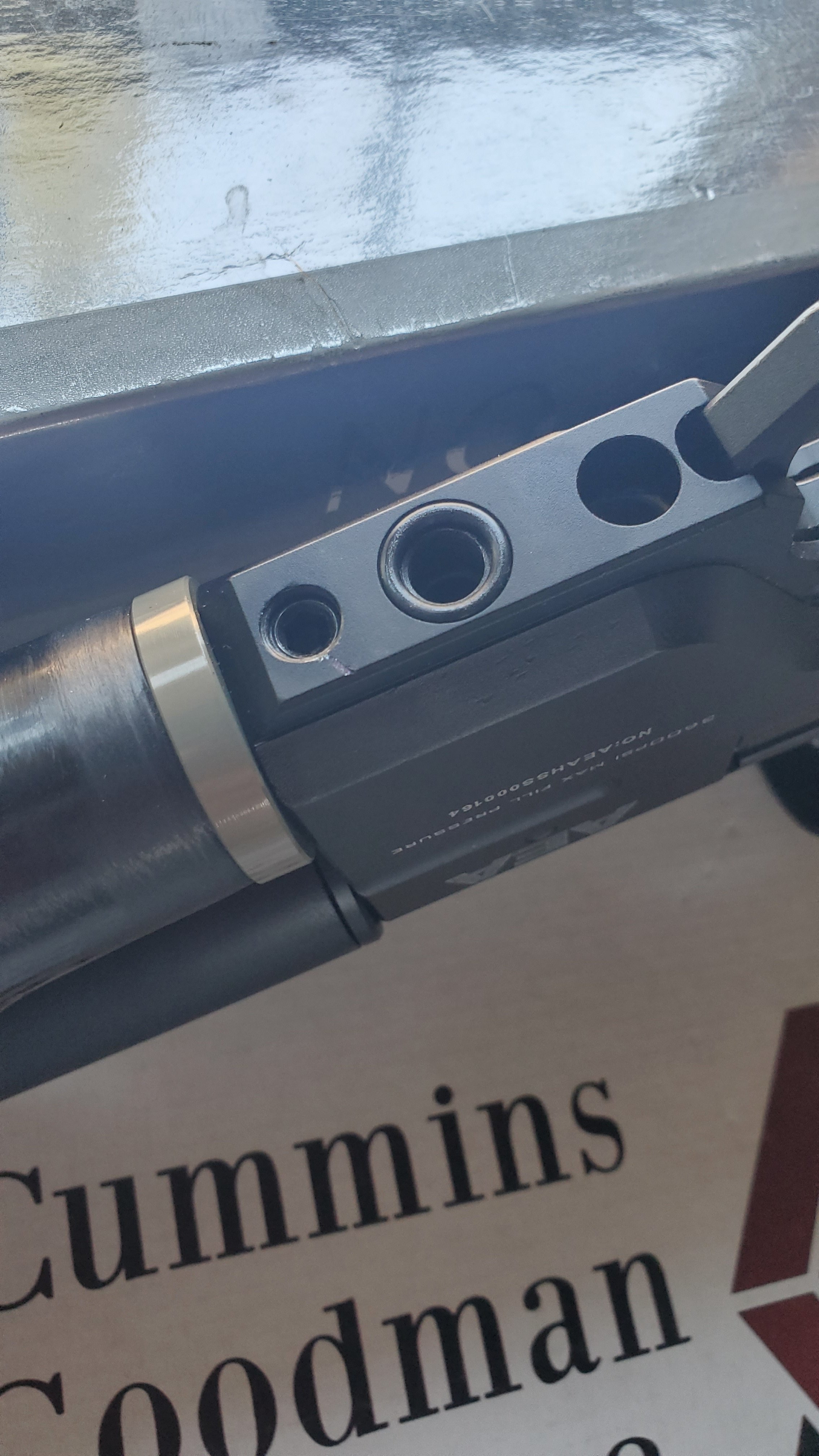

Yep, that video came to mind for sure. My message is expect the unexpected and protect yourself. To clarify, the gauge did not fly off, the scale/face plate and lens blew off. I was facing it at that moment. I cannot understand the cause?
sounds like not as bad as I imagined.. I figured that the whole thing went across the room like a pellet.. I'm guessing a gauge defect?
still glad you are ok.. that's the main thing.. the rest is just parts.. a lot easier to replace the entire gun than a person..

OK, to bring closure, I believe I have it figured out. When I first loosend the gauge it bled as expected then trickled down in flow, so I loosened it some more. Apparently, the oring came out of the recess and expanded till it vented into the gauge vent. This explains how the gauge body got pressurized.
Immediately after the event, I removed the gauge and found the oring stretched larger and distorted. It returned to its original size as seen in the photo. I pushed the needle back down from its distorted condition, so it looks relatively normal. The new gauge I ordered comes with a delrin oring. So, I figure it was the wrong type oring as the cause.
Immediately after the event, I removed the gauge and found the oring stretched larger and distorted. It returned to its original size as seen in the photo. I pushed the needle back down from its distorted condition, so it looks relatively normal. The new gauge I ordered comes with a delrin oring. So, I figure it was the wrong type oring as the cause.View attachment 384913View attachment 384914
That’s bothersome, but it does make changes that I’ve seen elsewhere make more sense. I’ve extruded a gauge oring after installing the gauge with the oring positioned incorrectly, but because of the design the oring just popped.
