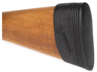

Might a slip-on rubber buttpad, or simple piece of rubber padding laid in the floor, be a simpler - and more portable - means to the same end?
That ought to be about the perfect KISS solution, but not in this case. The butt isn't even close to being flat, so it's a considerably more difficult task for me to anchor on the smooth wooden floor to 'break' it. Thanks for the suggestion though.

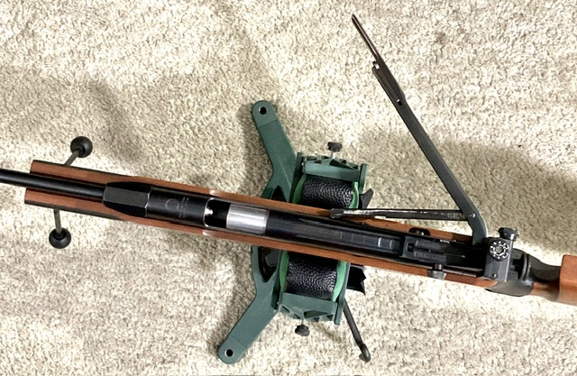

Have you considered a sidelever springer? You don't have to reach as far forward to cock it as with a break-barrel, so might be able to work from your lap, instead of the floor. And - most sidelevers have a built-in ratchet mechanism to restrain the lever during the cocking stroke - should your grip slip, it stays put and does not slam shut.
Two sidelever rifles that I particularly like are the FWB 300S match rifle I mentioned above, and the Webley Tracker sporter.

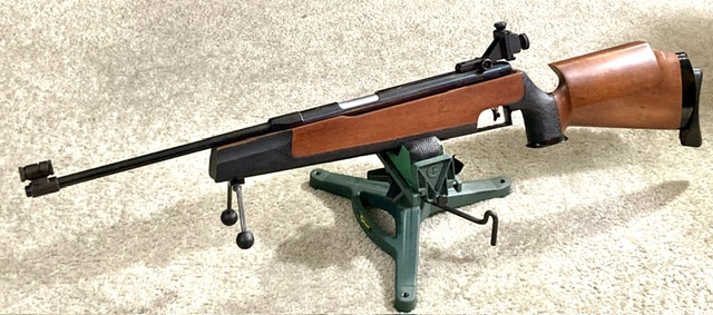

The FWB has a short lever and is VERY easy to cock - even my old and dinky hands can literally do it with my little finger. It's a big, heavy rifle but you can minimize that with a Junior ("Mini") model, or a full-size one without a barrel weight sleeve.
FWB (this one is a short-barrel Mini action in a full-size stock):
Sidelever held by the ratchet halfway through the cocking stroke:

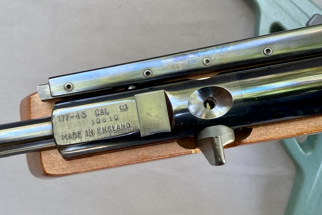

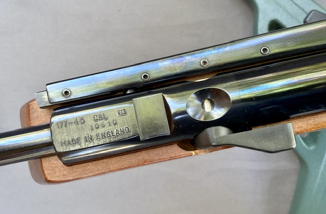

The elegant and compact Tracker (imported here as the "Barnett Spitfire"), besides the ratcheted sidelever, is a classic taploader - the safest springer mechanism ever designed. You don't stick your fingers inside a hinged or sliding breech to load it, but simply drop the pellet into a rotating tap.
Tracker:
Closed tap (for cocking or firing):
Open tap (for loading):
Yes, I have thought about both under and side-lever rifles, but I'm not going to risk hundreds of dollars on a rifle I haven't tried (or tech with which I'm not already thoroughly familiar). I thought using the Omnia ZRS would be well within my capabilities, as I'm mostly just not ambulatory, but that isn't quite how it turned out (and I couldn't hurt my wife by returning her extremely thoughtful and well-researched gift). Thanks for the suggestions and photos. I really like the open/closed tap for loading; very ingenious and much more practical than the usual loading methodology!

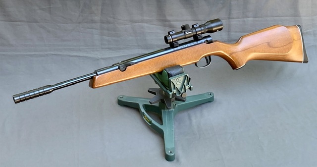

Don't be shy about stepping down a bit in power to an R7 (HW30). They are about 8 FPE and can be very accurate to 50 as long as the wind is low. Cocks with about the weight of your arm. They are also lighter which makes picking them up each time you cock them easier as well.
Beeman r1/HW30
You can shoot these all day and will never hurt nor get bored
