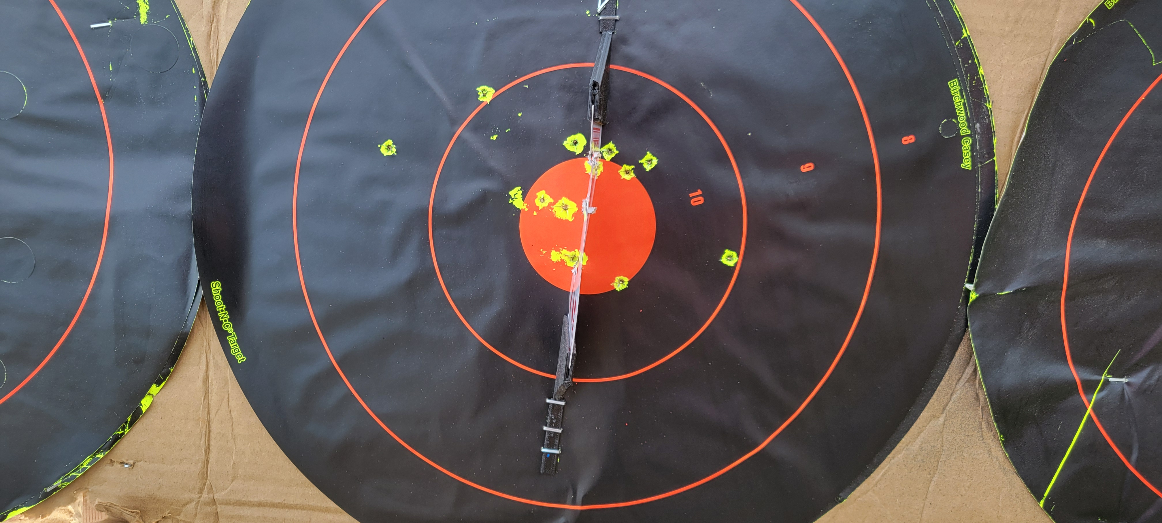

Here is a group I shot just last week at 200 yards. 15 shots and I partially split the card 4 times. Meaning, I hit the card dead center and the slug deflected.
Its rare to completely split card in half, but I have done it once or twice.
So check out my "Shooters MOA" groups at 200 yards. They are not hail Mary shots..
I'm not posting this to brag. Just to show what is possible after thousands of shots and a good setup..
I shoot at the Diablo Rod and Gun club in Concord California and welcome anybody to come shoot with me and with a bunch of great airgun shooters.
Rod in San Francisco
Reactions: Blueduck
You've got a 3.5" tall playing card on there for a size reference. Your far right and far left shots are further away from each other than the height of the card, by what seems to be about double. So a 6.5-7inch group @ 200 making that a 3.1-3.3moa group. 15 shots though, which is a plus.
4/15 sounds occasional to me. The 4 that touched the card aren't your average accuracy, they're the outliers. To do that 2 dozen times you'd need to take 90 shots, assuming a continued 4/15 hit rate (4/15 = 24/90). You're missing a lot more than you're hitting. You've chosen a difficult target, I'll give ya that.
Next time you're at the range, try shooting 5 consecutive groups of 5 shots each, or even 25 shots in a row, trying to center a bull, and then share that. 100 or 200 yards, whichever you prefer.
