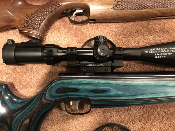

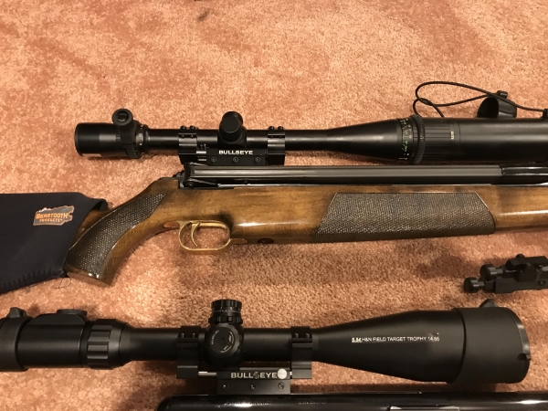

I actually ordered a couple of the cheap mounts just to test them. I have a Ohunt FFP scope and I was very surprised by the clarity and it's been holding zero for about 9 months. I'm going to try the mounts on my D460 and D48.

In my first response on page 1 of this thread is a link to a previous thread with some pictures and explanation of what I did to mine. Anyone can do it with a drill and some cheap goods from any local hardware store. Just basically eliminated any chance of slop. If I’m honest I didn’t have any issues before but I couldn’t leave it alone. Feeling any movement made me crazy even though it was probably repeatable before I touched it.
