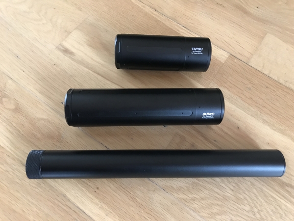

Ok, I bit the bullet on a wildcat compact with the kryptek typhon dip and stx liner upgrade. Basically a warcat without the grey cerakote. Probably a 3 week wait but I'm trying to decide on an LDC from DonnyFL. Anyone know the length of the fx impact/wildcat 1/2x20 unf adapter #A2? I'm trying to decide between like the 1.6x4.25" Tatsu plus adapter length vs maybe a 1.22x5" Tanto with m20x1 endcap (no adapter).

Anyway, I love the way that short Tatsu looks on the wc compact, just wonder if it'll be enough. Maybe I should just add the adapter and a Sumo. My neighbors don't really whine but I try not to tempt them. What are you mates running on your wildcats and wc compacts? Photos, advice and opinions are all welcome. Just not sure what to expect from a stock .25 wc compact.

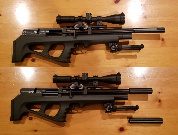

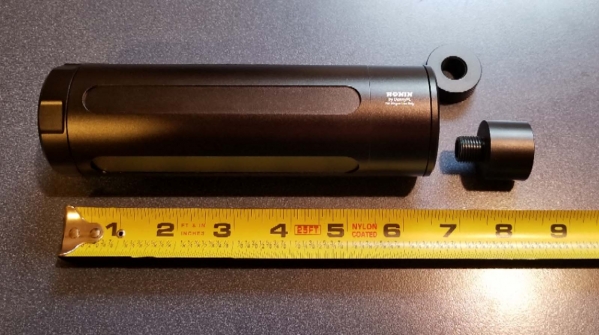

Hope this picture helps (Top is with the DonnyFL KOI, bottom is stock shroud). I got the Koi for my .25 Wildcat Compact and highly recommend it. I tried a Ronin I had, but it was too big for my taste. The Koi is about 84db 1' from the muzzle, the Ronin was about 82db and a lower tone, so it seemed a bit quieter, the stock shroud was about 90db. (Using an RS SPL Meter). One thing to note, the Koi comes with the adapter and it only adds 1/8" length. If you buy another LDC with an adapter, the adapter is about an inch long, so take that into account.
I have a Tanto on my WC in 22cal and Donny is making version number as we speak. I also have a Sumo that I used first. People around can't tell the difference so the new Tanto V2 should be awesome. I'm buying the new Tanto when it comes out just for fun. I need to borrow my buddies high dollar DB meter and make a video just to see what the actual difference between them are. Call or email Donny he knows best.
