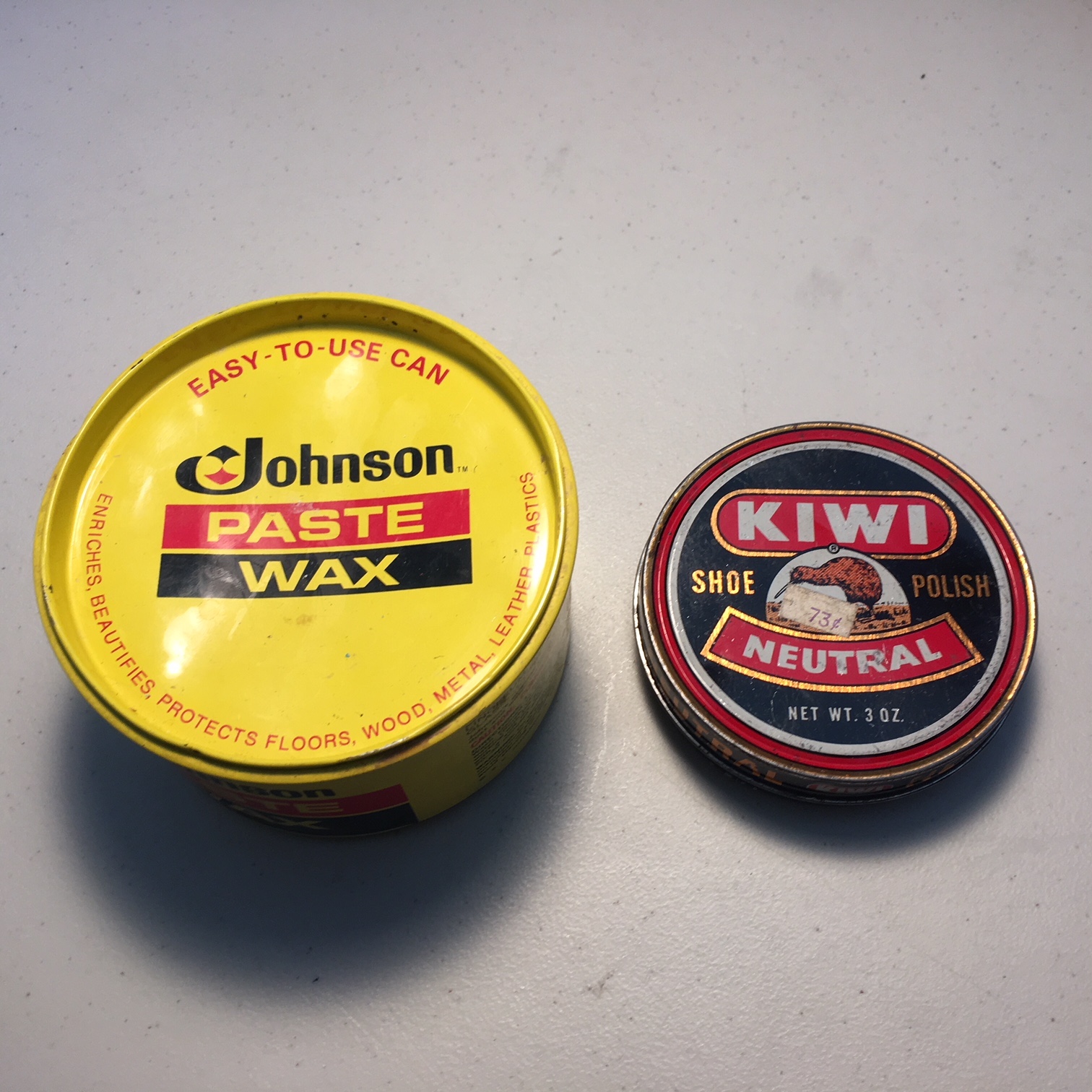

How about Johnson Paste Wax or good ol' Kiwi Shoe Polish?
I'm trying to find something to use that we already have laying around, rather than buying something specifically for this, only to have it laying around for decades, too.
Neither of these lists the ingredients.
Thanks, guys.
two thumbs up for Johnson paste wax,, i would leave the Kiwi for the leather

If you want to go full McGyver, you could try something like Shea Butter. It's quite affordable, easy to find. It has some oeleric and stearic acid in it, so it might not be ideal, but it's essentially a waterproofing wax. Very low-tech. You can find it in some feed stores (people use it to make candles) and in African goods stores (used in hair care and cooking oils).
