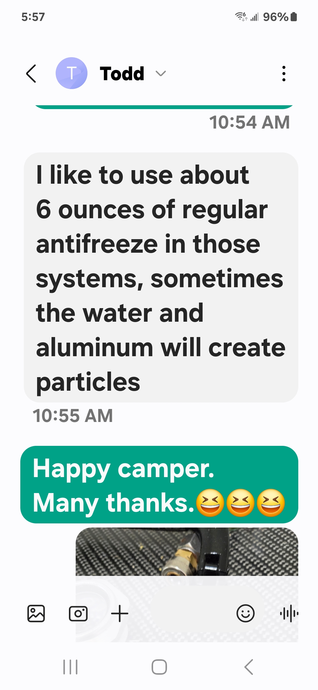

I was just discussing this with the compressor guru Todd about my Omega super charger.
