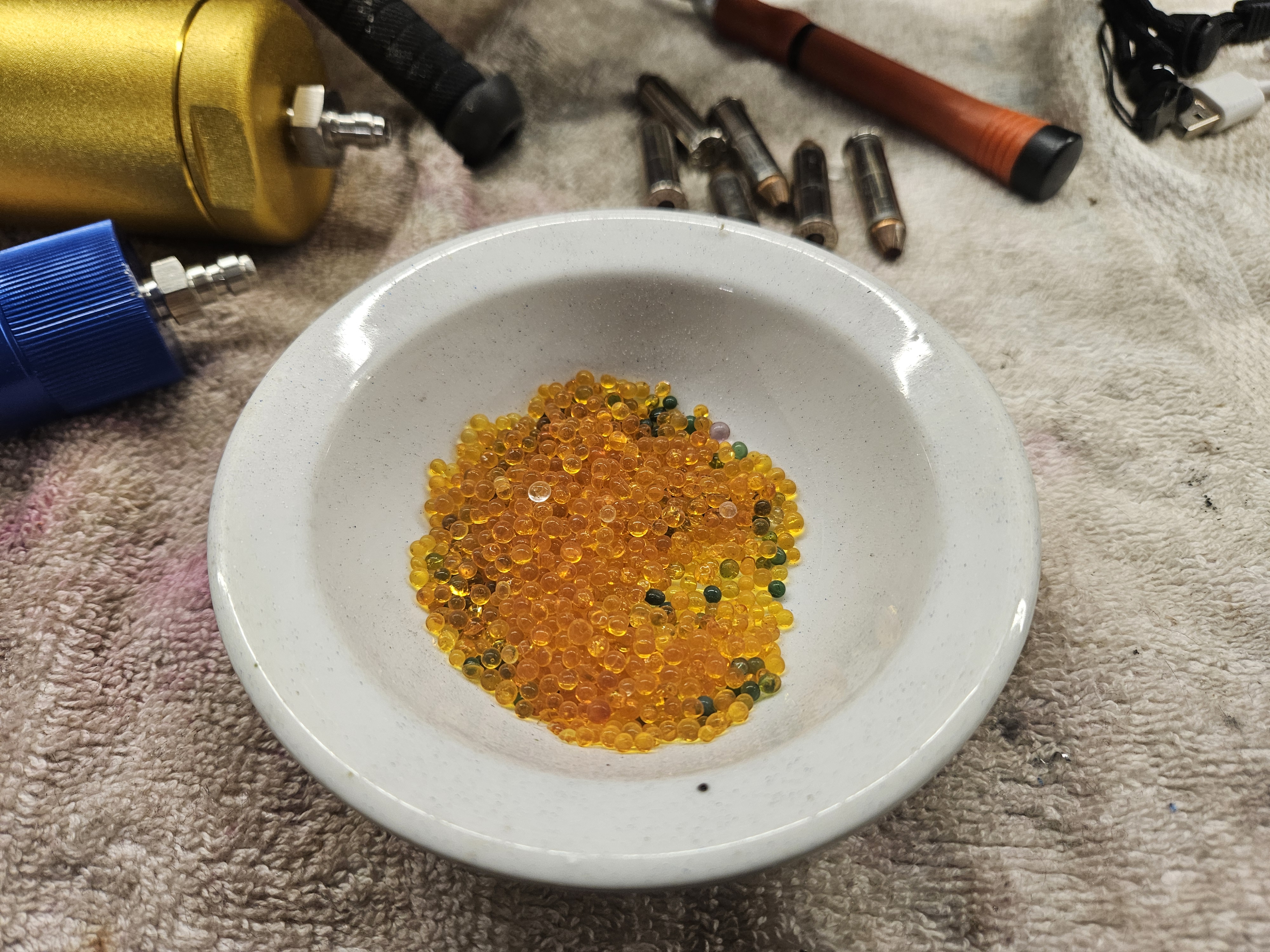

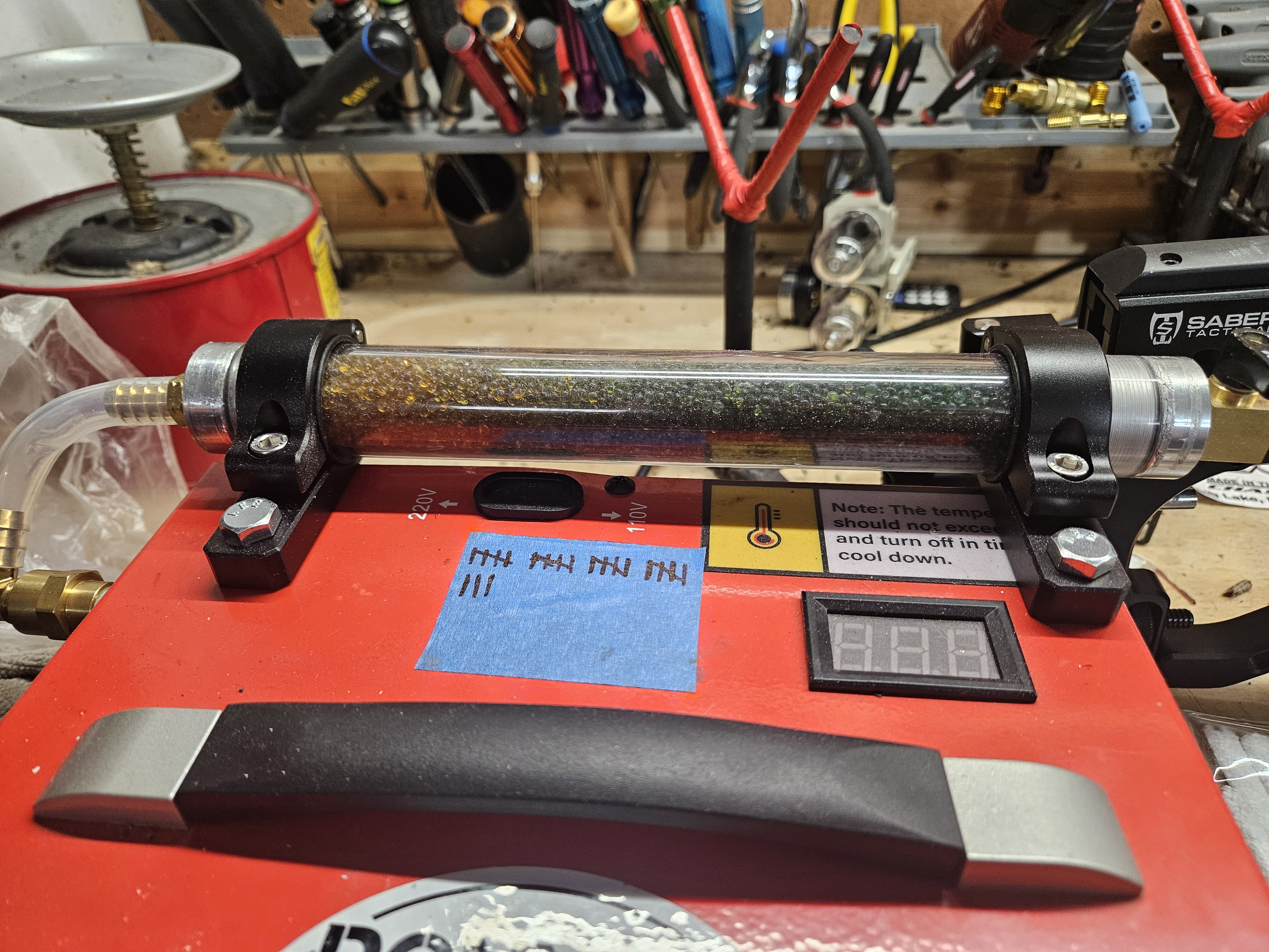

I've been filtering on both ends of the compressor with great success. Here's a pic of my desiccant filter on the intake side fully saturated after 26 fills. The other pic is from the desiccant I poured out from my output line filter. It was almost completely dry due to the input filter removing most of the water,

Here's the desiccant from the 7" output filter. It had a long way to go before it needed changing.

Yeah, I read the thread where you described your intake setup. Think I’m gonna do something similar.

I thought the molucair sleeve works better when its mounted vertical ??
