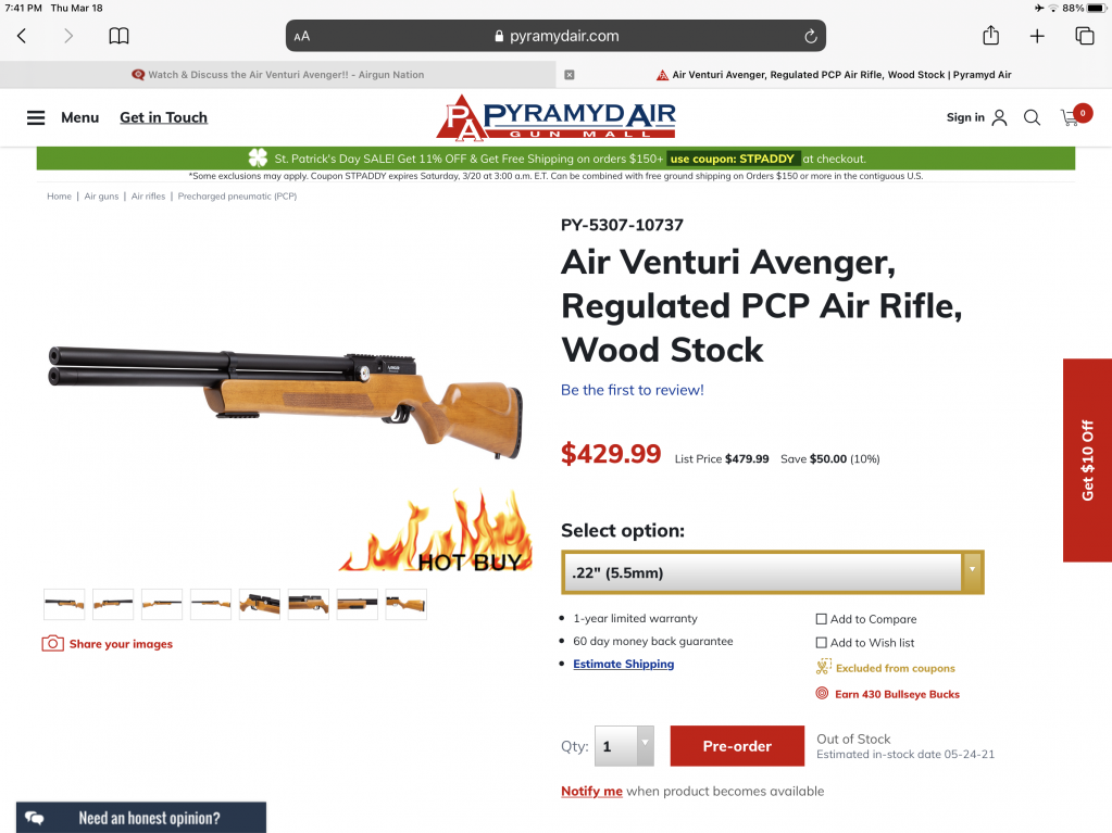

The new wood stock Avenger coming in May as advertised by PA .22cal and .25cal
Mine is due to ship 5/27/21. I received the confirmation email on 4/2/21
Where can I purchased just the stock ? Looks good but how does it affect the overall weight if the gun and would it be of any real benefit ?
The stock will add weight, perhaps a pound?. Unless you are backpacking up mountains with the gun, the added weight will be a benefit.
