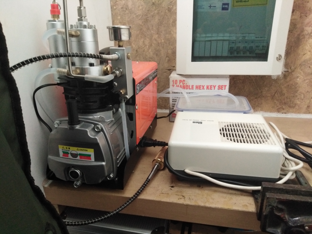

Hi guys i would like any feedback if anyone has done this same type mod on there yong heng and if indeed it keeps the water cold and circulated. Plus the steps you had taken to wire it up has i would be a novice doing anything like this has this is my first compressor. Here is a pic of the setup i mean from a computer. Radiator and 2 fans so the fans would just need wiring up. Has the small pump would run the water through the radiator and then into a small water container with pump.

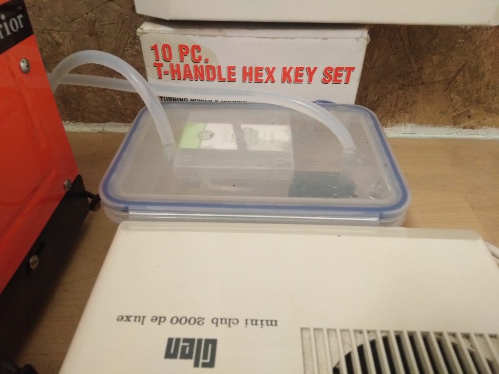

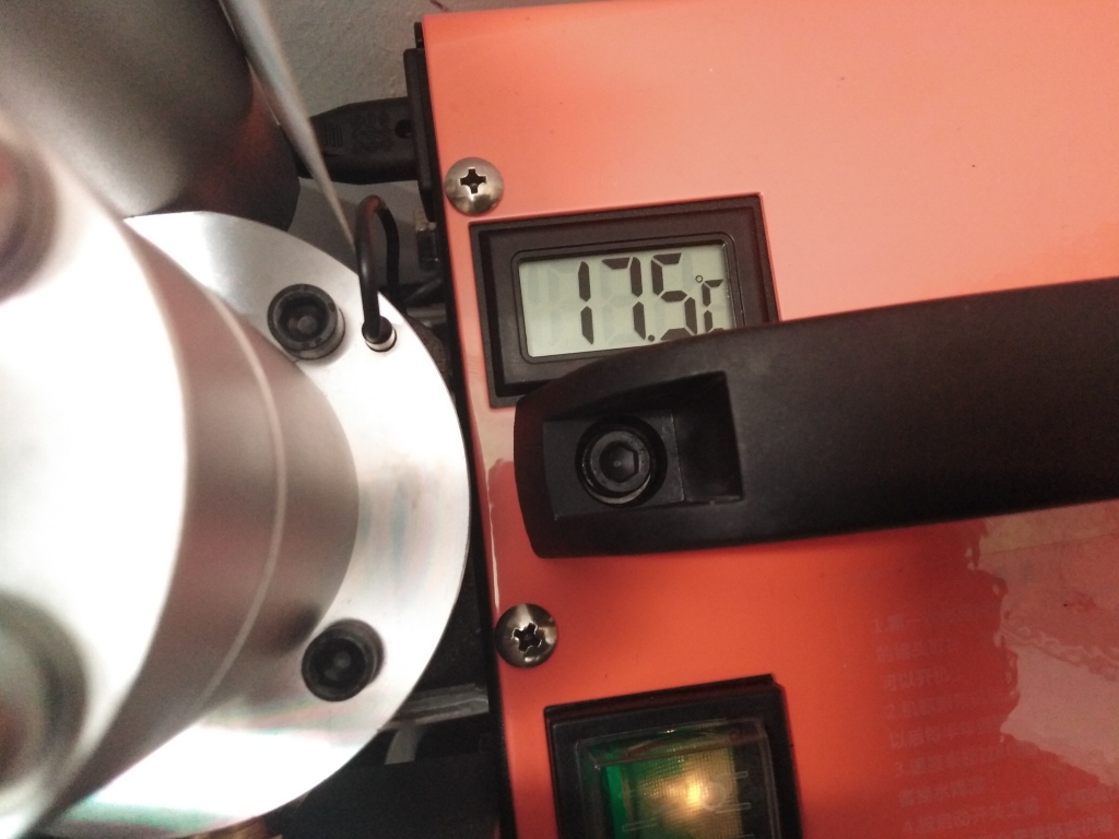

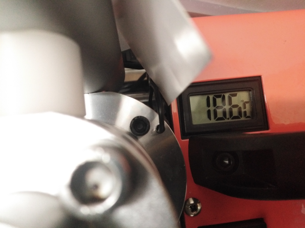

Hi guys i come up with a self regulating system with an old heater fan took the element out so it now just blows cold air. Then added a 8x6" self seal clear box with the pump inside topped up with cold water drilled 2 holes for the tubes then added inside a 4x4" clear box filled with water and froze in the freezer. So on start up i would put the 4x4" box filled full with ice inside the 8x6" to keep the temperature down during running. I wasnt sure if it woukd work but running it started at 18.6c and went down to 17.5c so it seems to work but will have to see what its like from filling a bottle. So ill keep you all posted.
