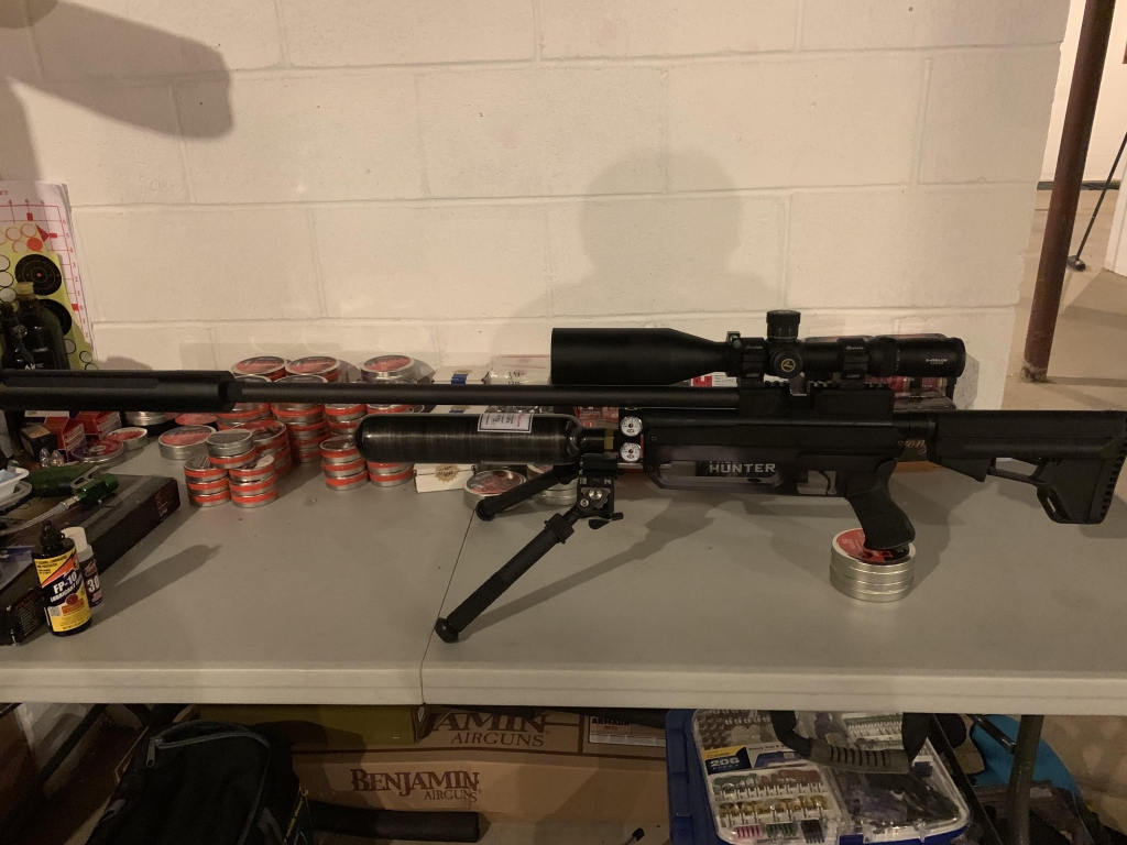

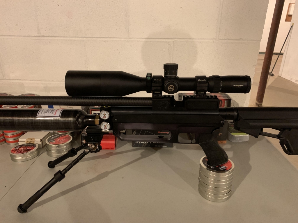

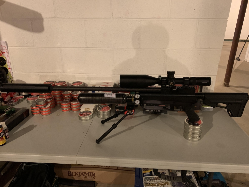

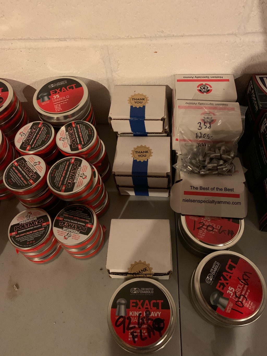

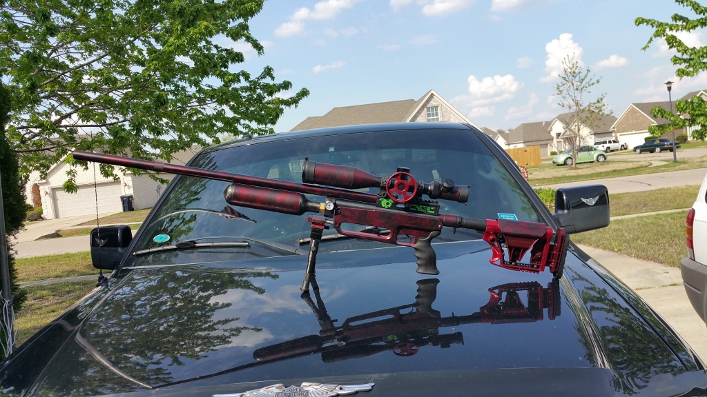

Sure. Not great lighting. Taken from my 30 yds basement shooting range. 2 pics of the Flex 357 cal + my 357 ammo stash to feed the Flex beast...![]()
Stocking up on pellets is cheap compared to stocking up on my powder burners precision ammunitions....
Here's the Flex with my 50 BMG's Atlas 5-H bipod. Totally sinister looking.![]()
