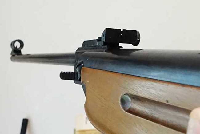

Your thinking diana .. notorious by design..lol
Most all have it but how severe it the thing . I worry less with hw . I always blamed guns with ball detents ..🤔
Hw35 here pretty sad with a latch detent
I liked this ( nothing to see here folks ..move along)
"What manufacturer is the worst offender in the air rifle world for barrel droop? Time’s up, it’s Diana. I spoke with a Diana VP of marketing (or sales, I can’t remember) about the barrel droop issue and was informed that the company didn’t see a problem. "

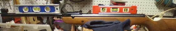

Not bad here
