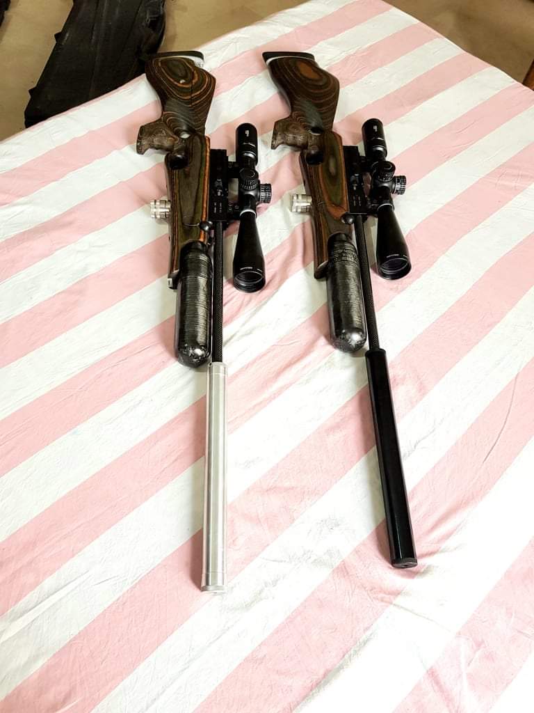

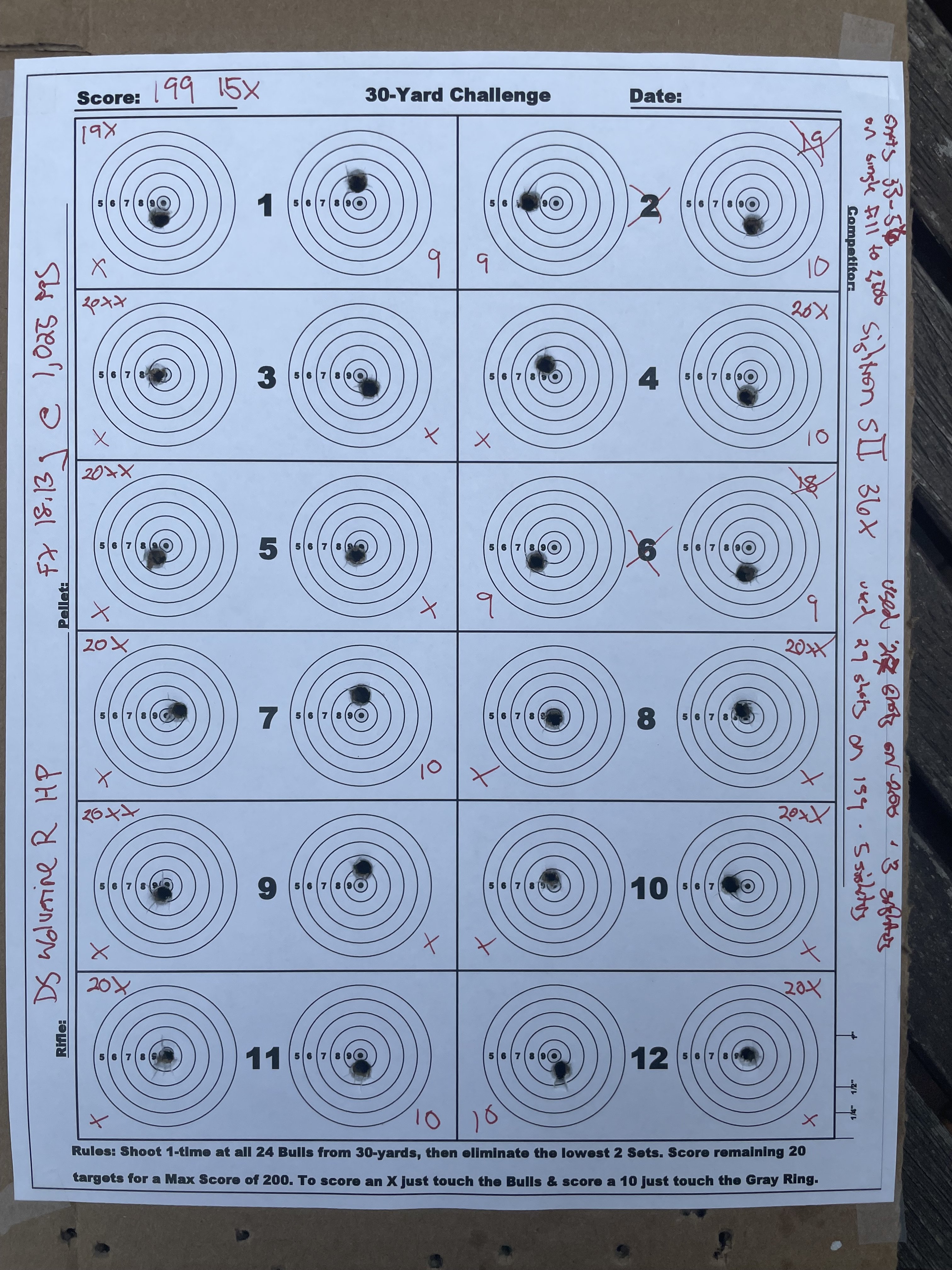

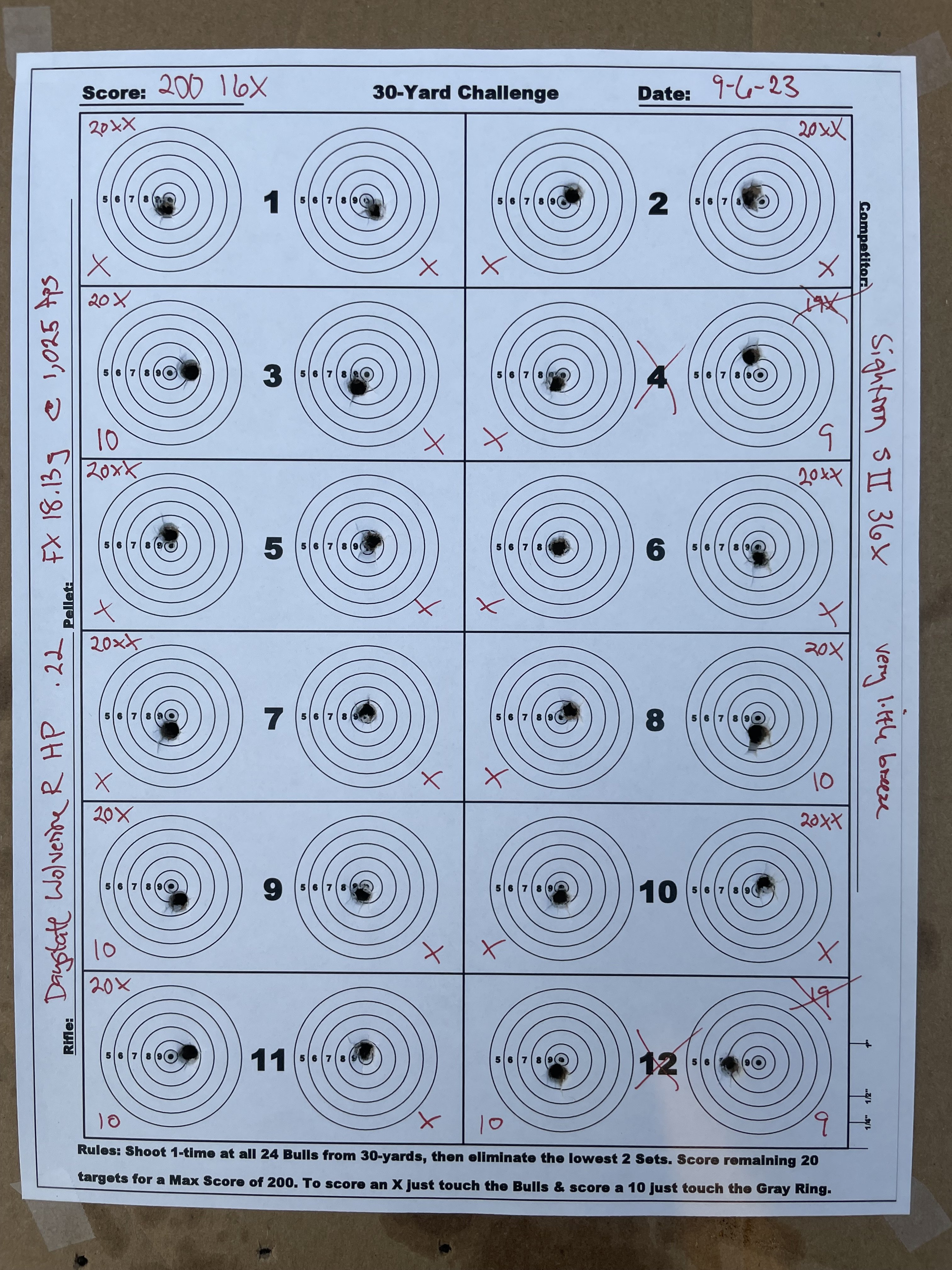

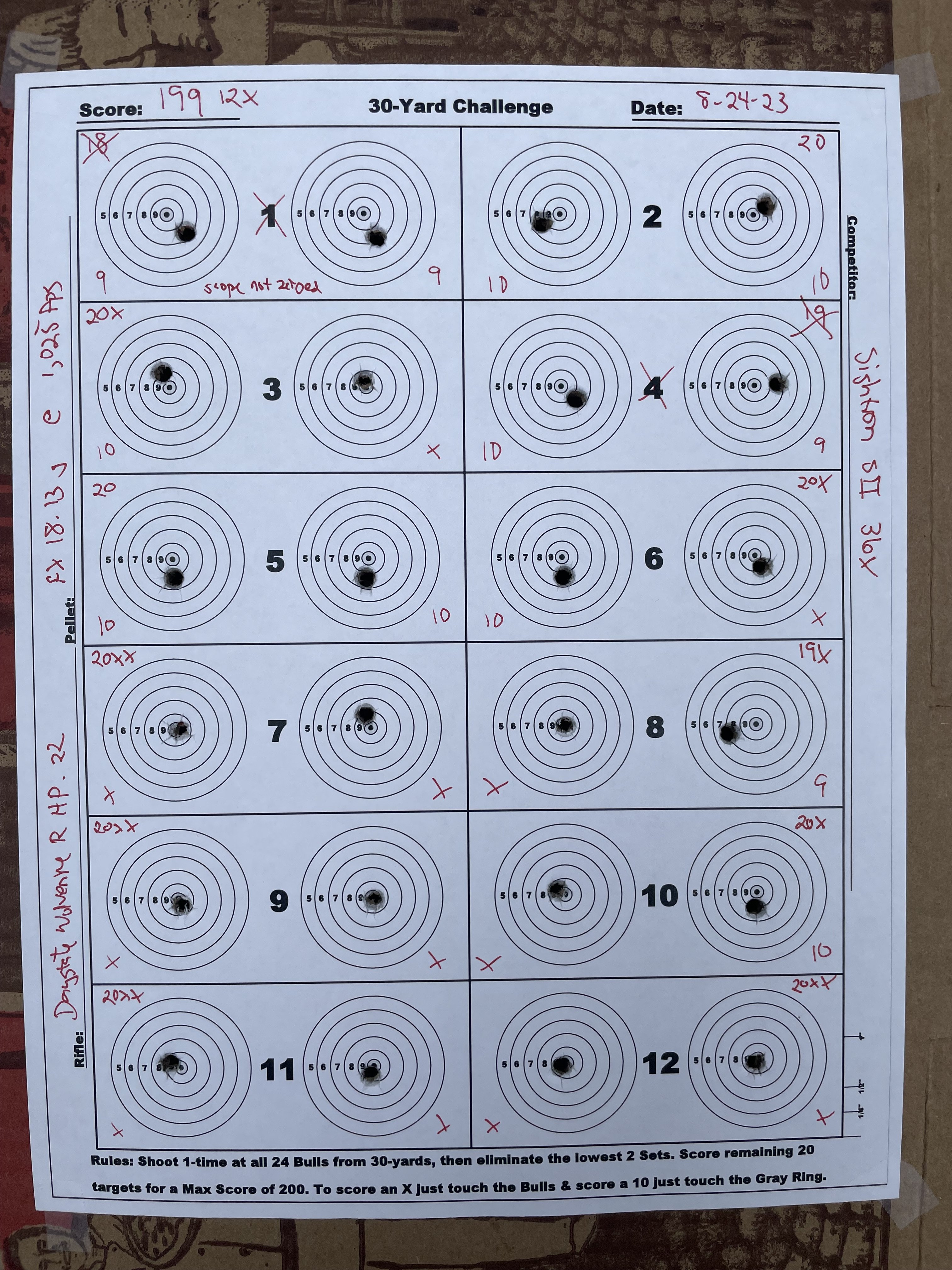

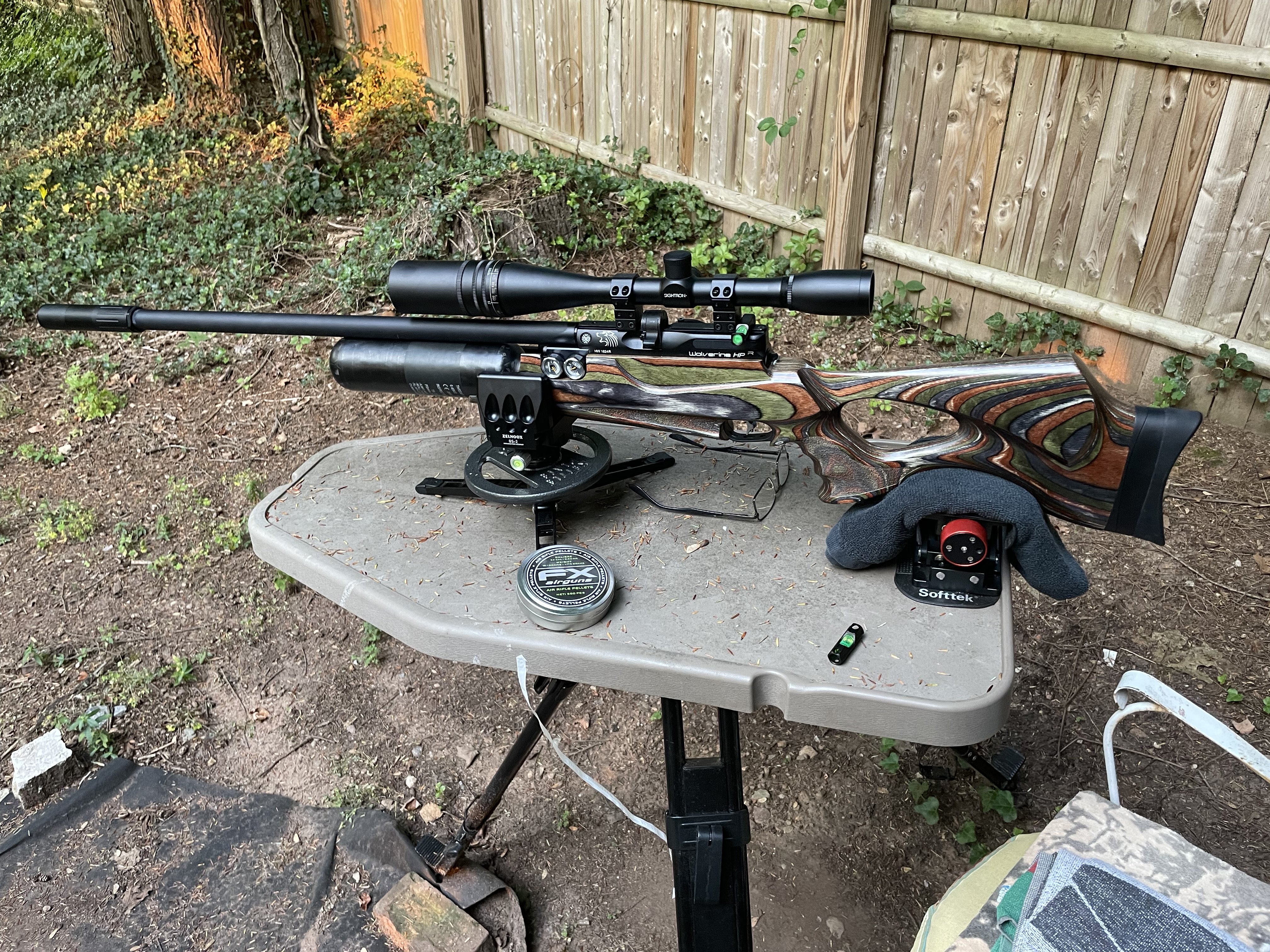

My Wolverine is AVERAGING 198+ in the 30 Yard Challenge - the 10 ring is .13” and the X is .02”. This is using JSB/FX 18.13s @ 1,027fps !! The barrel is more than keeping them stable at that speed, its lazering them.

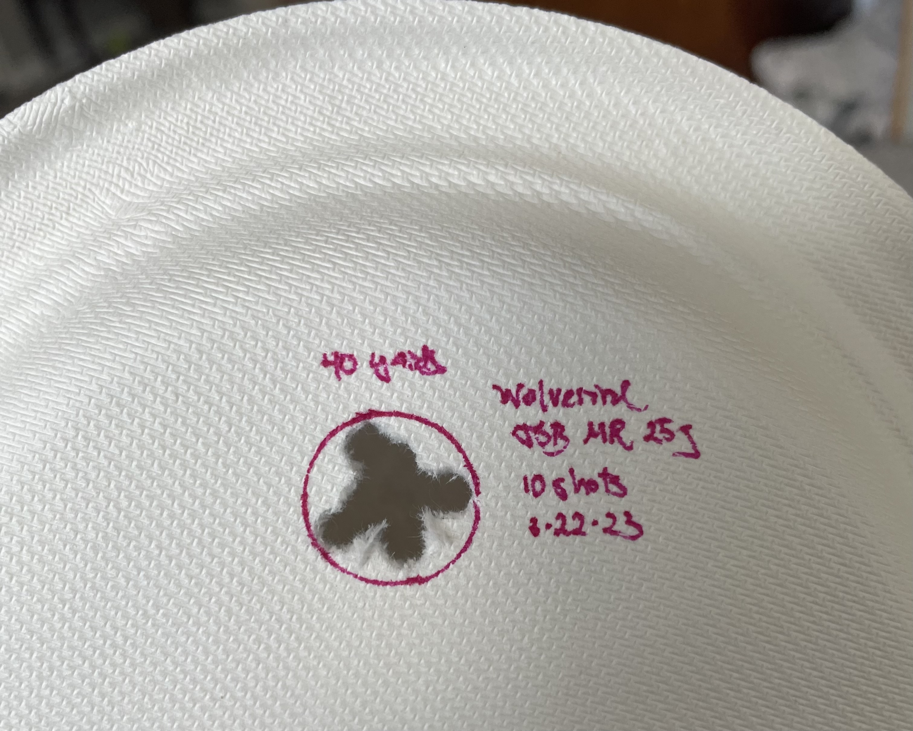

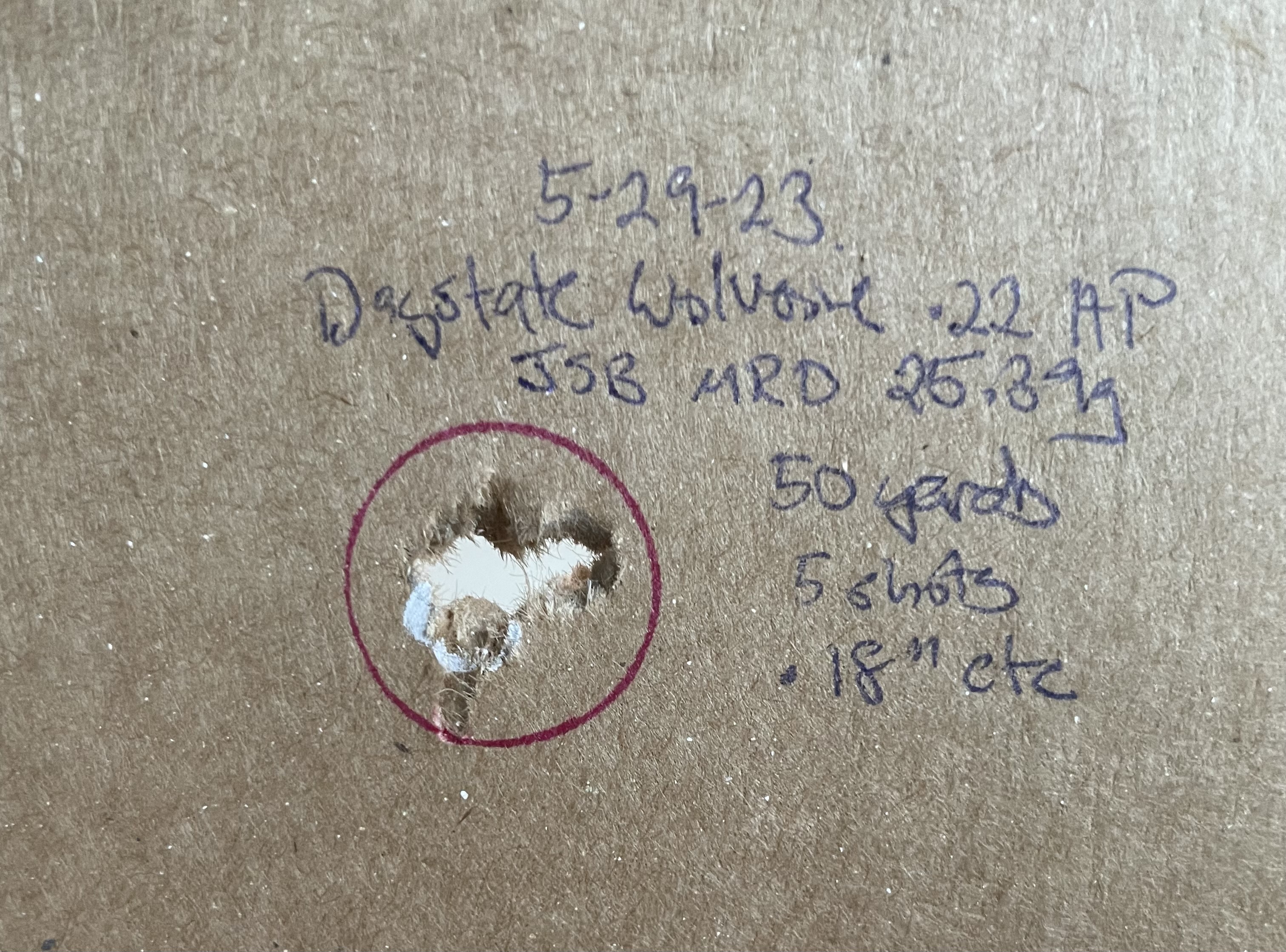

From my pics, you can also see that it’s shooting MRDs very well at 50 yards (also at 75 yards - I’ve tested). It shoots the MRDs at 900fps.
So, its a mechanical rifle like the RAW with similar barrel technology to the RAW. Proven manufacturer. Shoots both 18.13s and MRDs well with same tune - no adjustment required.
I believe the Wolverine R HP .22 was designed/tuned for MRDs - but I’m showing that it shoots the 18.13s extremely well at high velocity. I would not have believed it till I tried it and saw the results.
