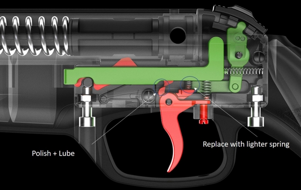

I have one in .177 and really like it! Out of the box,like many springers,it was a bit "twangy"...so I ran about 500 pellets through it and decided to put a little Lucas Red and Tacky grease on the spring/guides ect. I lightened the trigger a touch (lighter spring). It's quite accurate and fun to shoot! Light cocking,good power (Plenty for squirrels and rabbits.) and the lock-up is exceptional,Especially for a moderately priced rifle. I picked mine up from AOA for 149.00-ish.

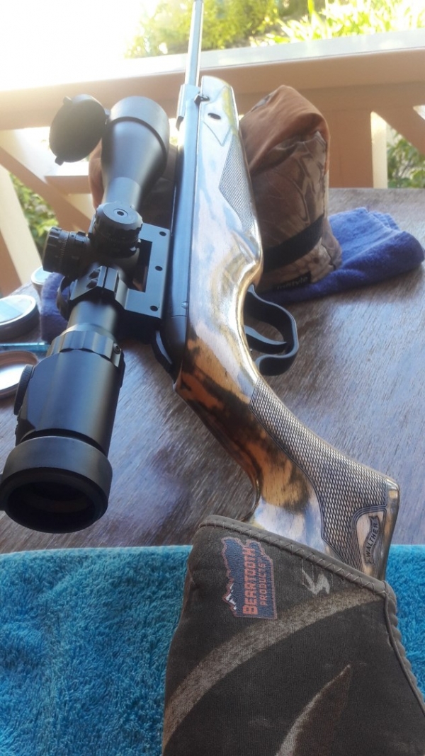

I have one, sleeved the spring, replaced top hat with TBT top hat...Loves Sovereigns and H&N FTT 4.52 mm, really accurate, replaced trigger spring with lighter as others have done...Great gun for the price...
