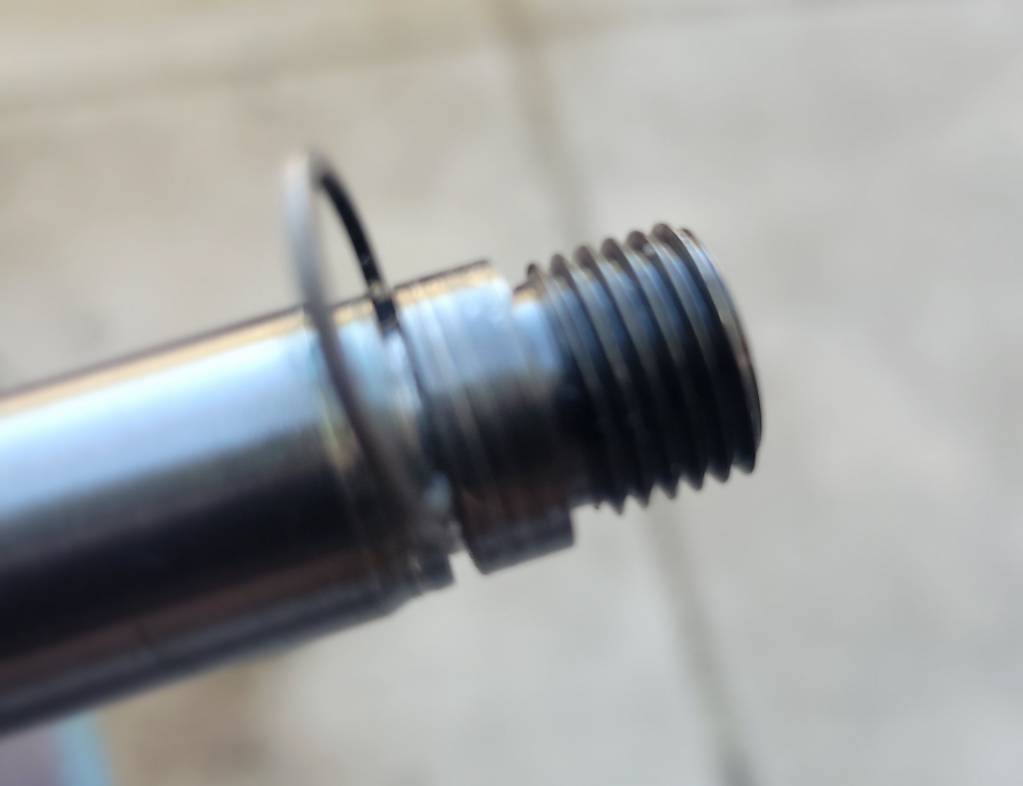

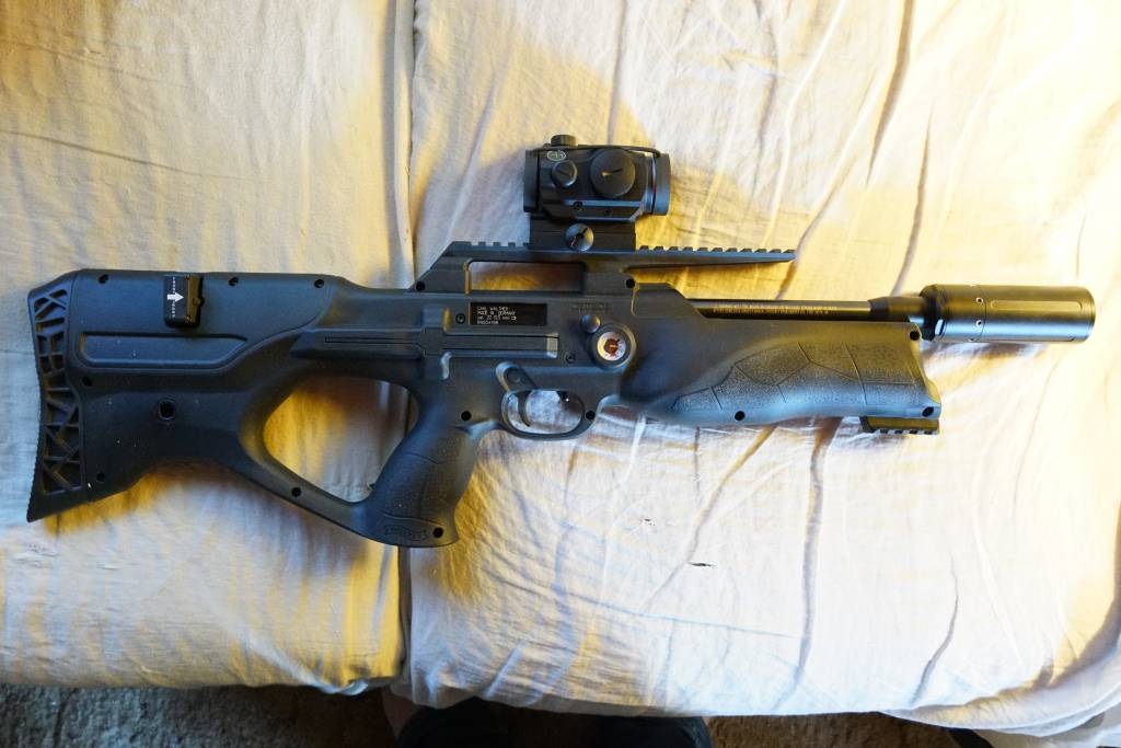

Submitted for viewers wanting to know what the U.S. Walther Reign moderator looks like unassembled without cutting or grinding.. I read a few removal threads that entailed labor intensive procedures that I almost was going to give up. Fortunately I didn't and with the Donnie FL Sumo the gun is substaintially quieter. .The factory thread in the picture is 1/2 UNC.

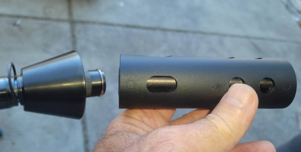

1. Start heating the moderator on the muzzle weight plastic juncture with the heat gun. . It is important to be patient with this step ! It will take a while for that heat gun to get that plastic soft enough to pull it off the knurled nipple that yoiu see in the download pic. Keep the heat gun close and moving cumferentially around the juncture . If it starts to appear to smoke you've got it too hot -back off. You can tell when you're getting somewhere when you twist the plastic portion ( be sure to have your insulated mitt on while doing this ) clockwise or counter clockwise it will start to rotate on the nipple at this point apply pressure forward ( pull plastic portion forward ) and wiggle in a circumferential motion you will see the plastic start to pull away from the muzzle weight.and they will start to separate. Apply more heat as needed it will eventually pop from the nipple. There was no need to try to pry them apart with a screwdriver. .
2. Now that the front portion of the moderator is off there will be a nipple forward of the muzzle weight. Take your channel locks or locking pliers grab the nipple and make sure you have a secure bite on it . (I wasn't concerned about saving the moderator but I was able to pop everything back together when I was done so I did not destroy it ). The muzzle weight was still extremely hot when I began this next step.
3 .Grabbing the channel locks with a firm quick 1/8 to 1/4 turn motion turn the muzzle weight clockwise then counter clockwise repetitively you will feel the clip start to compress do not apply more than 20 ft pounds at any point if it feels as though you're applying too much pressure keep rotating clockwise counter clockwise rapidly back-and-forth until you feel the clip get caught and compressed you will feel it ease up significantly as you notice more distance gained when turning right and left with your channel locks then it's just a simple matter of unscrewing the weight off.
3. Remove the clip in the barrel groove and you're good to go.. I found a nylon half inch I.D. sleeve that I was able to fit and place behind the DFL Sumo to hide the groove. I did this simply for cosmetics.
I hope that this helps someone attempting to remove the factory muzzle device. I'm very happy with my decision not to have been Influenced by the procedures done on other forums in attempting to remove the muzzle brake . Gun is truly awesome now.
Facts----- The Factory brake is not glued on it is retained by 1/2 UNC threads with a circlip snap lock . You do not have to cut or grind off the muzzle brake in order to remove it . Most importantly you don't have to cut the barrel !

I contacted DonnyFL and they told me it was the 1/2-20 UNF. They recommended the Koi with the cone adapter.
hope this helps.
