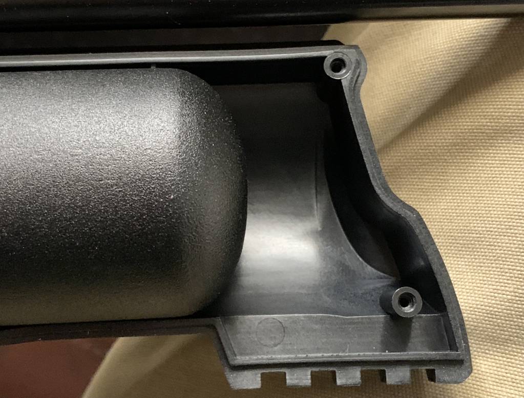

Maybe someone can comment on the possibility of fitting an aftermarket regulator in the space occupied by the factory German regulator without severely restricting the power.
It looks like there is a little room for the tank to move to accommodate a regulator. I have no idea if that is enough room to fit one inline. The full tank for reference:
Hi AUGrad, thanks for the photographes. I like your idea and ask myself, if a HUMA inline regulator may fit in between the bottle and the valve block? - www.huma-air.com/400-500-CC-Bottle-Regulator -. Does anybody knows what kind of thread is used by Walther to screw the bottle into the valve block. Maybe the empty space on the righthand side of the bottle is big enough to compensate for the additional regulator. The inline regulator requires 58 mm / 0,228 inch. In such a case it would be necessary to modify the stock to create the openings for the additional second gage and new Foster fill port. I think I have to open up my gun again.

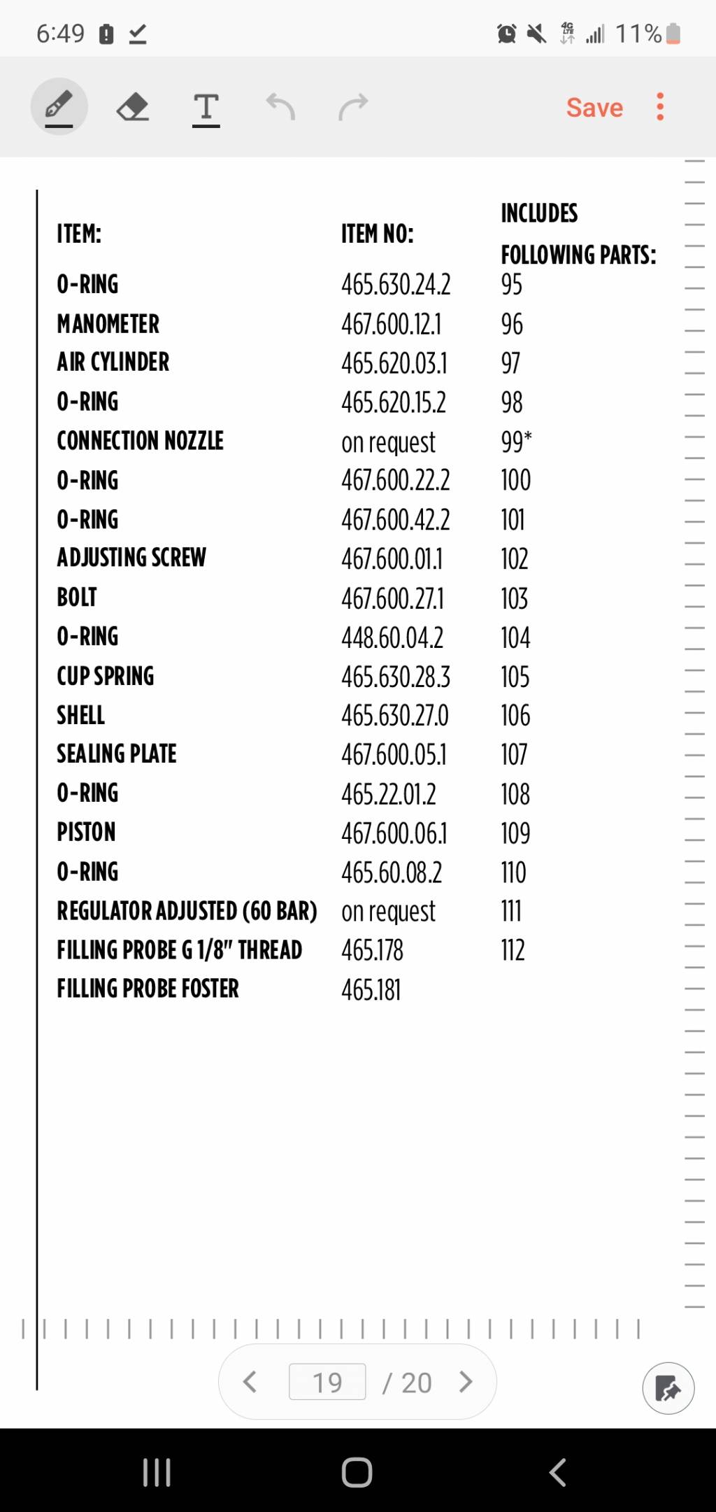

The question is who makes the regulator for the 60 joule version and how does one order it separately here in the states. Also, does the hammer spring require modification to work with that regulator? I am less interested in increasing the power of the Reign and am looking to flatten the shot curve.
