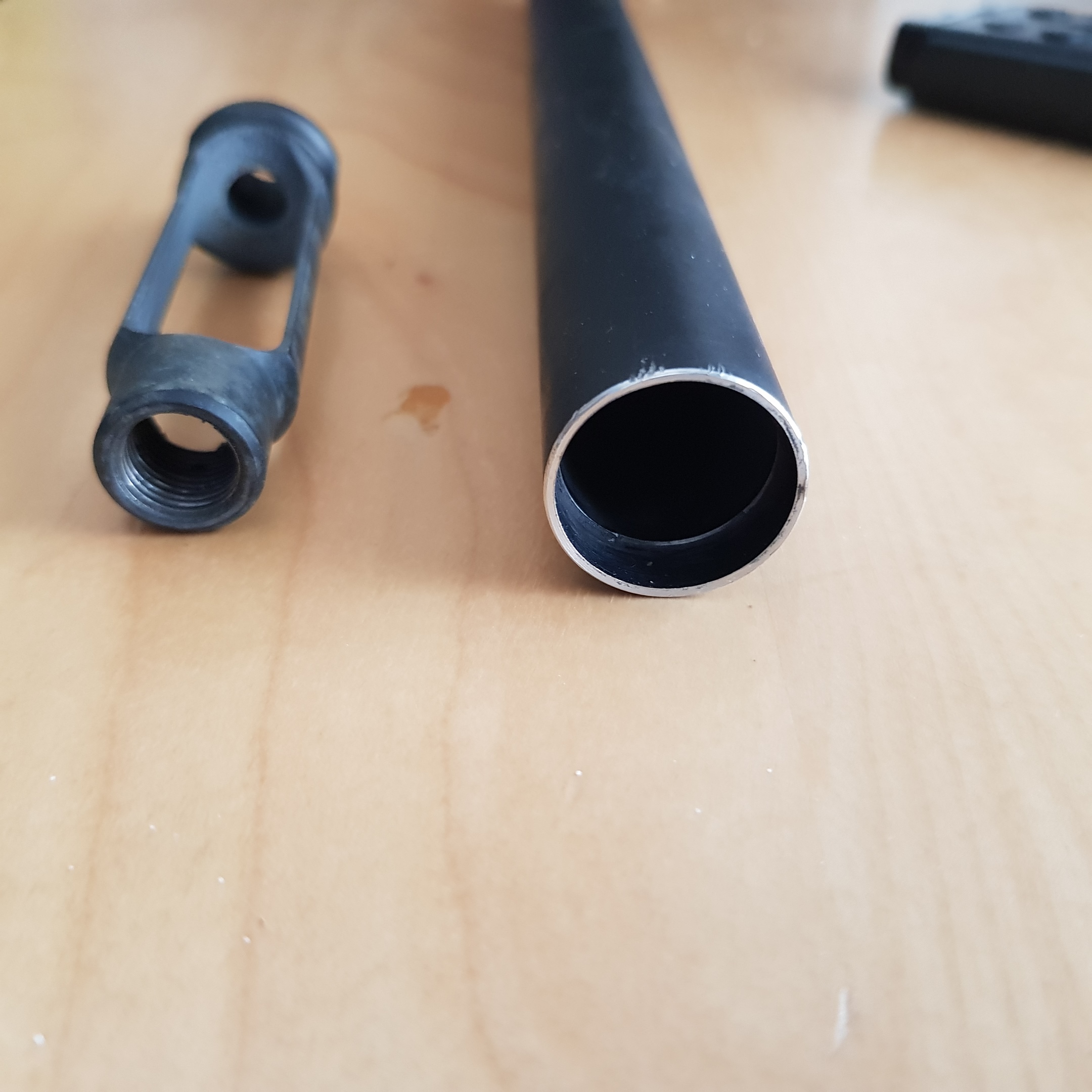

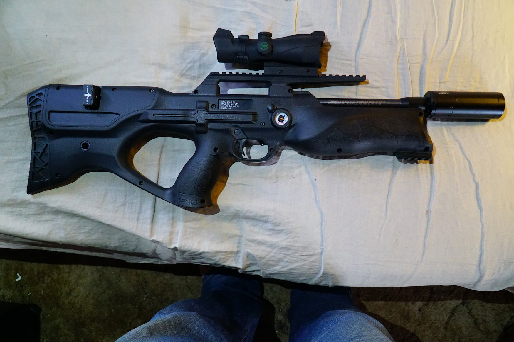

No...threads on the barrel of my Reign. The factory mitigator was swaged in place. Long process of carefully trying to remove it, only to find it was a waste of time. A couple inches shorter, and all is good.
I cut the end off of the barrel, to a shorter length, added a Donny adapter (1/2"-20), and can use most any muffler on the market.

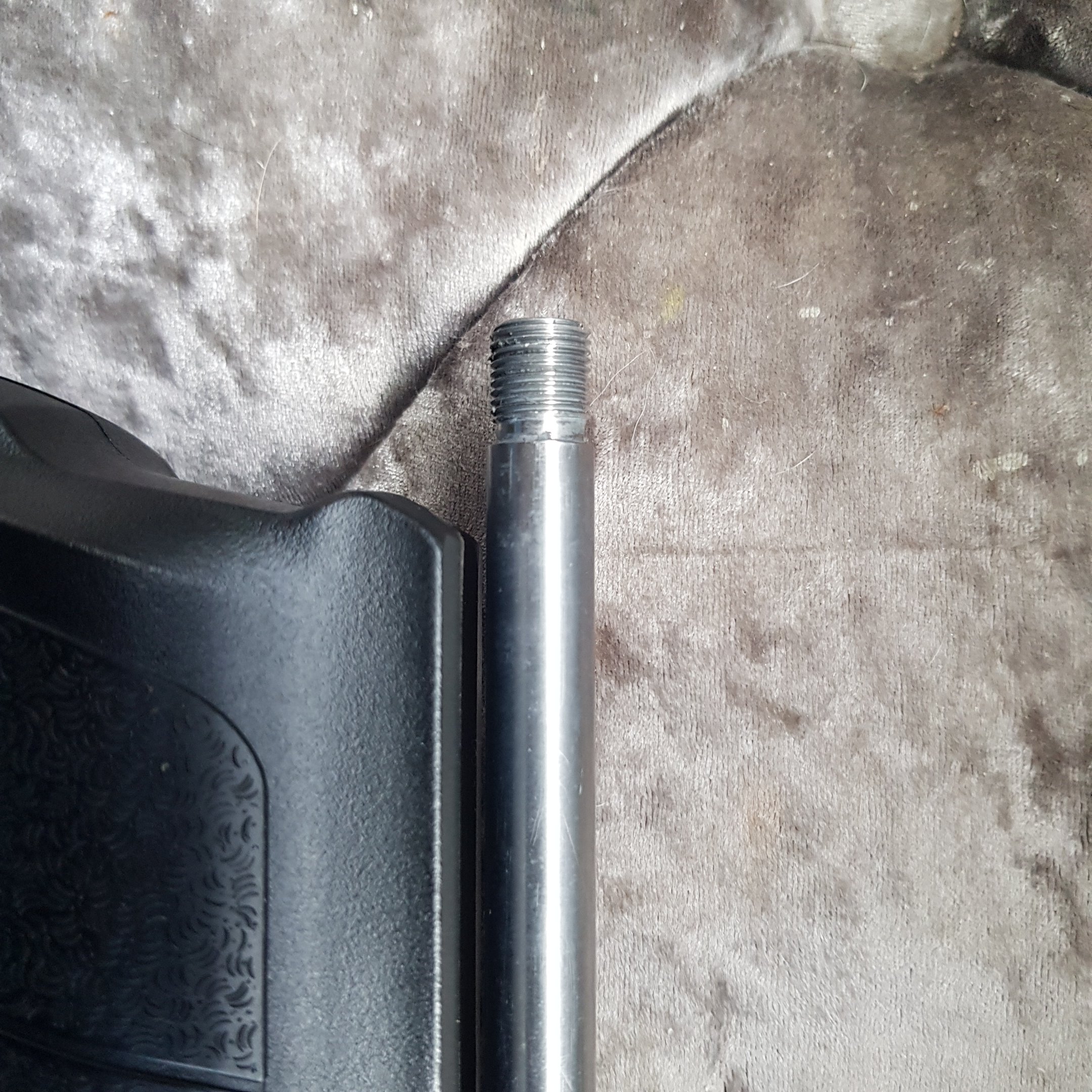

Mine had threads and they were 1/2-20. Here is a thread that I started that shows my modification. The factory moderator was held on with a C clip that was in a groove on the barrel. Once you break/cut that my factory moderator threaded off. The MK1 does not have a shroud. The new MK2 is the model with the shroud but is not sold in the USA.

Hi Mike, what barrel mm adapter did you order from Donnyfl? I want to do this to mine as well. Thanks!
