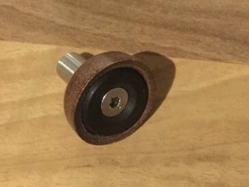

Just my humble non-solicited opinion as a non-expert on the LP53. I installed a Robb piston seal on my non-modified LP53. I thought it made the recoil action harsher than the original leather seal. No real difference in fps. I'm going to try fabricating a new leather seal to see if there is an improvement. I would be interested in hearing if your experience with the Robb seal is different.
I actually prefer my own leather seals. It just takes a bit of patience to get there. I will come onto them in a moment.
As regard the Robb seal, you cannot just put it in the gun. He deliberately makes all his seal up on size, so they can be trimmed to fit. In this way he avoids none sealing returns….
The little nose piece made from steel, can be held in a drill chuck and the PTFE seal polished down with wet and dry to 23.1mm dia to get a sliding fit. PTFE must have a smear of Silicone oil to allow sealing. He tells you this in his sales literature and provides the lube.
The PTFE seal does slam until it finally achieves a proper sealing fit, when both the slam goes down and velocity goes up but takes a good 100 rounds.
Its not ideal however…
The key with the 53 is using a leather seal but keeping it slim, giving you more stroke/volume by placing the buffer spacer within the leather, not ahead of it as it was OEM …like shown.
