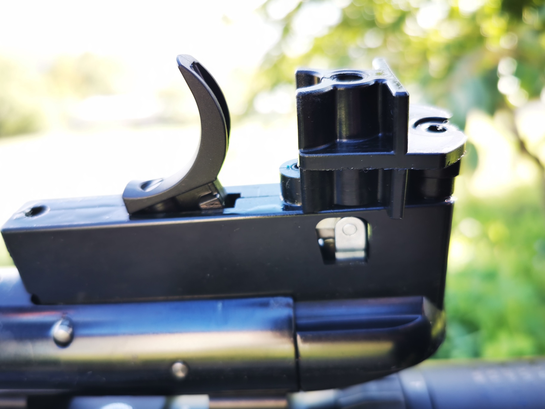

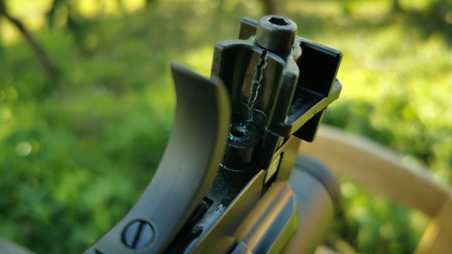

Good morning, unfortunately my Walther Lgu has a crack on the support that is on the trigger box, a plastic rise where the rear screw is screwed to the trigger that holds the stock. Has anyone already happened? how can i solve? I put you the photos of what happened. Thanks a lot to everyone.
if that is abs plastic it can be fix by methylene chloride.
"hello, but does methylene chloride exist only in liquid form? How does it harden? A thousand thanks."
It doesn't harden, it melts the parts that it touches and from there it welds the melted expose parts as it dries quickly, it becomes like a a new parts, I have a lot success in using it, I have tried using it on broken car trims and other toys and plastics as long as it is ABS, and was surprise about how good it weld parts back together, its like brand new, the trick is to get a dispenser for it as it is more viscose than water, you put the broken parts align it together and put a drop of it on the seams as it will penetrates and melt the expose parts and then hold it together till it dries partially, leave it for couple of hours on the side till it totally dries up and check how it dries.

Looked like i found the stock and trigger assembly but that thing of yours is not showen or listed on the parts listings/ diagram. Then most were out of stock anyway , Go figure.. thats how it works with stuff i own..
yes in fact that piece is not mentioned in the Walther exploded view ... a big problem! these days I try to repair it with two-component glue.
