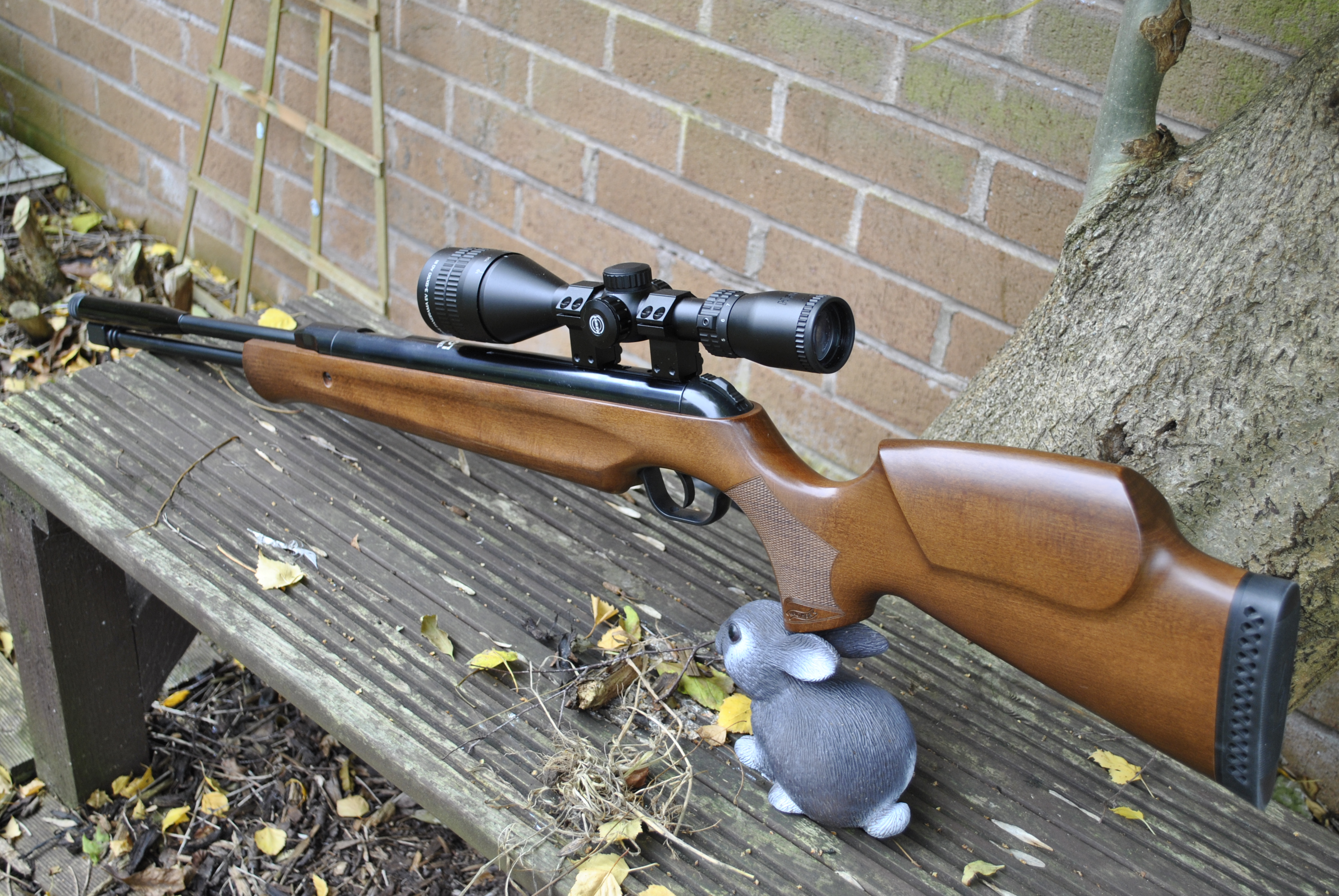

This is not intended to be full blown review but more of an initial impression of Walthers new underlever called the LGU.
The rifle is only available in .177 at present, a refreshing change to see the smaller calibre available first.
The first thing to impress me was the packing, a sturdy card board box with double tucks & lids which opened out to reveal the rifle snuggly nestled in & supported by a purpose integral lining, well done Walther! The rifle inside is protected by a polythene sleeve, inside which, is a bag of silica to protect from moisture. There’s an Allen wrench in a separate plastic bag that is stapled to the box & a handbook. The handbook immediately gives the impression of quality as opposed to a lose piece of paper or a company leaflet detailing various products. So I’ve already got the impression Umarex/Walther have upped the anti! IMAGE
Upon removing the rifle from the packing it’s quite obvious on my example it hadn’t been polished prior to boxing as it was full of streaks & appeared rather dull. The second thing to come to mind was the statement Terry made yesterday in reply to one of my threads where he said he first read about the LGU at it’s conception, or something similar. My immediate reaction was why didn’t Terry see the HW97 & TX200? They must have been hidden under the table then!
Okay, it does strike you quite unashamedly this new LGU is very reminiscent of both the HW & AA offerings & I have to be honest I like the looks better than the other two. I always thought the LGV looked rather long & unwieldy, I have no idea if the LGU is shorter or not but it is more compact looking to me at 1064mm o/l.
The blueing is quite deep, in fact I have one of the first Webly Tomahawks to come out of Birmingham & serviced a Brummie Longbow yesterday, we all know how good the blueing is on those, well let me tell you the LGU would not be put to shame, Umarex, I’m impressed! IMAGE The streaks are easily removed with a duster.
Putting the rifle to the shoulder it feels quite well balanced, the length of pull must be shorter than a 97/77 as I can reach the trigger quite easily but my middle finger knuckle is inclined to touch the rear of the trigger guard. I have small hands so people with hands like a pound of wet sausage may find the fit between the guard & pistol grip too close, it’s not likely to bruise you upon firing though like a shotgun would but it’s worth mentioning I thought. IMAGE
The vented rubber recoil pad feels nice, I’ve not scoped the rifle up obviously but the cheek piece does have a nice feel to it, if it’s high enough or too high I have yet to determine.
One part I do find unattractive is the two rubber “O” rings at the end of the cocking lever, it’s obvious why they are there & do do the job but also detract from the overall appearance of what really is to me quite a nice looking bit of kit. IMAGE
No stippling, checkering or any other sort of anti-slip on the fore-end for the supporting hand although there are scallops which I much prefer. There is a panel of checkering on the pistol grip outlined with a single line with the Walther logo underneath. IMAGE.
The muzzle end plug can be removed & replaced with an adapter, sold as an optional extra ( RRP £9.95), for fitting of a ½” x 20 (1/2”UNF) silencer, Nice touch, I declined but for the hunters it’s there if you want it & won’t break the bank. IMAGE

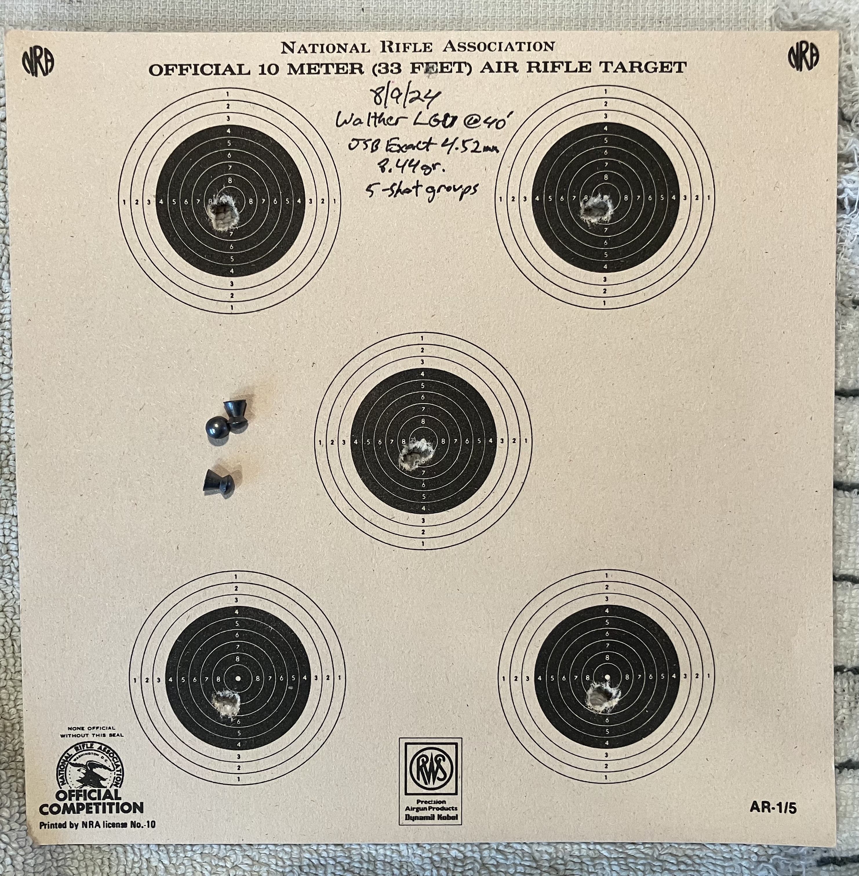

My LGU Master Pro is a stock UK version putting out ~10.5 ft lbs, and it's more accurate than virtually all of my other air rifles, including a Pro-Sport and sundry HWs & FWBs. The only air rifle that equals it in accuracy is my John Thomas-tuned 12 ft lb HW97K. Both put pellet on pellet at my admittedly limited backyard shooting range of 40' even though the LGU has a trigger pull around 2 lbs heavier than the 12 oz pull of the 97K. The LGU taught me that the weight of a trigger pull is not as important as having a predictable release w/out creep.
I used to own a TX200 (also not as accurate as the LGU), and one thing I noticed was, when I cocked the TX, which has an anti-bear trap ratchet mechanism the LGU copied, the clicks it made were a relatively loud clack-clack-clack, while the LGU made a much quieter and precision-sounding tick-tick-tick that gave it the feel of a superior engineered mechanism. If you own both a TX and LGU, try them out side-by-side and you'll see what I mean. :)
Twenty-five consecutive shots over five targets, 5 shots each:
At this point I do not view my LGU to be anymore accurate than my TX. Pretty hard to beat .317 and .250 five shot 50 yard groups, I do expect the LGU to do similar and will find out. I agree the LGU is a bit more refined with a smoother shot cycle and a more solid feel. More accurate, no but as good I think. TX has a better trigger and is what I would pick as the 1 weakness of the LGU. A nice target but they all shoot good at 40 ft.Stretch the fine springer out it can handle it. Oops, forgot another plus for the LGU is it has held absolute point of aim. As for as shooting a match, I have no hesitation with the TX, it is at this point still my go to springer.
