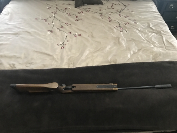

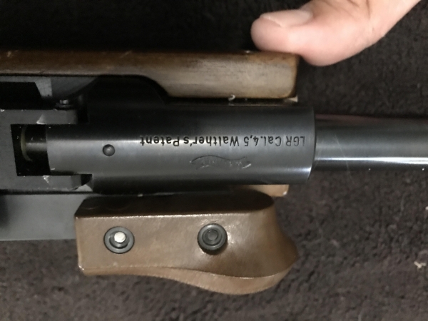

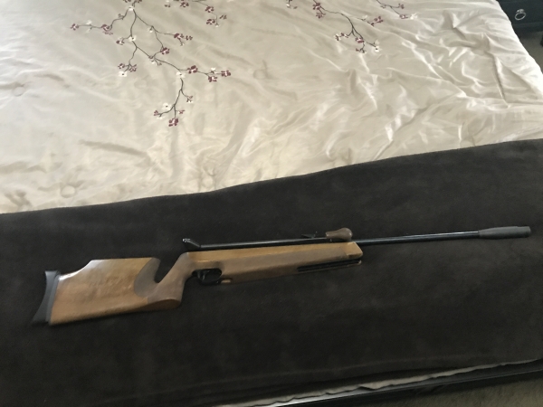

I won this old Walther at a benchrest match last weekend. Going to give her lots of love to get her back to her glory. Mr Rhea will be redoing the wood, waiting to hear back from Pilkington about a total overhaul on the metal.
its still shoots, but very weak, theyre right about zero recoil, NONE!
